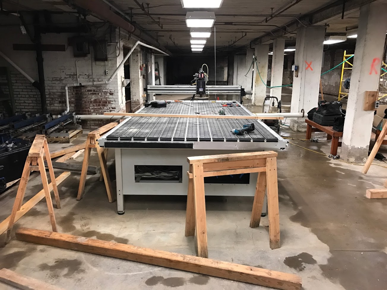

So I had to move the CNC and my shop into a basement to get closer to 3 phase power for the CNC's Spingle/Vacuum.
Took some time, but I got it installed and back to where I was before the move. Cool thing is that I have internet access, so I can hopefully respond faster!

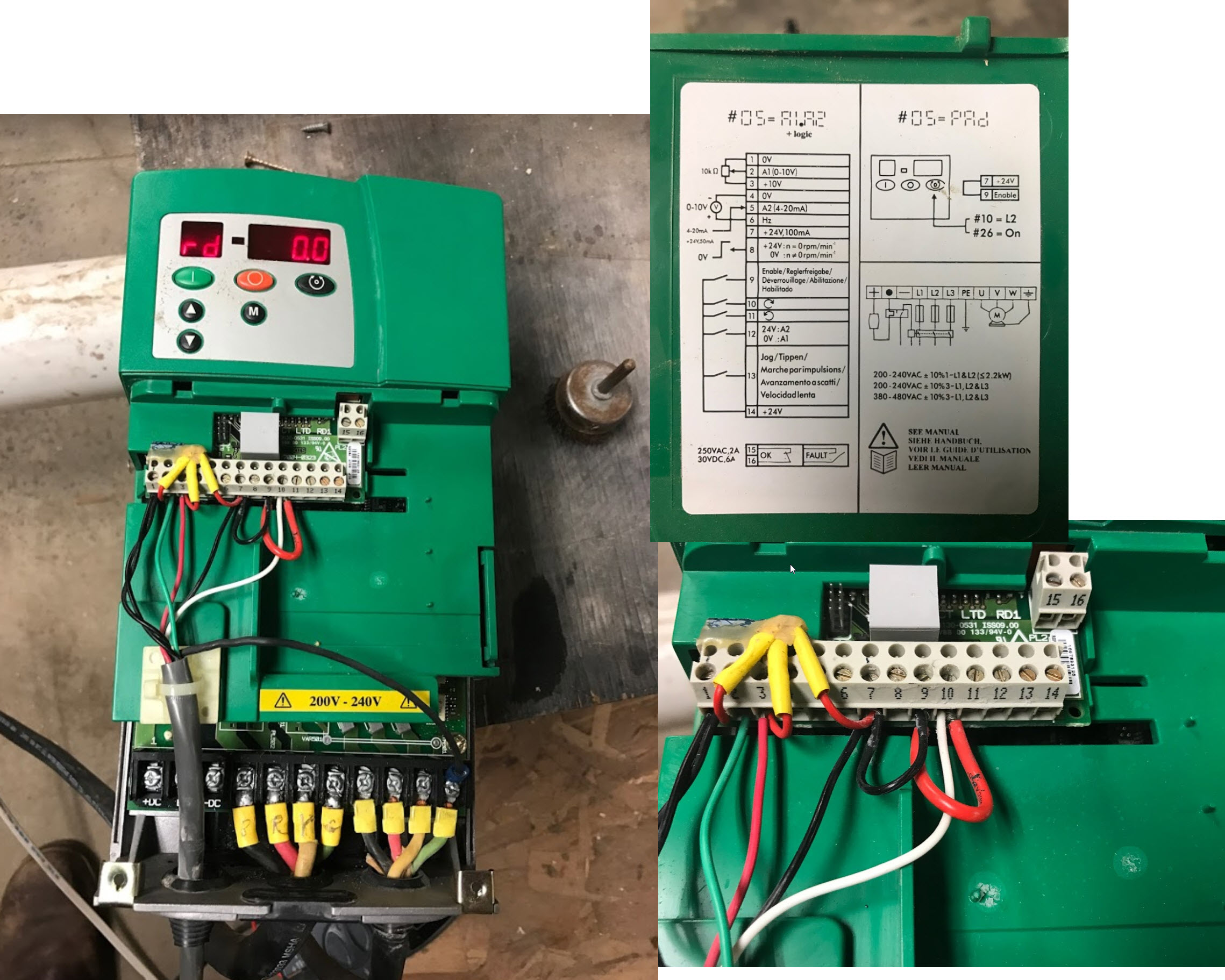

Spindle Problems:
I was able to purchase the last few things I needed to power up the VFD/SPINDLE.
I got 3 phase running from circuit breaker to fused disconnect and then to VFD and lastly spindle.
I powered up the VFD, not connected to MESA, just for a 'bench' testing. The VFD powered up and looked functional. I tried to get the spindle to move via the control buttons on the VFD, acted like it was locked. I figured it's locked for only input via the control wiring and or needs the enable pin. So I powered it down, and started mapping the wires, currently there are 5 wires from VFD to my controller. After mapping, I fired up the VFD and wanted to check voltage to make sure I had 10V (11.9v) on one wire and 24V (22.7v) on one wire. I got the voltages and went to turn it off and noticed it had an error. "Internal Serial Communications Error" So I thought, maybe my voltage probing screwed something up... So I powered it down, then waiting for 30 seconds... powered it back up and thought it was going to be ok, but it acted like it was not getting a good connection of power and flickered a few times, you could hear a relay clicking and then display went off. Powered it back off and checked all power connections, which were very good. Took cover off and checked components for any signs over overheat conditions. Never had any smoke of any sort. Tried to find some answers online, no luck. Then before I left for the night, I powered it back up. Seemed to power up fine, just like the first time. Anyone ever experienced that? Of course, it's not a LinuxCNC/Mesa problem since it wasn't even connected, just hoped someone might have similar experience with a VFD.
I might have to purchase a new one, if so does anyone have any suggestions for inexpensive VFD to power a 5.5hp spindle (assuming the spindle works)
I'd like to sort out how to connect the VFD to the MESA's spindle ENA5 PWM output.
The VFD has several in/out pins, however there are currently only 5 running to the controller.
1 -> 0V
2 -> A1 (0-10V) input
3 -> +10V output
7 -> 24V, 100ma output currently
- [Jumpered to 9 -> Enable]
- [Jumpered to 10-> Enable forward] (see pic)
10 -> Enable Forward
from MESA 7i77 Manual
21 ENA5- FROM 7I77
22 ENA5+ FROM 7I77
23 GND FROM 7I77
24 AOUT5 FROM 7I77
Note that the enable outputs are polarized and can be
damaged with reverse polarity. For active high drive enables, ENAN+ should go to the
appropriate positive power supply and ENAN- to the drive enable input. For active low
enable drives, ENAN+ should go the the drive enable and ENAN- to control power ground.
If I had to guess I should remove the jumper from 7 to 9 on VFD so it's not always enabled?
Then connect:
pin 7 (VFD 24V out) to Mesa 22 ENA5+
pin 9 jumpered to pin 10 (VFD Enable and Forward) to Mesa 21 ENA5-
That should enable the VFD and enable "Forward"
Then Connect:
pin 1 (VFD 0V) to Mesa 23 GND
pin 2 (VFD 0-10V input) to Mesa 24 AOUT5
Of course, I am hoping to get some input from the experts before I actually give it a go and see if my VFD behaves better.
  • tommylight
  • tommylight's Avatar
  • Away
  • Moderator
  • Moderator
13 Aug 2019 15:59 #142039 by tommylight
Replied by tommylight on topic Retrofit of Precix 5x10 CNC
Yes, yes and yes.
That is as far as i can tell from that picture, and if you do not need reverse.

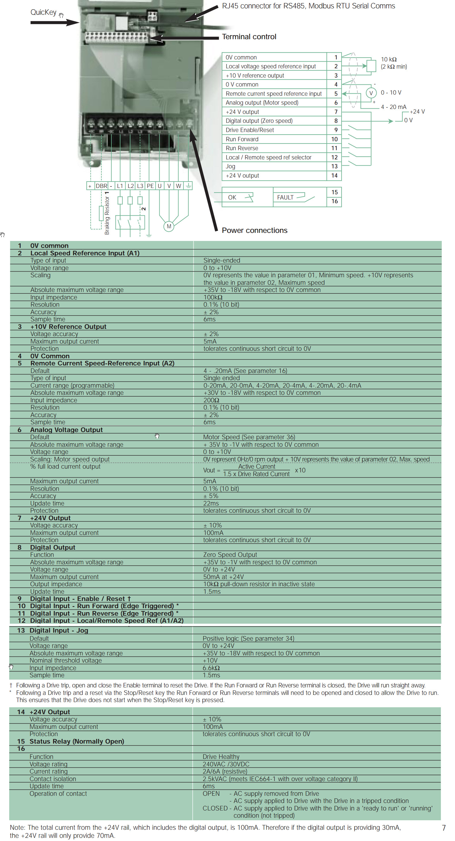

Here is some screenshots from the manual. I am not sure why they didn't want reverse as an option, I can try to sort that out a different day. Having a working spindle (forward only) would be awesome at the moment.
So the Mesa card, outputs it's own 10V PWM signal rather than using the reference output from the VFD.
Last edit: 13 Aug 2019 17:00 by randypetersen.
