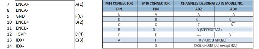

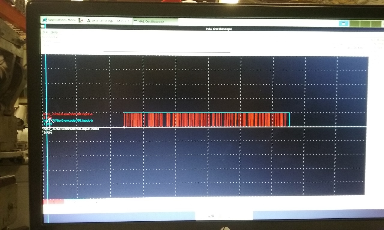

1800 counts per turn should be fine, the 7I76e encoder counter can count faster than any standard encoder
(up to ~25 MHz). It may be that the encoder would need lower value pull-up resistors than the 7I76e's built in 2K resistors
if the count rate is very high but I don't think that would be the case with a lathe spindle.

thats great thanx. Its only for threading I guess so it wont be trying to read it at high rpms anyway. For the home switches the emco has 2 24vdc hall sensors. I assume I just power them and then put the hall sensor output as an input? When I set up the linuxcnc I think I put in for home switches, what would the entry in the HAL file look like and what pins would it assign? Or would I need to chose the pins to assign?

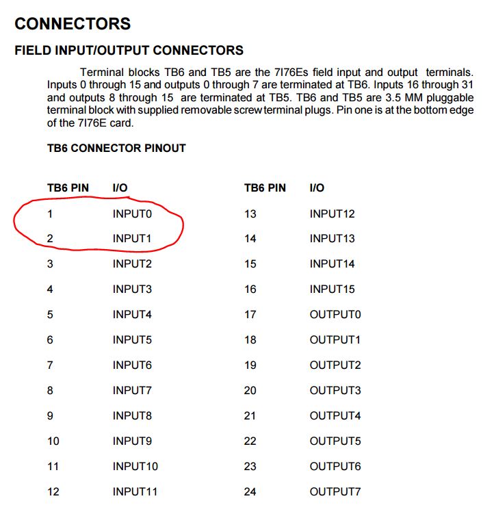

here are the lines added by the setup tool. This will be OK for a start if I can figure out the physical pin from the HAL pin. But what I would like to do is set up an output to power the hall sensor when the home search begins, an input to read the result (should be below I think), then turn off the hall sensor the rest of the time.
# --- HOME-X ---
net home-x <= hm2_7i76e.0.7i76.0.0.input-00
# --- HOME-Z ---
net home-z <= hm2_7i76e.0.7i76.0.0.input-01
---setup home / limit switch signals---
net home-x => axis.0.home-sw-in
net x-neg-limit => axis.0.neg-lim-sw-in
net x-pos-limit => axis.0.pos-lim-sw-in
net home-z => axis.2.home-sw-in
net z-neg-limit => axis.2.neg-lim-sw-in
net z-pos-limit => axis.2.pos-lim-sw-in

15 Aug 2016 09:19 #78801
Replied by PCW on topic Emcoturn 120 lathe retrofit
Yes, hm2_7i76e.0.7i76.0.0.input-00 is the hal pin that corresponds to TB6 pin 1
