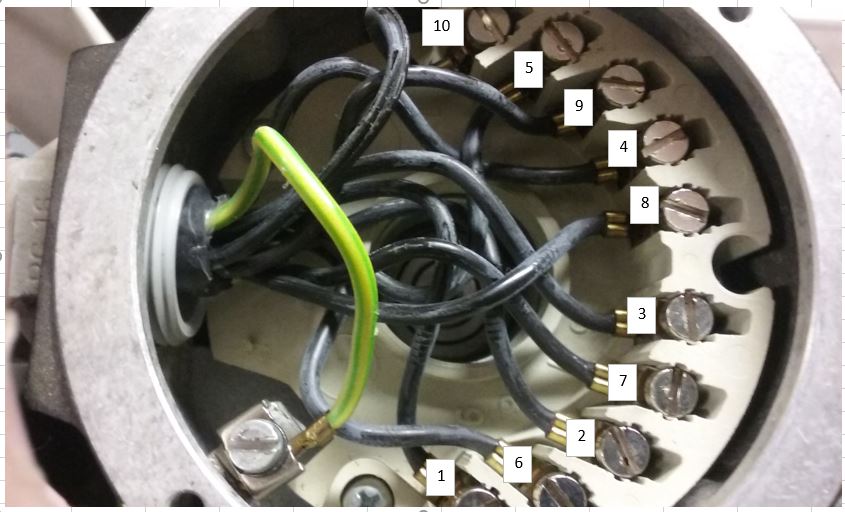

awesome thanx. At this point Im guessing I have 3 things wrong. the wires, the stepper settings in the software and Im unsure how to actually move the axis in linuxcnc GUI

I believe I ended up using advice from this thread rather than the Emco wiki to get my steppers working: forum.orientalmotor.com/viewtopic.php?t=609
Ultimately the thing that worked for me was advice from user Bluecoast in that thread. Here are snapshots of my notes:
bgp.nu/~tom/pub/IMG_3890.JPG
bgp.nu/~tom/pub/IMG_3888.JPG
If you look at the bottom of the third column in the notes you see the wiring numbers (in circle) looking down on the top of the stepper motor. The wires you use (I replaced the stock wires) will determine the color code, but you can see that numbers 1,8 (which are blue/red-blk for me) connect to the Vexta drive terminal labeled "Blue". Wires 2,5 (wht/org for me) connect to Vexta terminal "Red", and so on.

thanx, I saw that thread and tried a couple of the configurations. I will now have to double check because the wire harness I have is full of black wires that are numbered, my assumption was they are numbered to the motor, but maybe those are Enco numbers, so I will have to remove the cabinet to check if they are corresponding to the stepper numbers. I started with the z, and its now inside the cover, so Im going to check the Y and then wire that one, if the wire number match there I would think they would also match on the z. Will try this weekend.

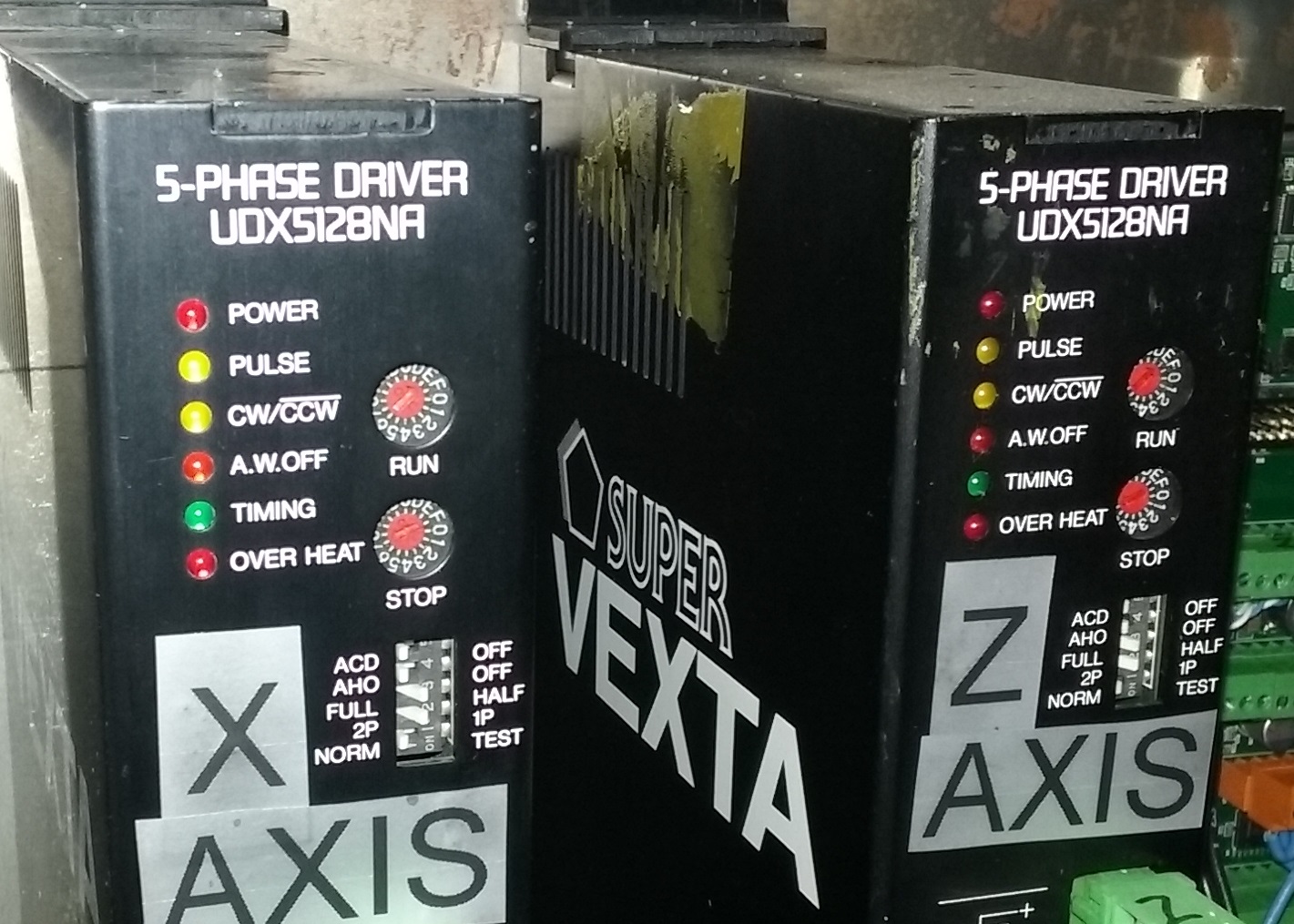

If its OK, could you snapshot your HAL and INI file stepper sections for reference? I see the picture shows I have some of the switches on the control wrong as well. so with these three pieces of info I can make a good try this weekend.

in wire harness for the stepper, the numbered wires do not match the stepper terminal numbers, the picture attached is the way the Emco harness is wired. I rewired the stepper so that the harness wire number matches the stepper terminal number. 1-1,2-2,3-3,4-4,5-5,6-6,7-7,8-8,9-9,0-10. figured that was it but no go. Still just vibrates and doesnt move. I changed the option switches and found I only have 5 where you have 6 switches, but I matched the ones that are there. still no go. I looked at the ini files and it looks like you have more lines for the stepper config and the values are different. I knew mine were wrong so this is expected, I will try to merge the ini files some tonight and give it another shot.

I notice you have wires on the timing, o.heat/com terminals? where do those connect?
