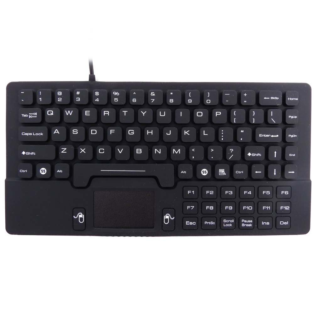

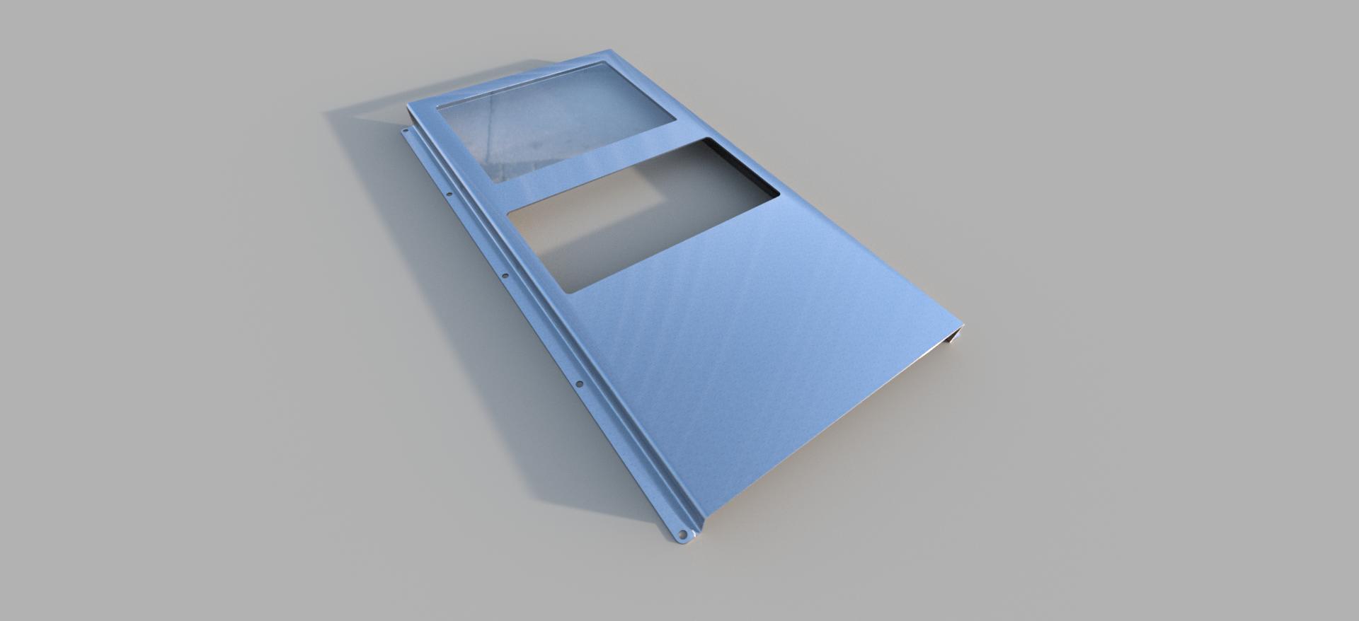

23 Jun 2020 03:45 #172415
by ihavenofish
little laser cut and bent stainless panel
petg monitor cover "glass" will be machined on the mill itself.
monitor is the apple retina display with displayport card ($179 at adafruit)
second cutout is for this waterproof keyboard ($79)
below that we will arrange switches, buttons, leds, mpg wheel.
the inside will be 3d printed abs to hold everything in place.
We'll see what the laser cutting runs. My supplier is $125cdn min and usually you get a fair bit for that, so I should get 2, maybe 3 or 4 panels. I only need 2, so if they do end up giving me more than 2, ill offer them up to anyone here if they want.

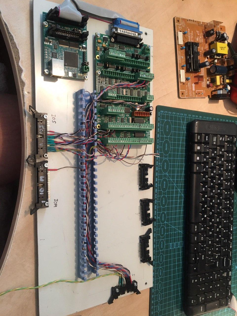

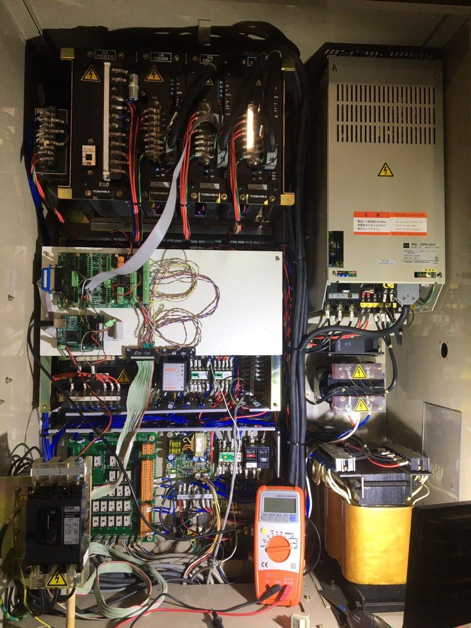

Hi Ihavenofish!
actually I have Brother TC-215 with original Toshiba servo drives...and I manage to retrofit it ONLY with pin-to-pin replacement NC-Board with Mesa 7i92 and 7i77. It's work incredibly precice (I think due internal resolver) (precise is about 0.002mm)
first chips
So if your drives and motors initially work fine, I hope You can do the same
and save cost and time.
Ready to share all info with all comunity.
first chips

23 Jun 2020 10:22 #172457
by ihavenofish
Replied by ihavenofish on topic Brother TC-225 / TC-229 adventure!
If you go earlier in this thread, youll find that the original sanyo motors could not be tuned. perhaps the Toshibas behave much better.
On my TC229, the drives are proprietary serial, (and mine were dead anyway), so there was no using those.
