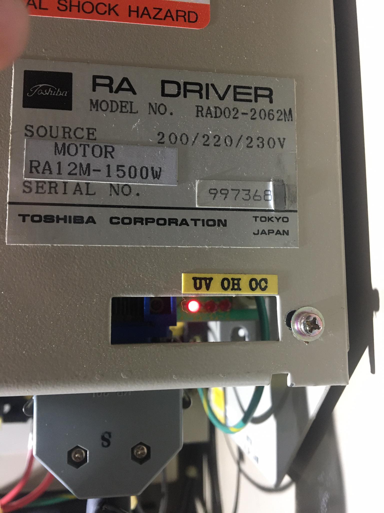

Need some help.
congif: Brother tc-215. mesa 7i92+7i77. servopack details on picture
My spindle servopack start pereodicaly goes to UV error. Initially for 6 month wokr perfect!
Encoder work fine always
But when I try to statrt spindle (in any direction) UV led start blinking.
Reset button stop blinking...but some times drive start.....some times againg goes to this error:(
I have some guess:
1. due to temperature ,,,now about 28
2. due to valtage .... at this moment I got 400v instead 380 ( 216v on servopack instead of 200)
3...????
Do you know what mean "UV led flashes" ?
Thanks!

20 Jul 2020 10:29 #175234
Replied by tommylight on topic Brother TC-225 / TC-229 adventure!
UV = Under Voltage
OH = Over Heated
OC = Over Current
First check the cable to the machine, is it thick enough to power the machine. Thin wires will cause a lot of voltage drop, especially at the start of the motor. And please do not use cheap extension cable to power any machine.
Then check if you can make the "spin up time" longer on the VFD, that will make the current draw raise slowly.
OH = Over Heated
OC = Over Current

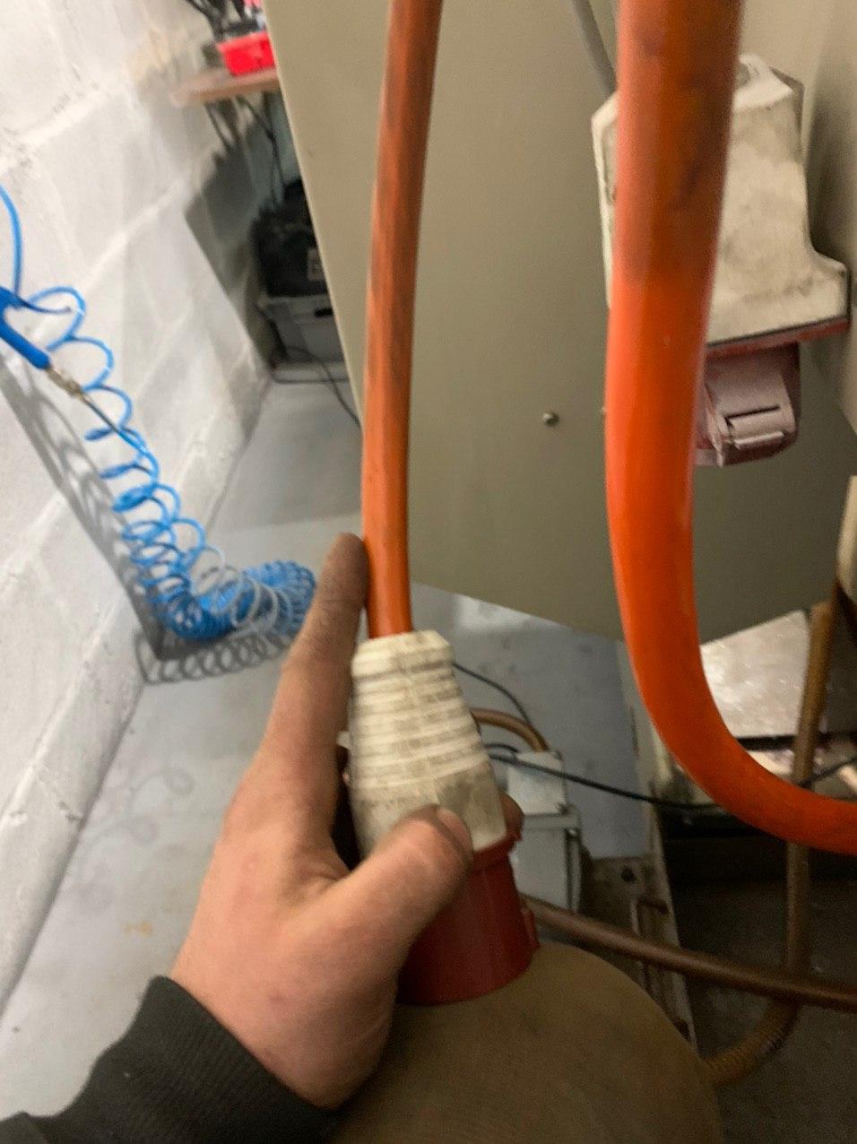

Thanks for reply!
Forget to say that this error come just immidiatly after control voltage from mesa (about+0.5v) come to +-10v input line....motor don't even try to rotate....
Surely it's not a cheap cable
cable is 4х6mm^2
Is it possible to get UV error due to HIGH voltage?
I got 402v instead 380 ? (216 v on the drive instead 200v)
Is it possidle to get this error due to 3 phase (L1 L2 L3) wrong siquence? ( not sure if this correct)
Last edit: 21 Jul 2020 06:53 by IceBear.
- Posts: 22006
- Thank you received: 7489
21 Jul 2020 07:59 #175309
380V +-10% = 342 to 418V should be ok for Europe, so 402V is fine.
VFD's usually do not care about phase sequence as that AC voltage is rectified at the very start, most of them will work with just 2 phases, but will put more load on the rectifier.
See if you can find a users manual for the VFD and check the setting.

21 Jul 2020 21:16 #175360
by ihavenofish
Replied by ihavenofish on topic Brother TC-225 / TC-229 adventure!
the drives can be fussy about sequencing startup. drive control voltage, drive power voltage, control signals. if you get that wrong, even by 10ms, it might be complaining about undervoltage. as in, it checked for power voltage, and couldn't find any cause it wasnt "on" yet".
But you said it had been working before, so that throws this off a bit, unless you made some sort of change, or it was on a knife edge and just by fluke never complained before.

25 Jul 2020 07:57 #175718
by IceBear
Replied by IceBear on topic Brother TC-225 / TC-229 adventure!
Appriciate for information!
It give me some "apparent" feeleing that I understand haw in works
Due to some magic (I believe due to temp. goes down for 3 deg.) this problem gone
But I install permanent tem and voltage monitor and ready.
Let You know if got any usfull info.
Thanks for Your support!
