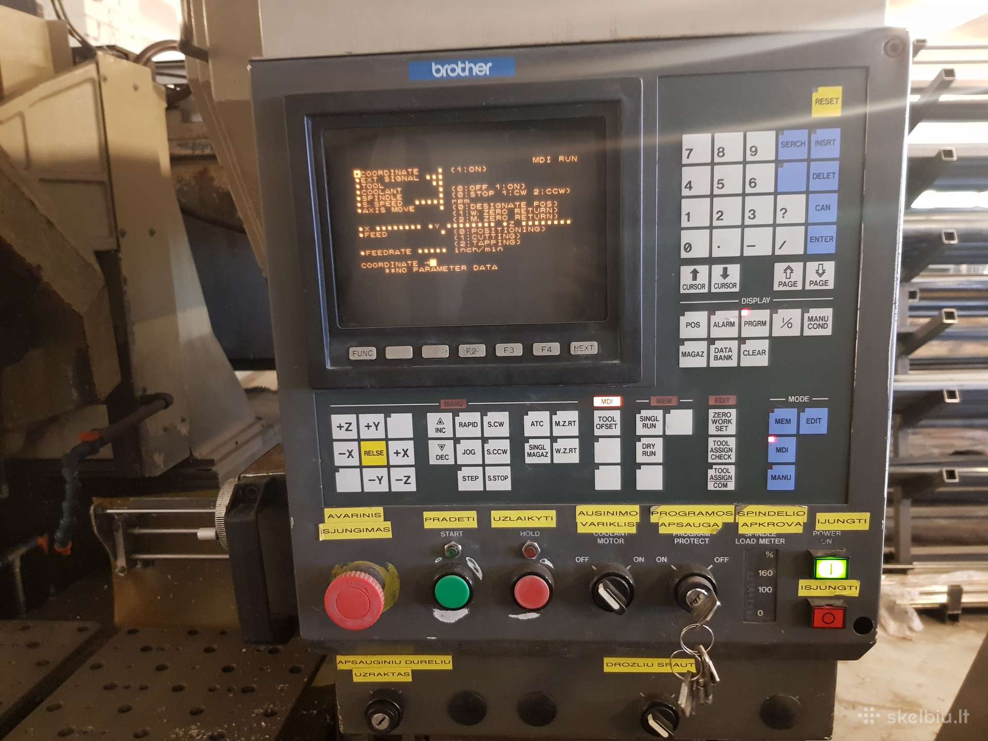

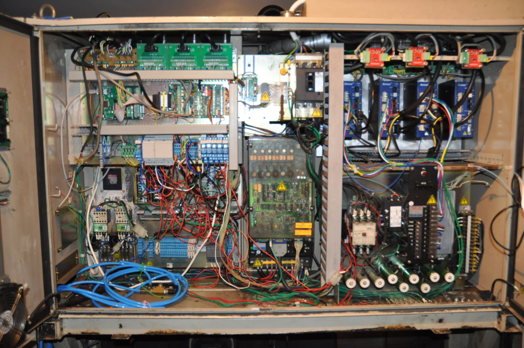

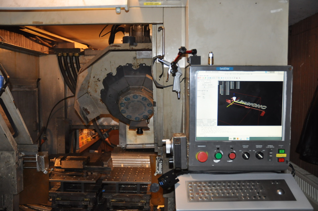

So, my personal responce to quarantine, almost finished Brother TC-321 conversion.
Here you can see how works spindle orient and tool change:
Link to config: bitbucket.org/ricardas-lt/brother-tc-321-linuxcnc/downloads/
Config optimized for 2.8 ver. so will not work on the previous versions.
Details:
Mesa 7i96 + 7i77
Axis - servo motors original Sanyo Denki, drives Copley Xenus xsl-230-40
Spindle motor and drive - original Sanyo Denki.
Big Thanks to laserK, ihavenofish, HalaszAttila and others.
My config is based on laserK config:
github.com/laserK3000/tc215RetrofitlaserK3000]laserK3000
Some photos how it look before conversion and now.

22 Jun 2020 19:14 #172378
by IceBear
Replied by IceBear on topic Brother TC-225 / TC-229 adventure!
HI!
Actually I solve this task (safe atc space) pretty simple. Idea is limit Z travel after < home Z> as (0 to -200).... for toolchange extend soflimits as (+150 to -200) and after toolchange swith it back to 0 -200.
You can see a red dash line (wich show softlimits ) extend and then back.
1. I use use atc-range as z home:
net atc-range => joint.2.home-sw-in
net min-z => joint.2.neg-lim-sw-in
net max-z => joint.2.pos-lim-sw-in
2. I use MUX2 to manipulate soft limits:
loadrt mux2 names=z-limit-mux
addf z-limit-mux servo-thread
# switch z-axis soft limits
setp z-limit-mux.in0 [JOINT_2]MAX_LIMIT
setp z-limit-mux.in1 [JOINT_2]MAX_LIMIT_ATC
net z-limit-out <= z-limit-mux.out
# ini.2.max_limit is connectedd in custom_postgui.hal:
net z-limit-out => ini.2.max_limit
net z-limit-out => ini.z.max_limit
3. mux input accept commands from gcode:
net z-limit-select motion.digital-out-01 => z-limit-mux.sel
4. In gcode toolchange (substiyute m6) I use:
to extend z limit up to +150 needed for toolchange:
MOVE ATC
(unlock z-travel for ATC range. send true to z-limit-mux.sel--> z-limit-max is set to z-limit-maz-atc)
m64 p1
(debug,Extend z_max_limit = #<_hal[ini.2.max_limit]>)
to limit Z for normal safe operation after toolchange:
(lock z-travel again)
m65 p1
