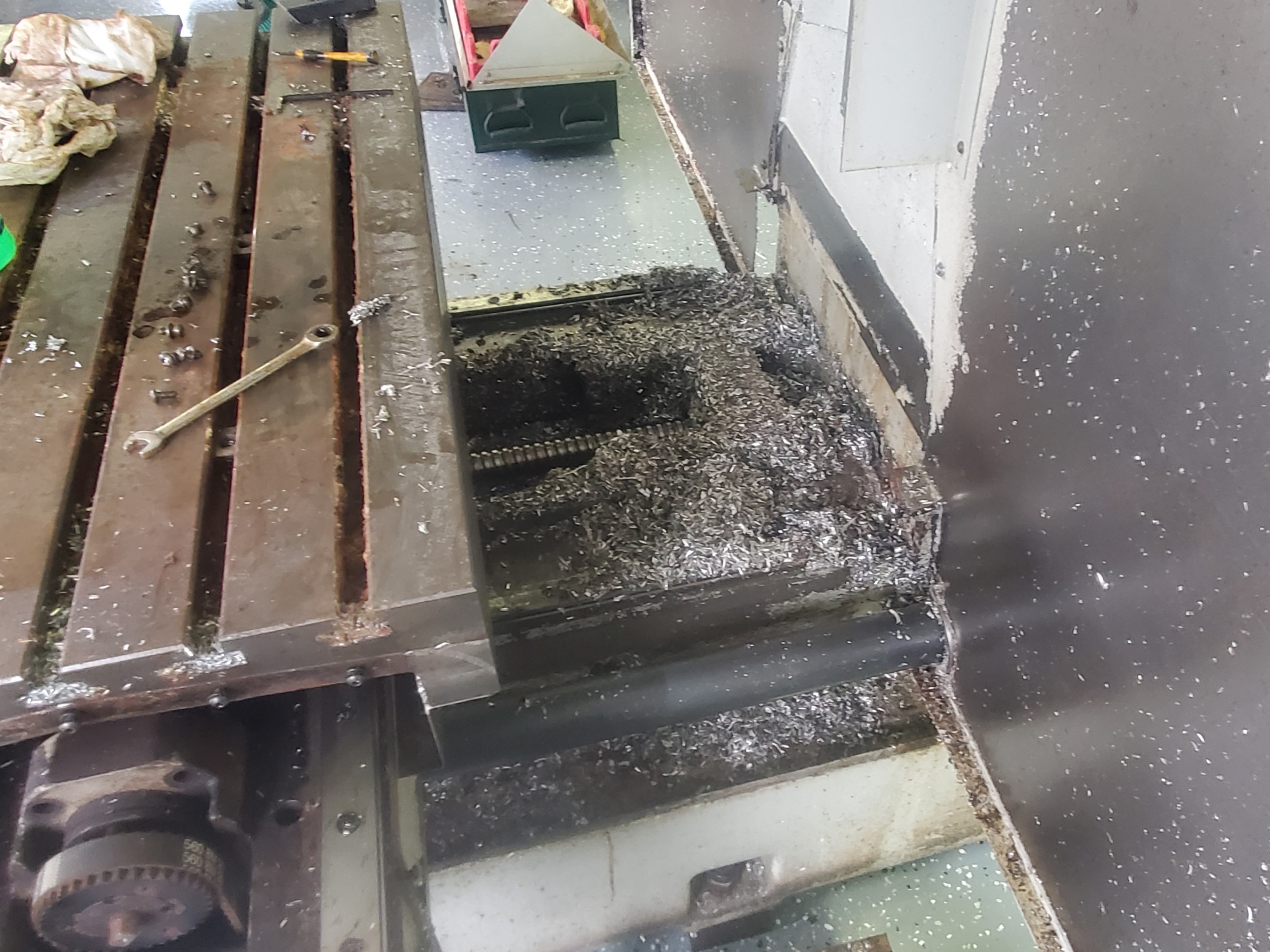

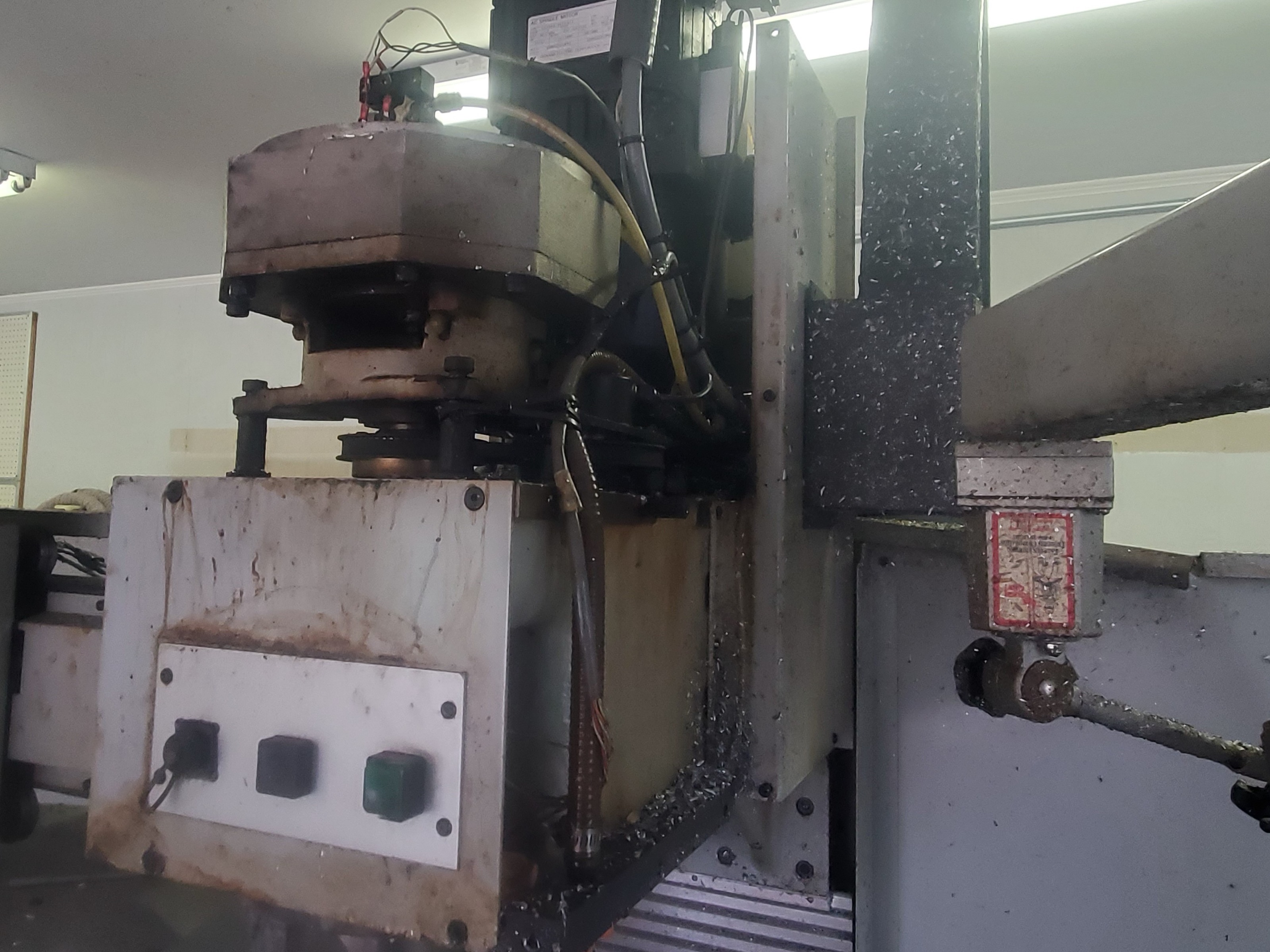

Replied by chopper79 on topic Bridgeport Torq-Cut TC4G Retrofit

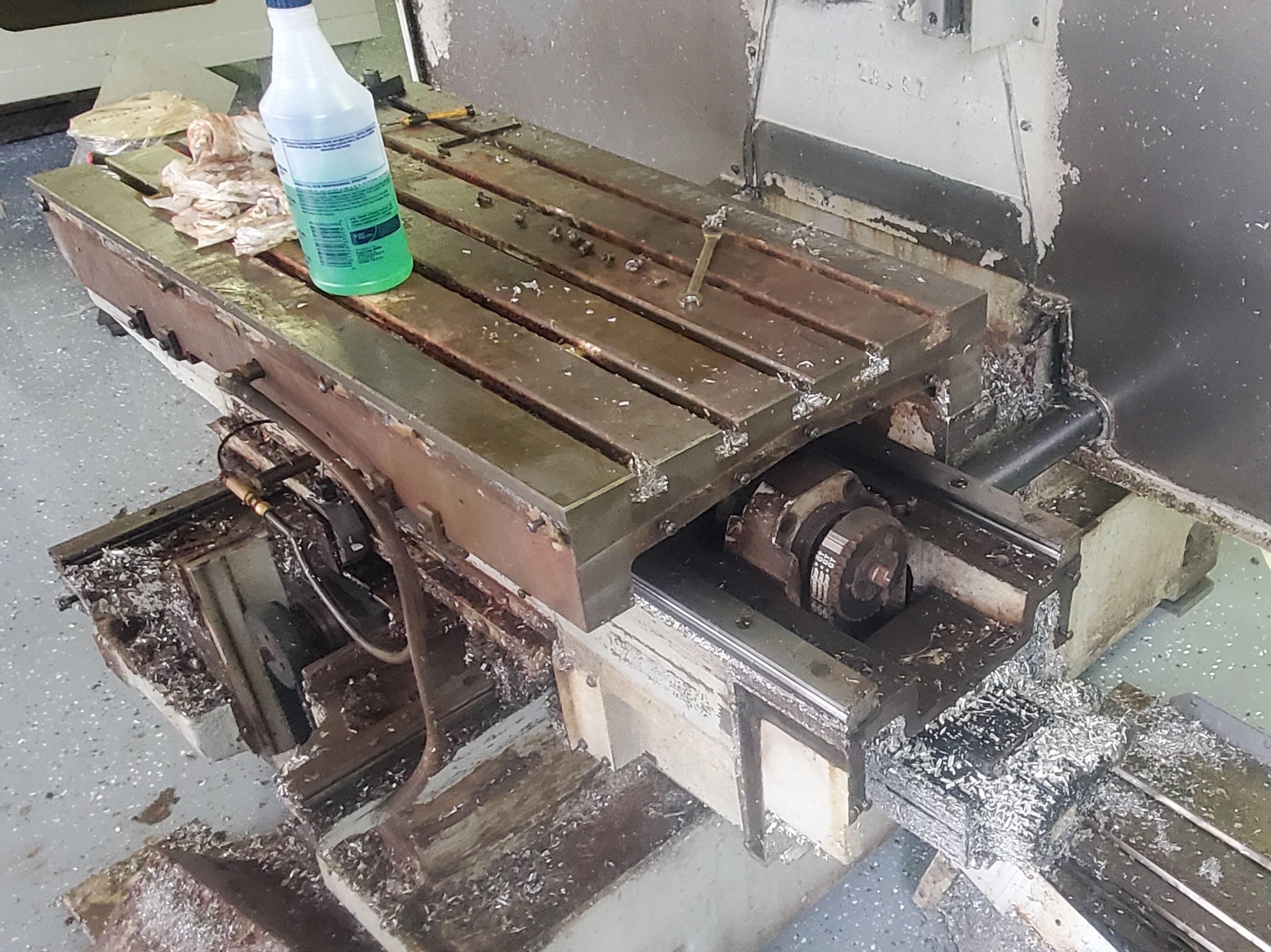

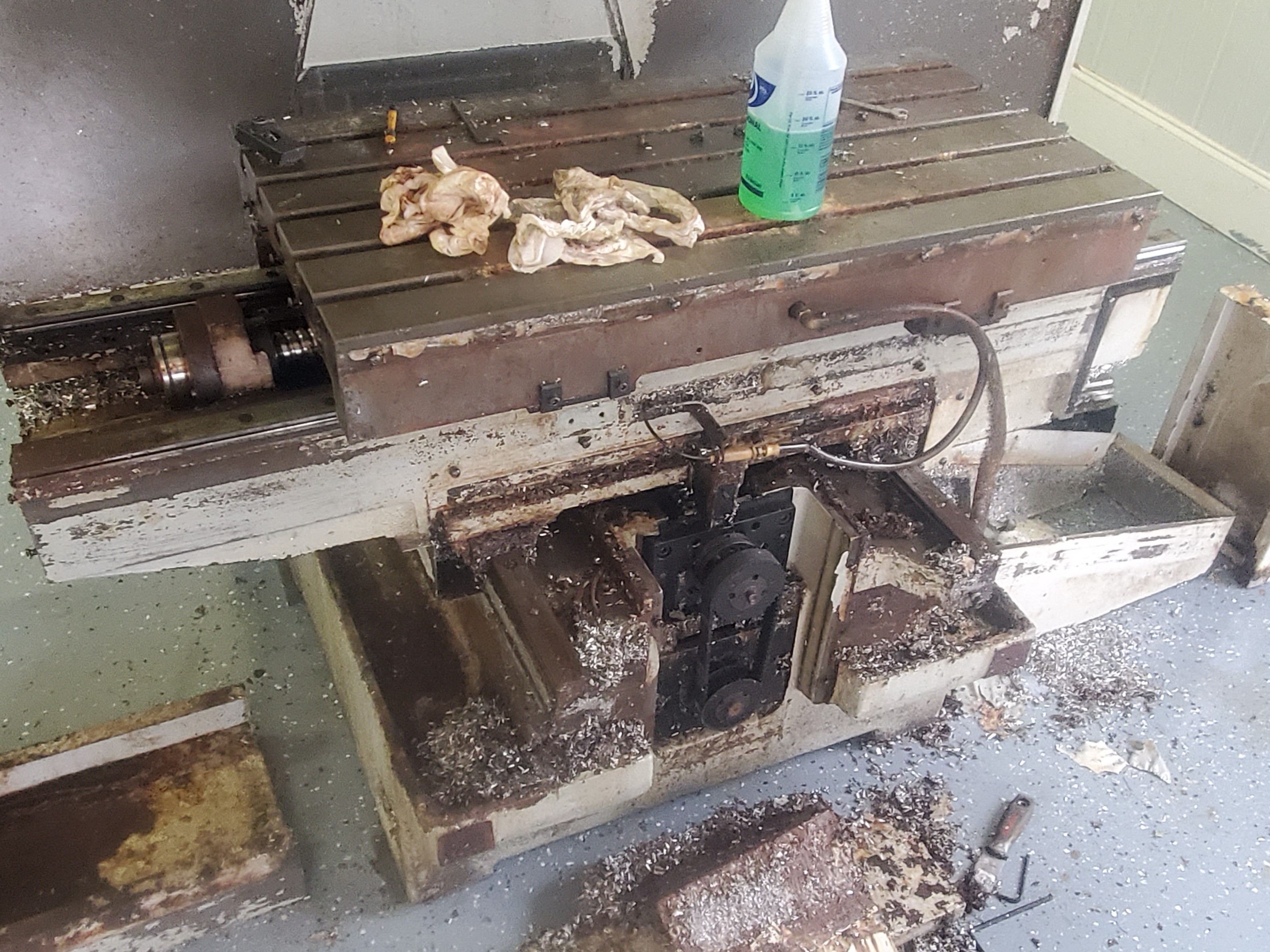

Took more covers off and found more stuff to clean. Also seems like there is a Y axis thrust bearing going out.
A thought on the trust bearings... There are no oil lines going to them and I am sure that the previous owner did not PM this thing. I think I am going to run oil lines to the thrust bearings and meter the volume to an acceptable mount specified by the bearing OEM. This should help extend the life of them.

Replied by tommylight on topic Bridgeport Torq-Cut TC4G Retrofit
That still looks pretty clean compared to a Hurco i retrofitted a while ago, it was full even under the covers!

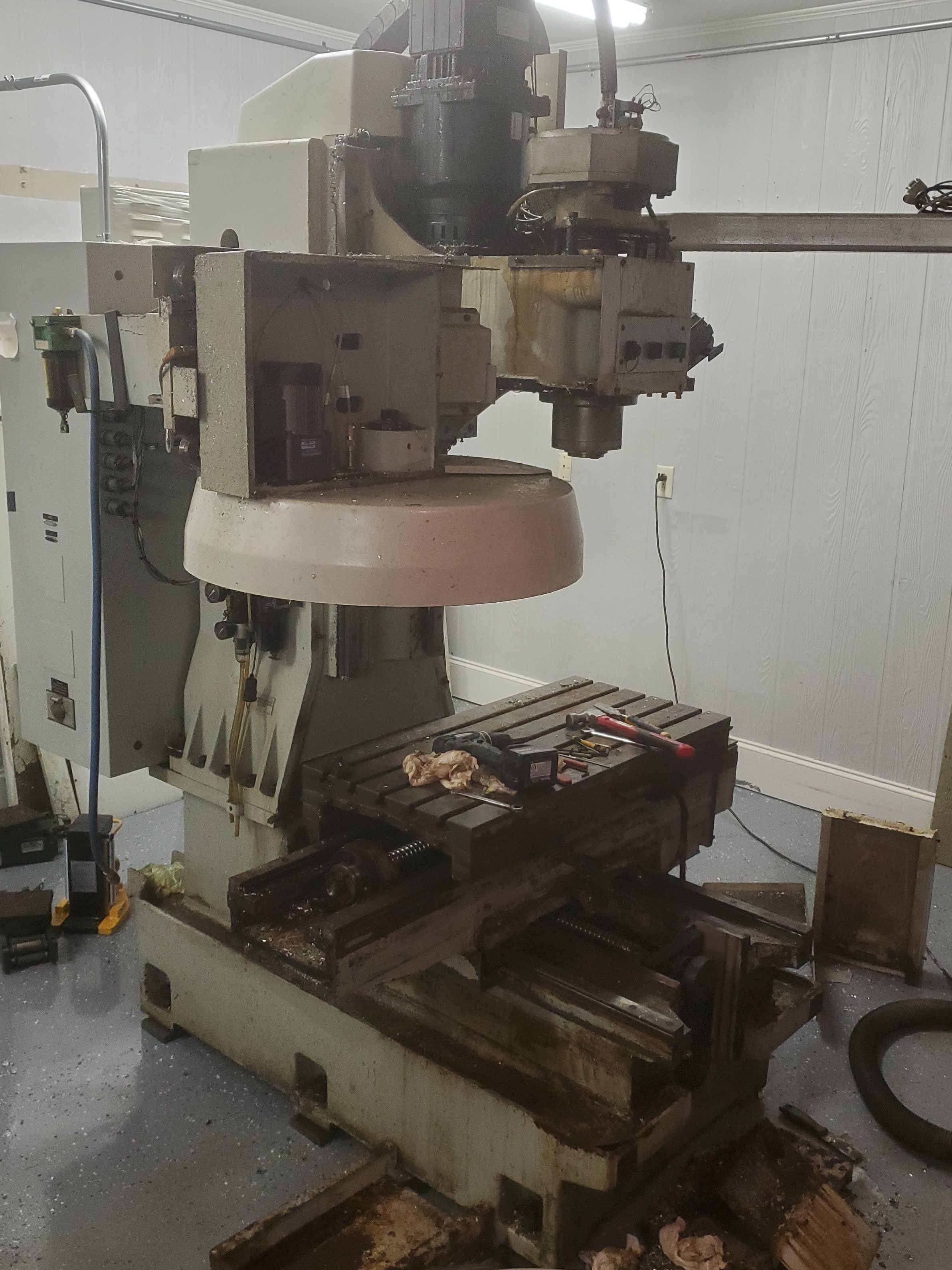

Yeah it is not terrible, but still dirtier than I care for. I will have to say that this is going to take longer than I wanted due to me taking the mill down to the casting. This includes rails, ball screws, oil lines, everything comes off. Only way I can get all the junk off of the mill and get a solid paint job on it.
I will update more when I get things torn down and begin the journey going back together.

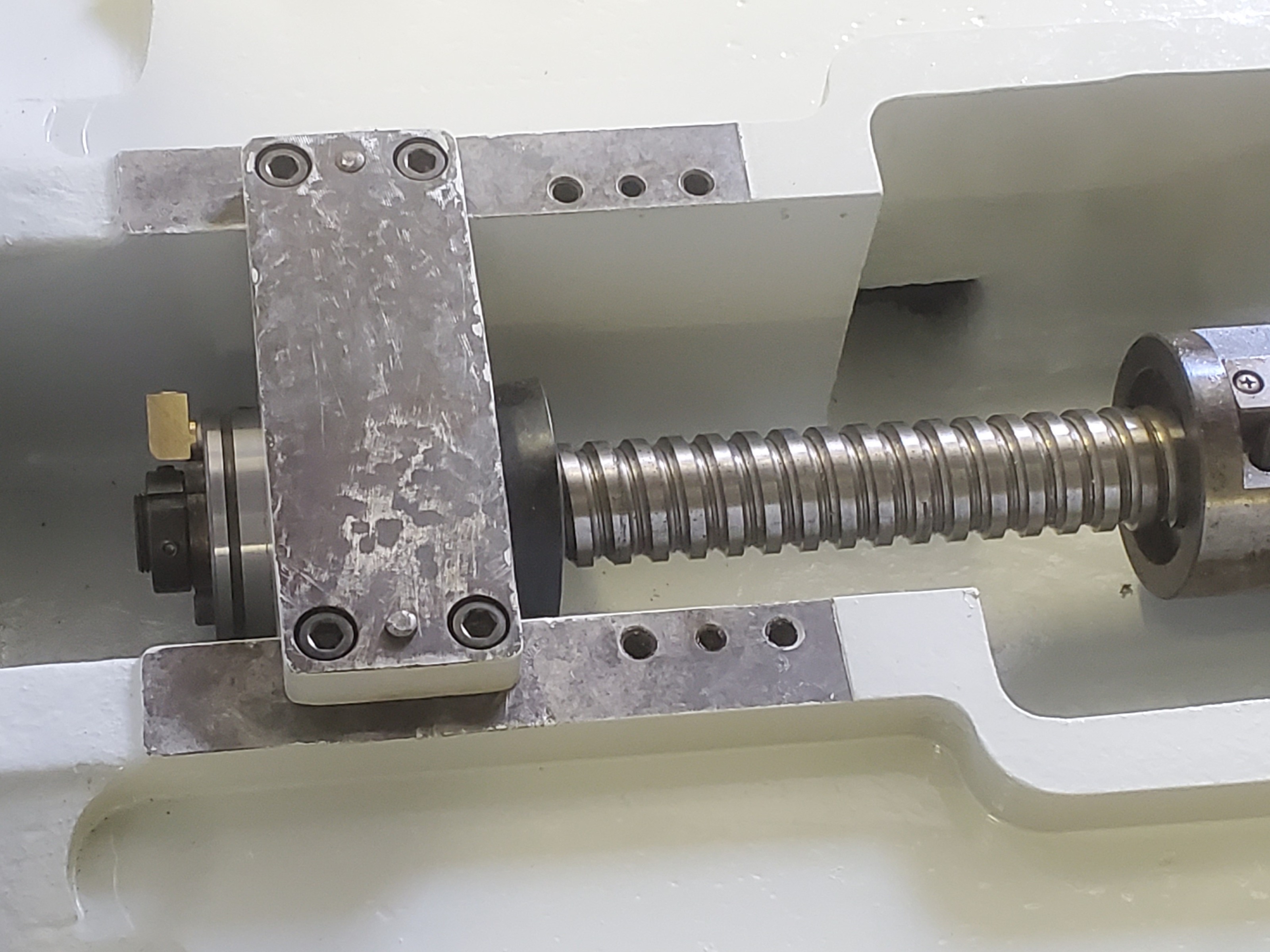

16 Aug 2020 16:33 #178412
by chopper79

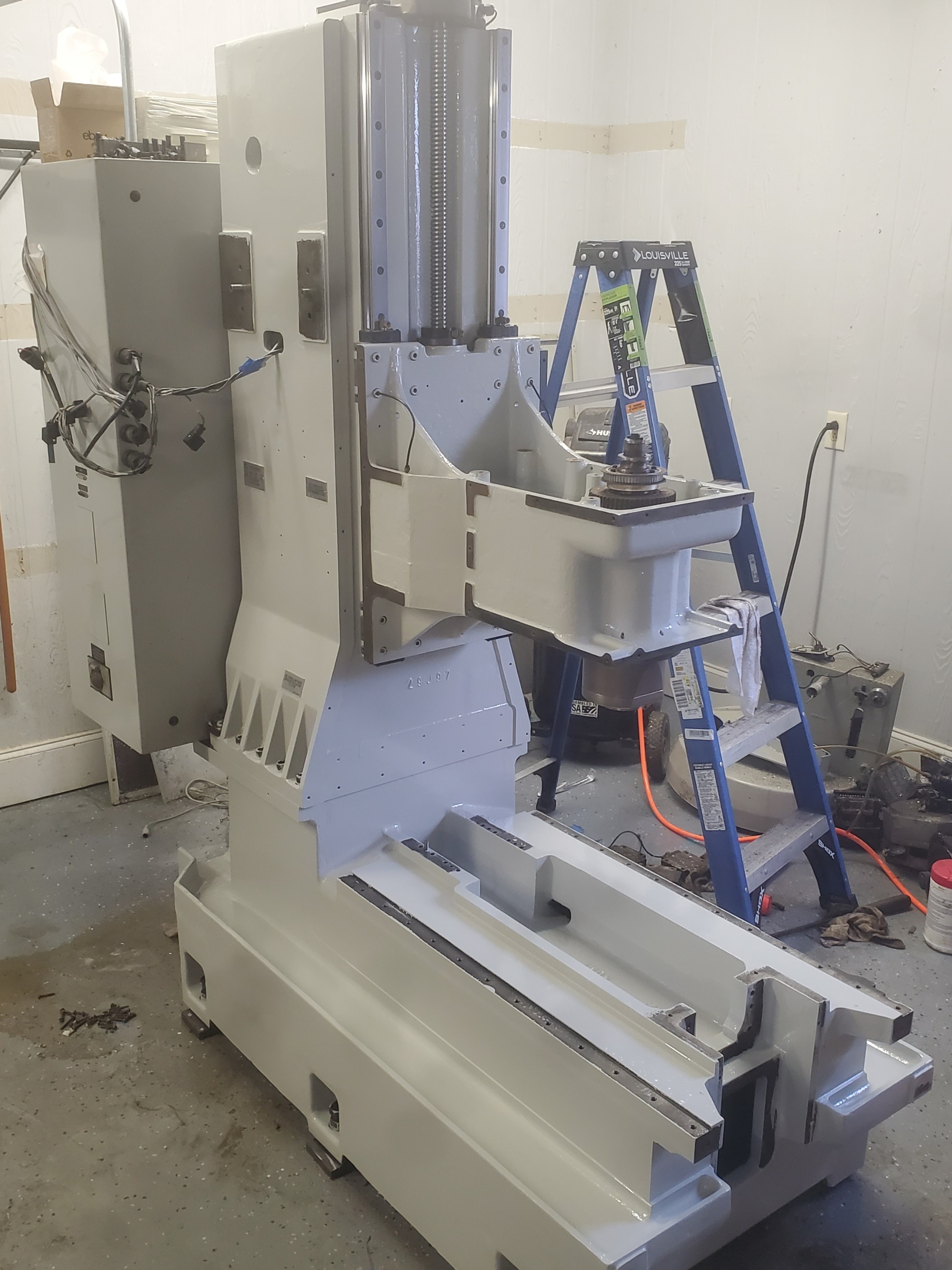

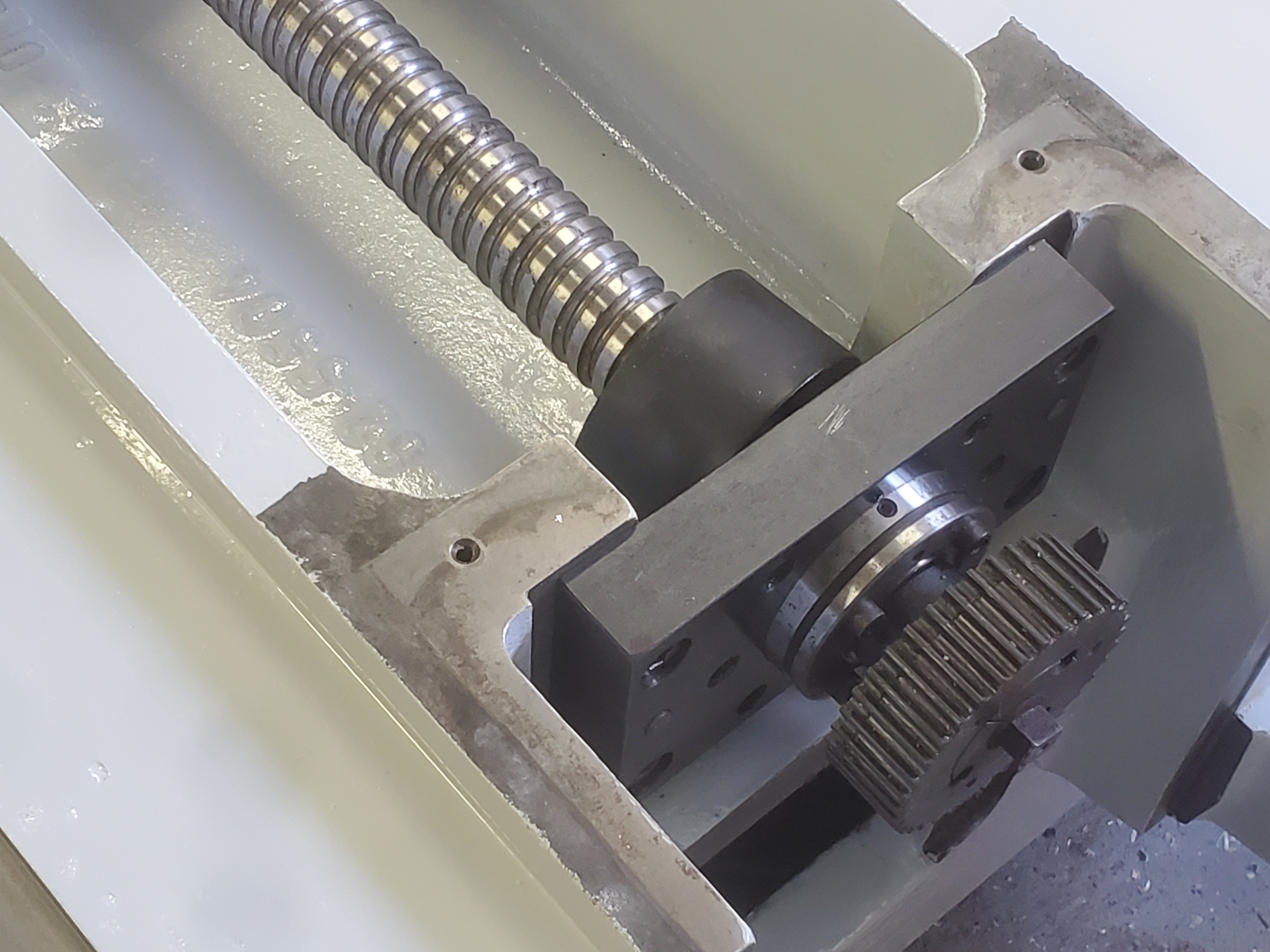

Well it has been awhile since I posted any updates due to work, farm, and family. Here is the current state of the mill.
1) Torn down and all rails and ball screws came off. Removed paint and prepped surfaces This thing was bare casting minus the electrical enclosure.
2) Painted (SW Sher-Kem paint)
3) Starting to go back together (Z axis rails and ball screw back in along with spindle cartridge and head).
4) Adding lubrication to all the thrust bearings as there was none from the factory and that just did not seem right to me. Need to do the front thrust bearing still.
As I find time to do more I will update.
