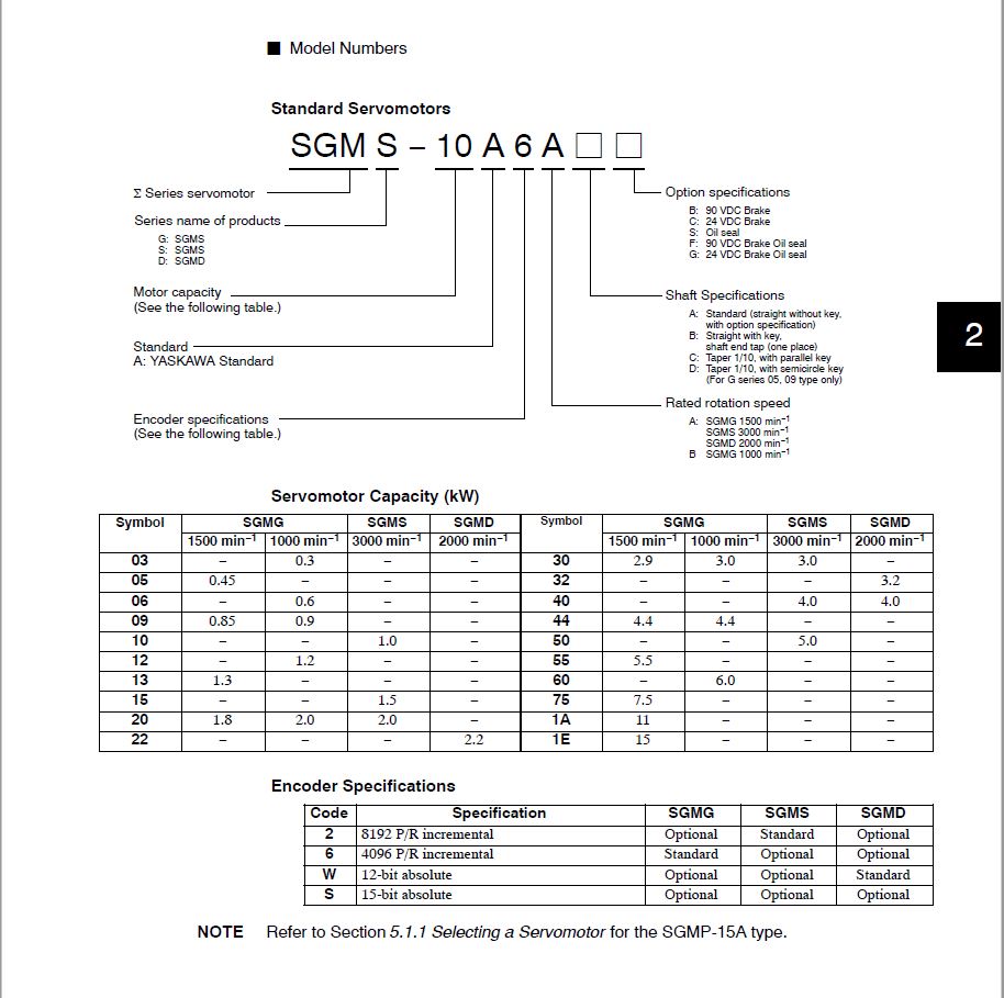

I am in need of some help here.
I am in the beginning stages of testing the LCNC config with the machine before I button up the last of the wiring and give y'all update pictures. The issue I am having is as followed:
1) Can not get any axis to move without a following error. I have tried many different encoder scale values based on the information I can find.
2) The jog velocity never changes when trying to move also. If control is set to 10 IPM the axis just rotates slow before the following error. If I change the jog to 600 IPM the axis rotates at the same slow speed before the following error. Almost like it is not getting a +/- 10v signal.
3) Have an issue with the spindle as well but I will save that one until the axis can move correctly.
The servo motor part number = SGMG-13A2AB which means it has a 8192 pul/rev from what I can tell. Also the ball screw on the machine is a 12mm pitch which should equate out to an encoder scale of ~ 69,358.0 unless my math has failed me which is possible.
I have attached the servo spec sheet and my config files.
If anybody has any ideas on this issue that would be great. Also if it matters the config was setup using PNCconf.

I have not went into the tuning yet as I am not even able to jog more than 1/8 of a rotation of motor shaft before the following error occurs. I did set my following error to 1.0" and still could not get the machine to jog hardly at all until the following error occurred.
Based on my experience with other retrofits I have never had to adjust the PID to get basic movement. Once basic movement with a large error is achieved then I tune everything in. Either I am lucky or something else is going on with my setup. Here is the current status of lets just go with Y axis
* Axis is stationary when enabled (No runaway or movement of any kind, minus dither of 0.0001")
* When trying to jog axis the motor will move about 1/8 of a rotation and then fault with a following error
* Increased error to 1.0" which allows for maybe 1/2 rotation of motor shaft
* Jog speed set at 10 IPM (slow rotation of motor shaft)
* Jog speed set at 600 IPM (Same slow rotation as 10 IPM)
I have not adjusted any PID items yet. Just seemed odd that there was no basic movement of the machine like the other 8 times I did retrofits. I also have not put a VOM on the +/-10 to see what the voltage is either so I can not report that.
Encoder scale math (Please verify) 8192 p/r x 4 / 12.0mm (Pitch) = 2730.666 x 25.4 = 69358.933 (Sound correct?)
I will double check a couple things tomorrow and see what happens. I may have a feedback signal, output signal, and scale all incorrect which is causing this. I don't know...

Well... I feel like a complete idiot now.
After doing a bit of thinking about my statement earlier on how it seems that something is up with the +/-10v. I decided to check the wiring..
Y axis works wonderfully now. It helps when you do not have the Aout and Gnd swapped for your analog out. The end was cut off so I made a guess at what was what.
I went with a simplistic approach which was Red wire goes to Aout and Black wire goes to Gnd. It is actually the other way Black goes to Aout and Red goes to Gnd.
Well time to do the X and Z axis and hopefully the 7i77 is not damaged. It should not be even though this mistake can damage it.

10) Noticed there is always a 1rpm offset when watching items in hal configuration (Turn spindle on = 1rpm. Turn spindle up to 100rpm and hal shows 101rpm)
11) Tried spindle on analog4 and same issue as on analog5
Still no luck on this as of now. I will update more later as this gets worked through. As always any suggestions are welcome..
Last edit: 08 Feb 2021 19:56 by chopper79.
- Posts: 18085
- Thank you received: 5320
08 Feb 2021 20:10 #198058
Replied by PCW on topic Bridgeport Torq-Cut TC4G Retrofit
Had you previously set the spindle speed to 1 with
M3 S1?
M3 S1?
