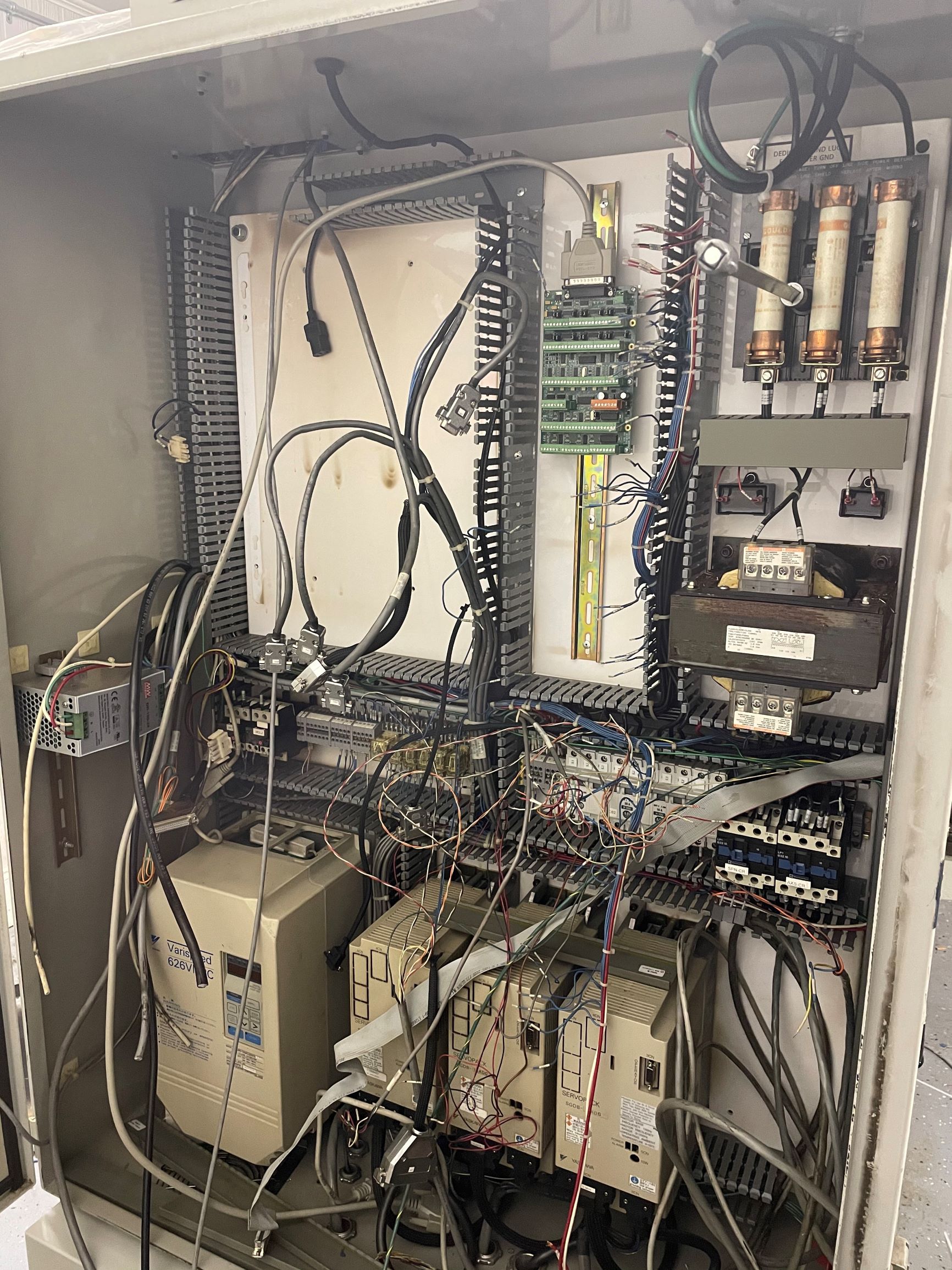

Well here is the next update...
1) Spindle motor pinion gear installed on motor
2) Spindle motor installed and wired
3) Head, tool changer, and valve wire replaced
4) New tool release buttons and plate
5) Old boards out of cabinet
6) New lube line for table
7) All components wired and ready to be landed to the 7i77
Hoping to have ~30% of the wiring landed by the end of the weekend. Getting closer to bringing it back to life.

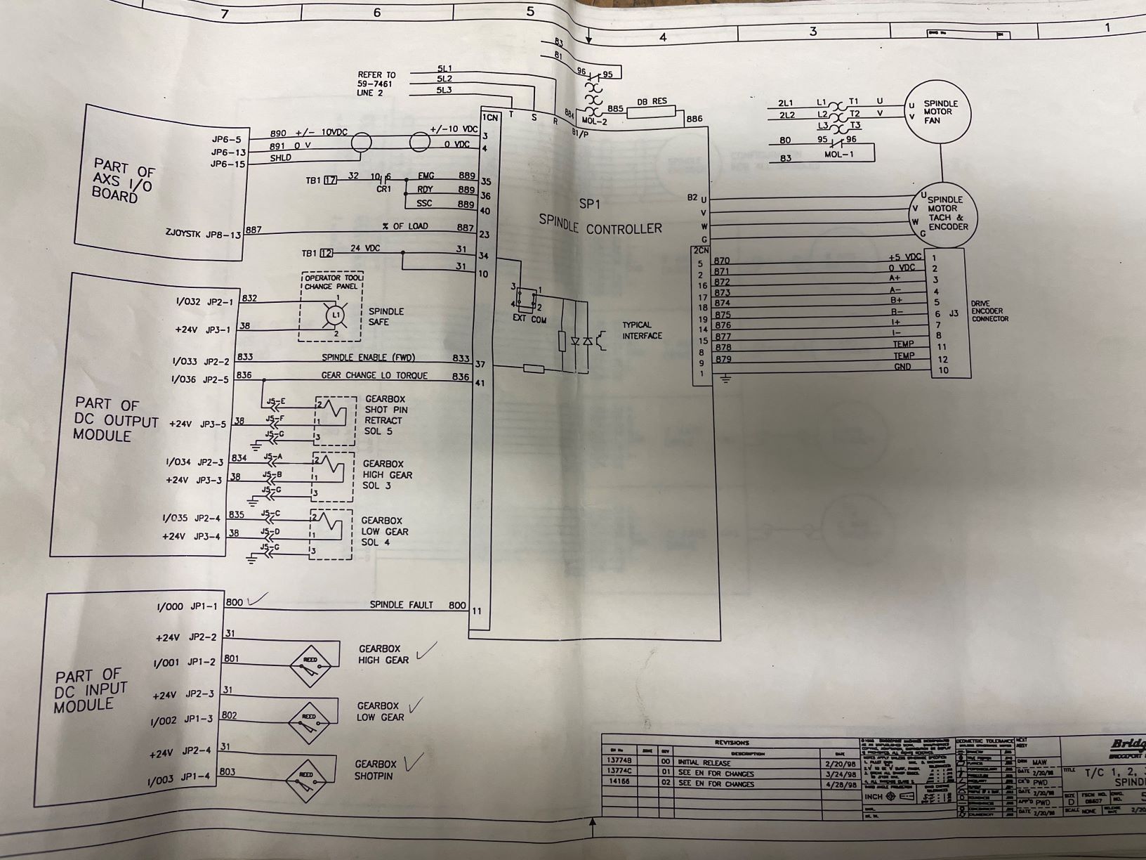

I am excited to work on the tool change code.
Need to first figure out how they are orienting the spindle as the machine did not utilize the orientation input on the vfd. I am thinking they utilized the torque limit mode (Pin 41) and fwd input (pin37). There is no sensor for it also, so it seem the vfd is put into incremental or absolute and then moved X amount of degrees from the index mark on the encoder. The orientation complete is also not utilized on the vfd so this makes me think that the controller had a programmed angle then when that was achieve, then the spindle locked and when no rotation was seen the tool change proceeded.
Just guessing here...
Last edit: 18 Jan 2021 23:33 by chopper79.

Replied by Michael on topic Bridgeport Torq-Cut TC4G Retrofit
I have only gotten as far as to hook up the tool changer components to relays after deconstructing the boards they used to perform the changes. Have it all working individually but have not tackled the sequence yet.
Found a bad spindle bearing. Would love to know what the max speed I could get out of a spindle rebuild is. My 8k is cool but would be much happier in 12-16k range. Could end up going to a all in one motorized spindle if the price is similar.
Spindle wirong diagram looks similar. I don't believe I had an orient from the drive. Will need to be oriented off index.

19 Jan 2021 00:14 - 19 Jan 2021 00:19 #195847
by chopper79
Replied by chopper79 on topic Bridgeport Torq-Cut TC4G Retrofit
Yeah that is what I was figuring as well when it comes to orientation. Could always run a couple more wires and get orientation and orientation completed signals. Then reprogram the vfd a little bit so it looks for the input and then send the output.
I hope mine is 8k, so far it appears to be 6k, Will know more when I get the machine fired up again and look in the drive constants. Motor is capable of 8k based on data plate and manual but the bearings in the spindle motor are only rated for about 8k or a little less based on NTN website.
