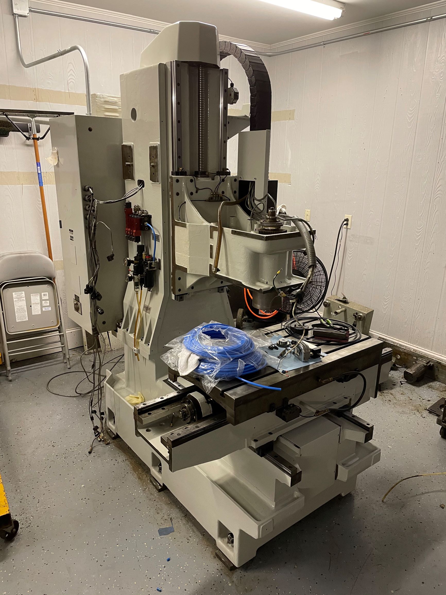

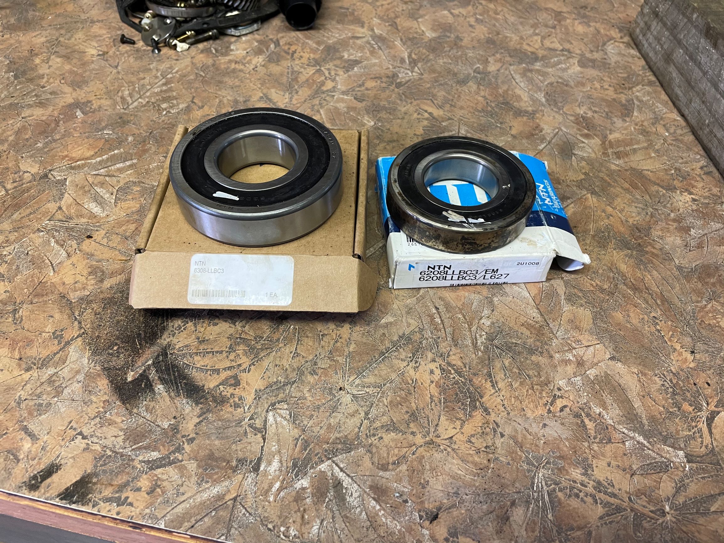

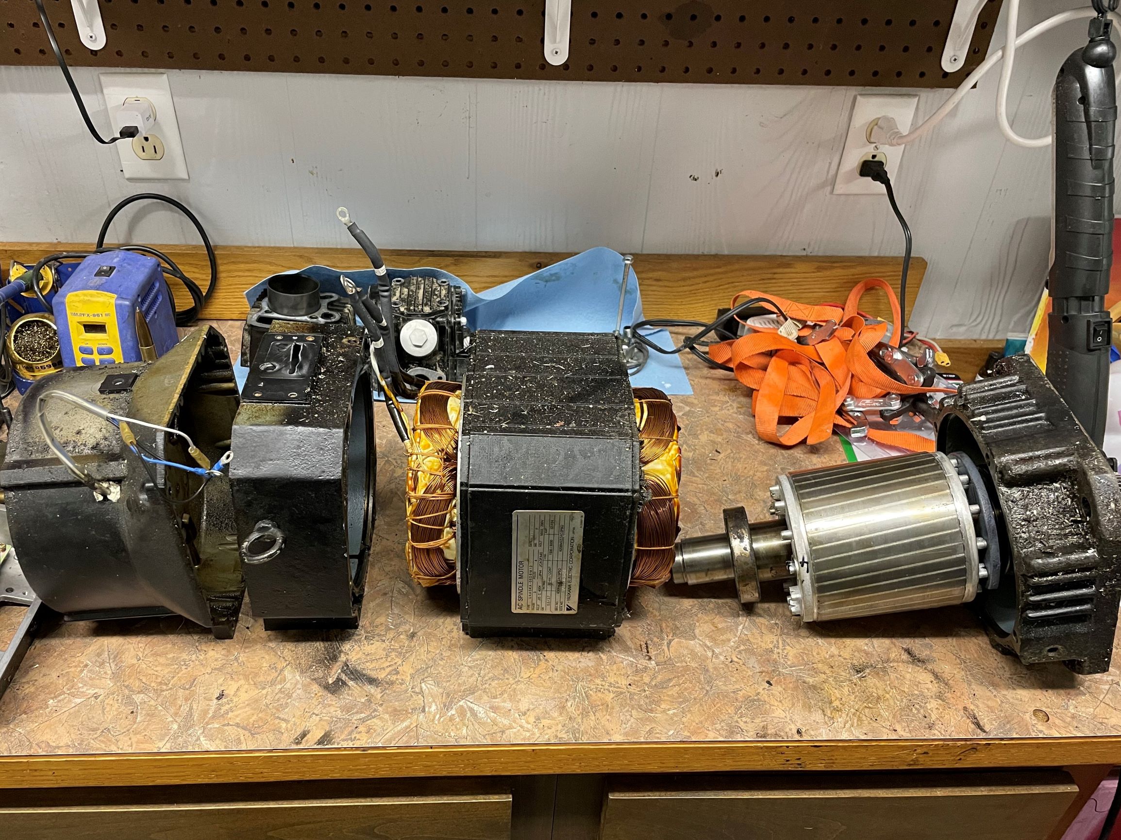

No pictures = never happened !1) Rebuilt the transmission (Awaiting install)
2) All heavy components including machine bed have been installed.
3) Painted multiple parts
4) Began running new air lines and any needed oil lines.
5) Awaiting new spindle motor bearings, so rebuild of motor can begin. (Currently disassembled, just awaiting bearings)

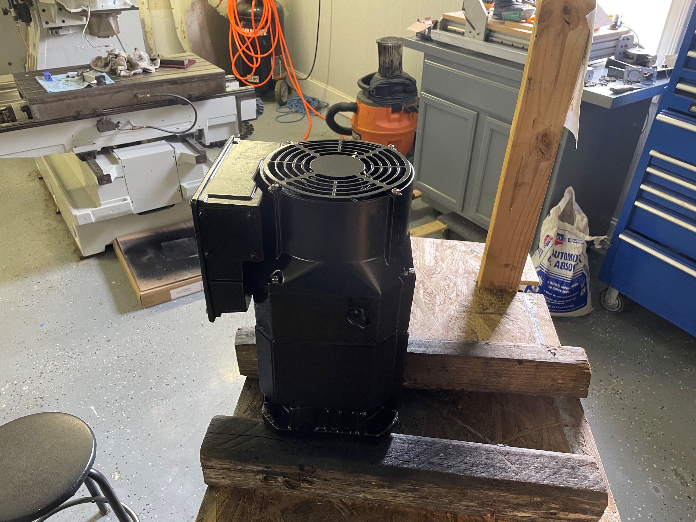

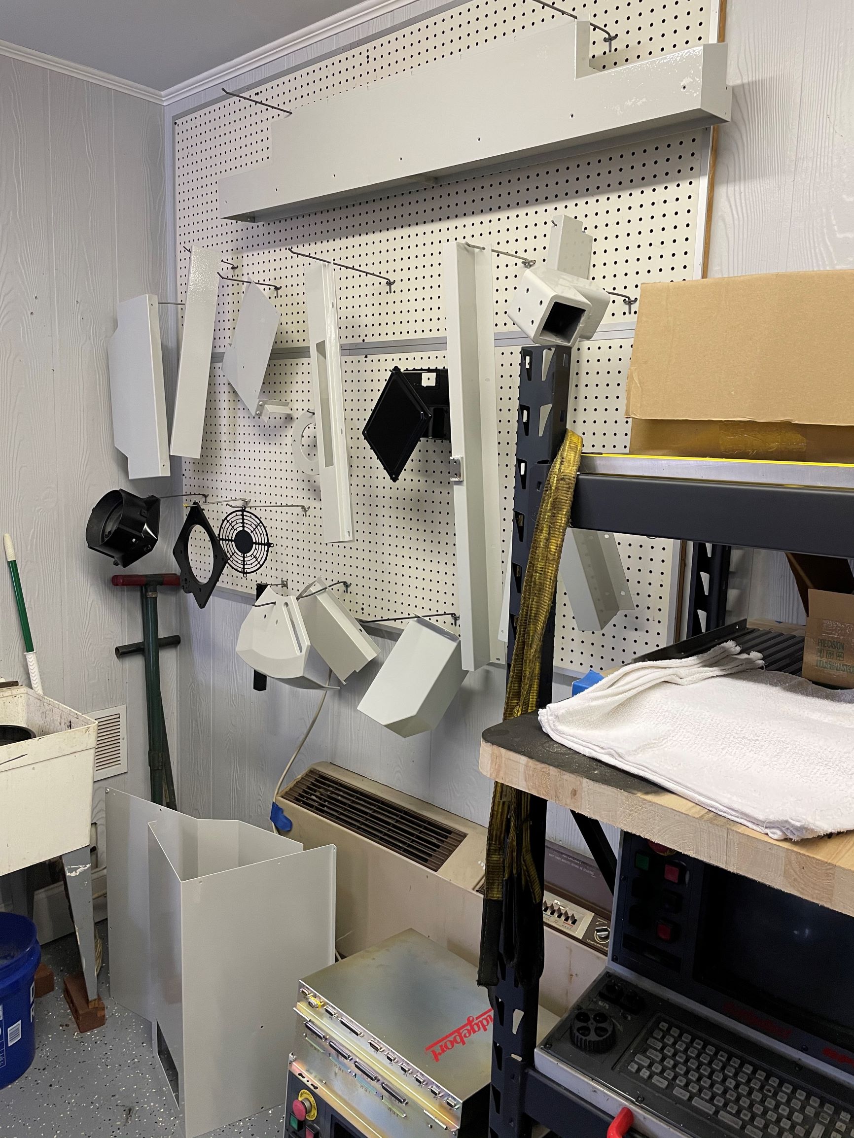

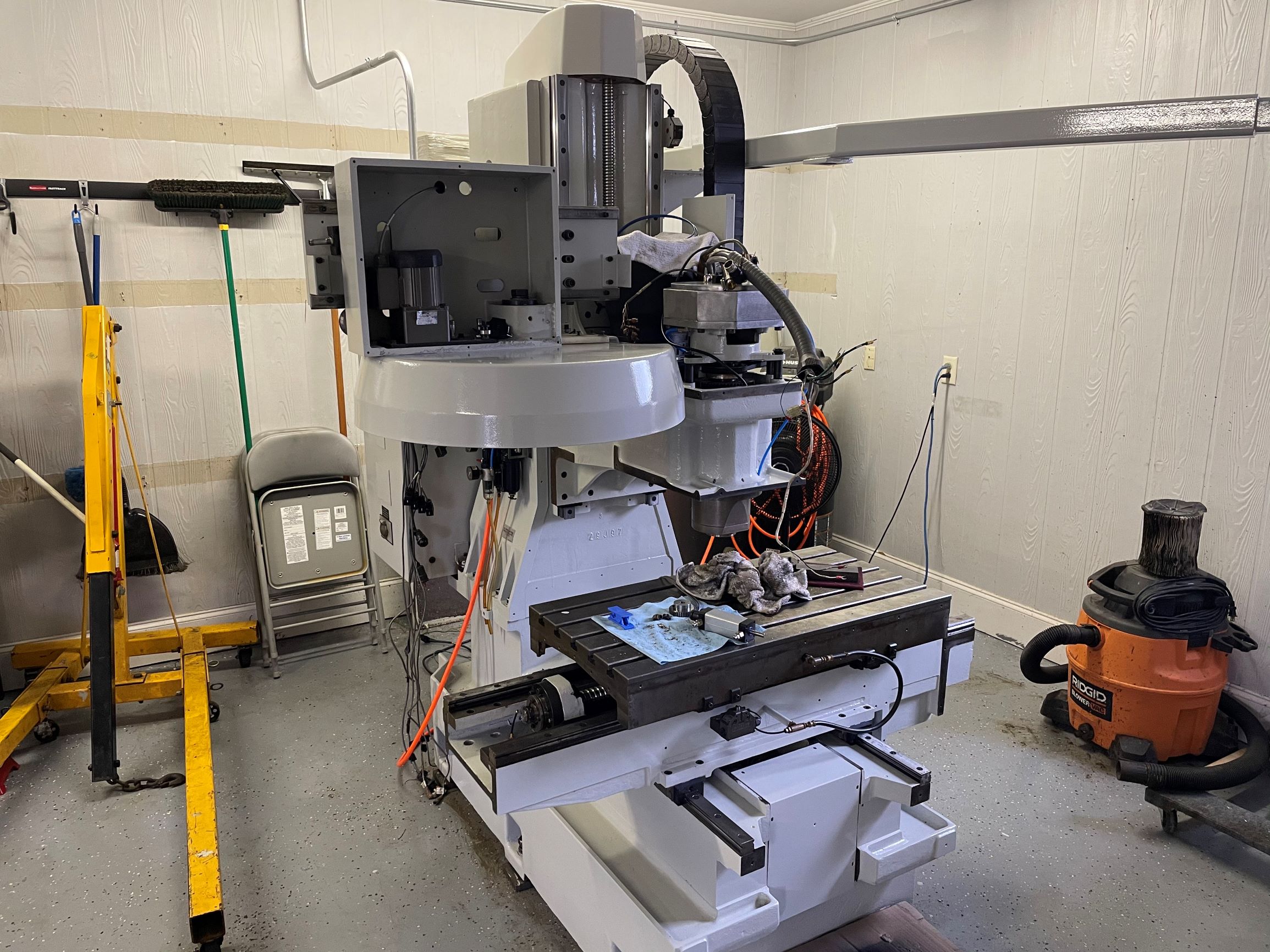

31 Dec 2020 17:39 - 31 Dec 2020 17:48 #193668
by chopper79
Replied by chopper79 on topic Bridgeport Torq-Cut TC4G Retrofit
Made a little more progress over the last couple days
1) Air lines are ran
2) All oil lines are ran (Minus the new one I am waiting on for the table)
3) Painted more panels
4) Working on spindle motor reassembly
5) Tool changer installed
6) Tool release cylinder and spindle encoder installed.
7) 6i25 and misc items ordered from Mesa
Need to finish the motor rebuild, but waiting on a gasket, spindle sleeve, and misc.
The rebuild is getting closer to begin wiring and get LCNC running.
Last edit: 31 Dec 2020 17:48 by chopper79.

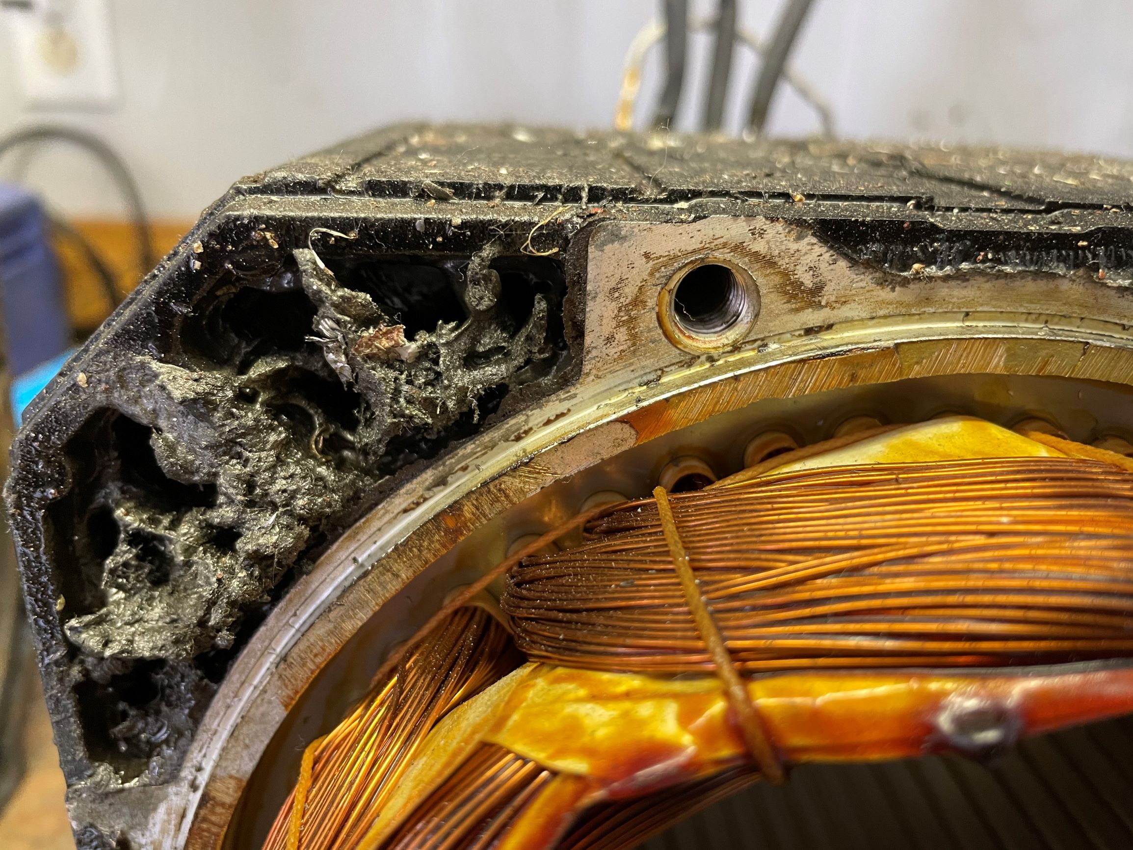

- chopper79
- Posts: 193
- Thank you received: 44
03 Jan 2021 18:50 #193972
by chopper79
1) Spindle motor back together and repainted.
2) Top plate (motor mount) installed on transmission and trans installed with new belts
3) Began wiring, but found where old owner hacked up the tool changer wiring pretty bad. (Was hidden in wire loom)(Ordered wiring for proximity switches)
4) Received my order from Mesa (Using a 6i25 and a 7i77 (Excited to get this part going as it will feel more like it is nearing the end)(Might order a 7i92m just so I can play a bit later, but need to get this machine fully functional first)
Awaiting the following before next update:
1) New oil line for the table
2) Spindle motor to trans gasket
3) Trans fluid
4) Misc wiring for tool changer
Well it will be a little bit before I update next as parts are on the way and my vacation is over.
3) Trans fluid
