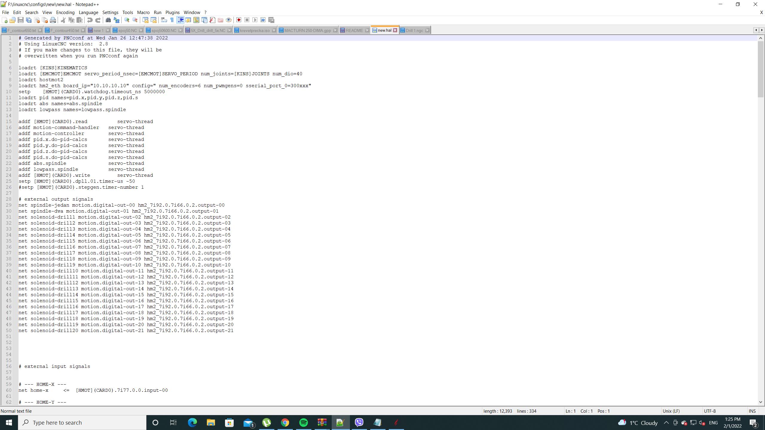

Here is my configuration, all currently installed outputs work great with 7i66. Thanks a lot Tommyligt and PCW! I would like an expert to remap these drill outputs by switching the m62-65 commands to a simple M6 toolchange where T1 would be drill 1 etc..routine where each output would work for 10 seconds at the call of the M6 Txx from gcode and then off after the movement is complete or before activating the next M6 Txx commands. Note that tool offset testing and the offset tool is not necessary at all because the drills are always the same height, and orgin does not matter, at all I would insert the M6 Txx in gcode. I would like to pay if this is feasible. Thanks

You would need to use the x and y offsets in the tool table.

I imagined doing a toolpath in swood for solidworks, which has an aggregate as a tool, something similar to the physical one on the machine..where it can define the spacing of drills, and would use home orgin for coordinate start. I have a problem because I don't know how to convert output (example m64 p1-M65 p1)with some simply routine to mcode toolchange M6 T1.

You would remap M6 and use selected tool to select the output to fire. So if you get M6T2, then in the remap energize that digital output accociated with drill 2.Ok thank you.

Can you give me some simpler example for say output 2 that would do (M64 P2 dwell 5sec than m65 P2) or the same with M62-63 ... and M6 T2 to fire that?

You can remap Mcodes and put those commands in there and just call the mcode in the remap.Can you give me some simpler example for say output 2 that would do (M64 P2 dwell 5sec than m65 P2) or the same with M62-63 ... and M6 T2 to fire that?
But I suspect the issue is in the remmapping. Look at the examples in the sim with remapping and get familiar with them.

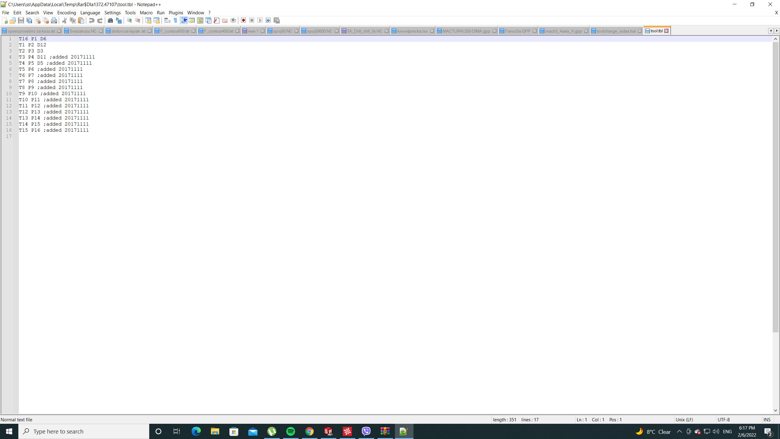

06 Feb 2022 11:26 #234127
by Masiwood123
Replied by Masiwood123 on topic biesse rover 316 retrofit
- ehb
- Posts: 38
- Thank you received: 5
06 Feb 2022 11:31 #234130
by ehb
Replied by ehb on topic biesse rover 316 retrofit
Hello Masiwood,
I haven't looked at the tool tables of LinuxCNC yet, but from the documentation P means pocket and D means diameter.
However I can for sure tell that G4 P2 is the g-code command for a 2 second pause.
