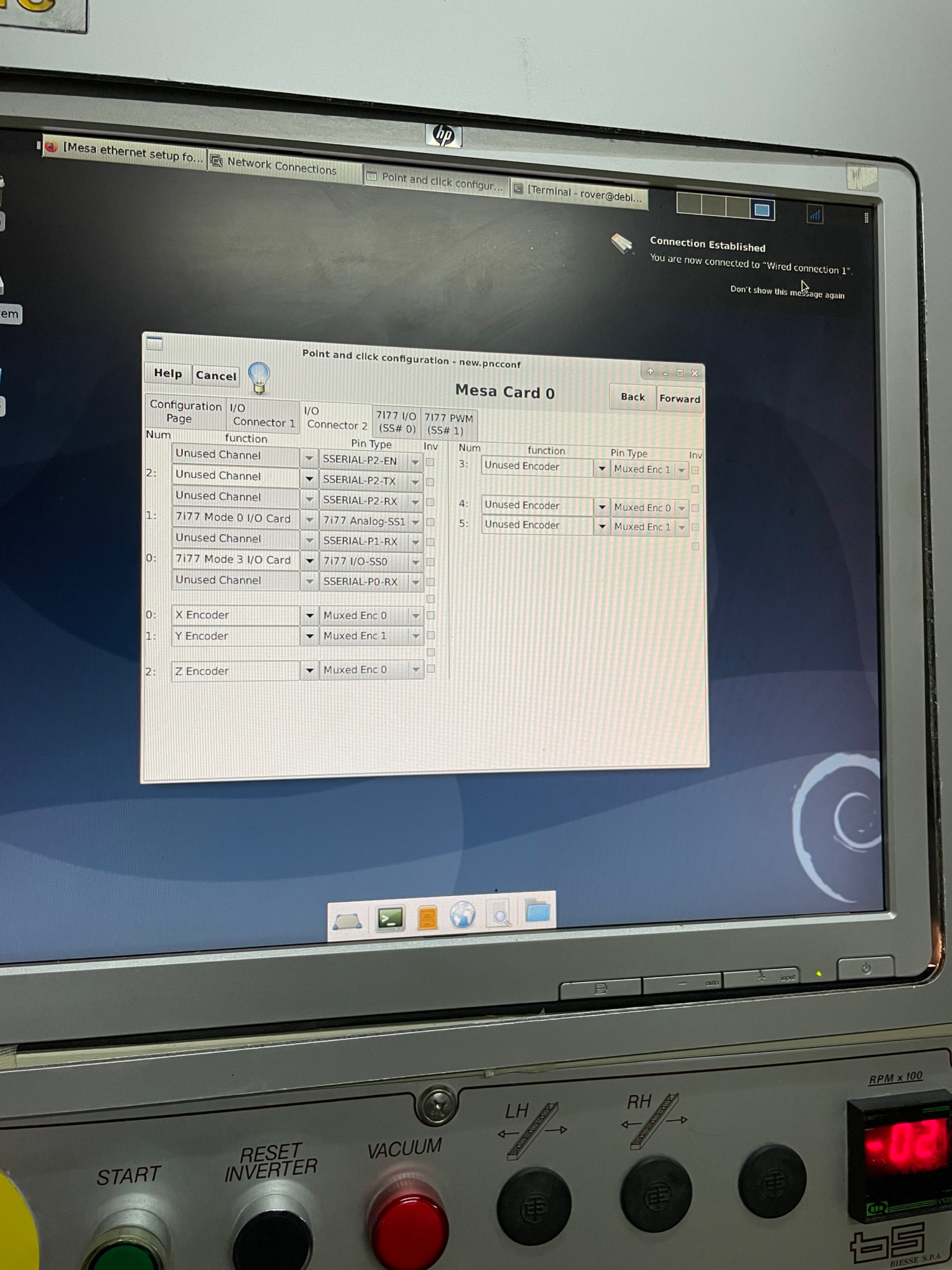

Thanks everyone I was confused so I didn't figure out what to try ... now I'm going to try to change that line and see if it helps ..

I finally managed to start the configuration! I can't describe how happy I am. (I crossed that line by putting #) now I can access the tuning of the machine in real time..Guys very very much thank you, you are all kings!

yes, whenever I edit pnconfig the hal changes, of course, and for now I always correct that line to get into the machine. which is the reason that linux always exports .. for me it's high school but I have no objections if it doesn't affect some later settings, I'm happy with this too
now i am reading a post about servotune by tommy and the next step is to bind the encoder .. i am reporting with new progress

my next question would be how to connect the line to enable servo amplifiers? factory on the machine it is + 10v that comes from the relay to the driver.
On 7i77 there is ena0 and ena + .. as I understood I need to put those + 10v on ena + and with ena- to go further wire to servo amp (driver). Is that correct?

The ENA+ and ENA- outputs are a switch so yes, if the drives are enabled by +10V, you wire
+10V to ENAx+ and wire ENAx- to the drive enable input.
It does look like there is a bug on pncconf when setting up a 7I77 only configuration
with a a 7I92 where it adds settings for a stepgen configuration.
(a 7I77+5i25 configuration does not have the same bug)

thank you tonight i should wire it and try make one axis run.. about 7i77 i think i did right firmware to 7i92 file 7i92_7i77_7i74D. .. but on pnccfg i have the same only choice i figured right and that is 7i77x2 with 7i77 on ( only that 7i77 has right number of encoder”six”) and i use mode3 operating for 7i77.
