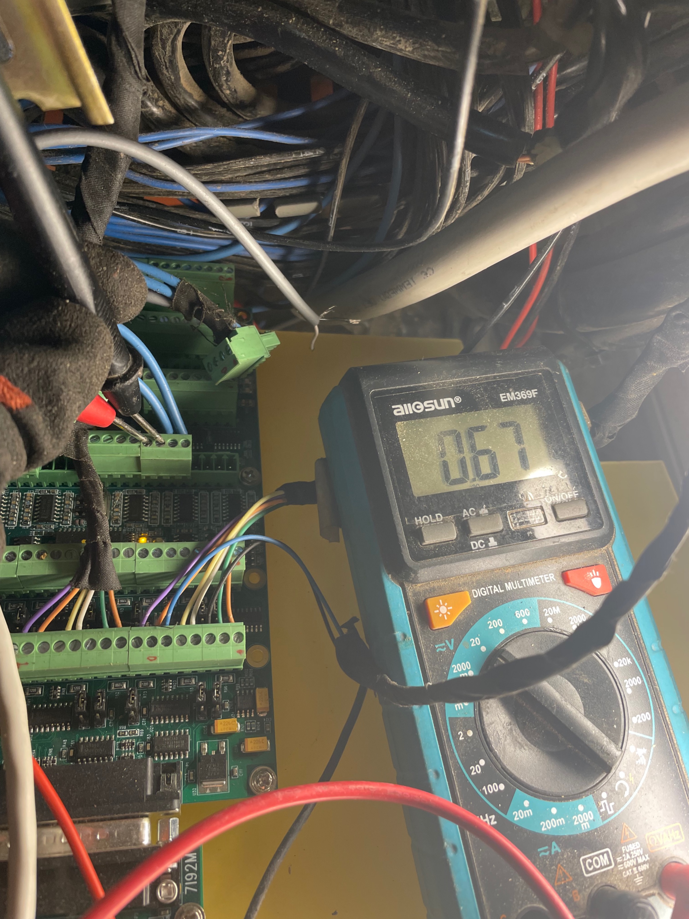

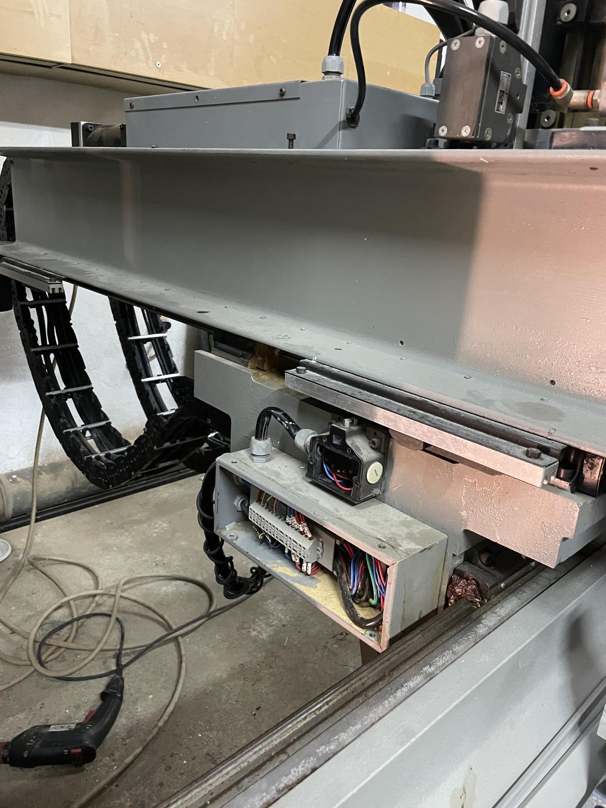

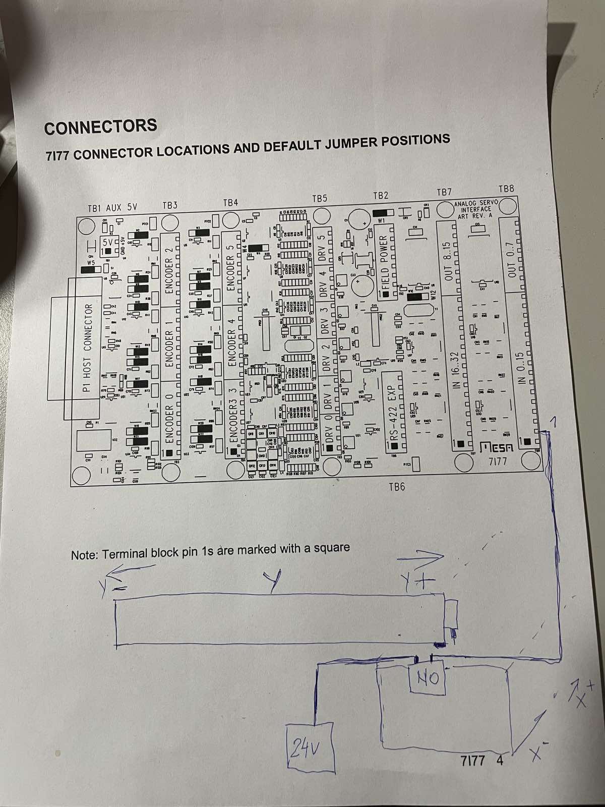

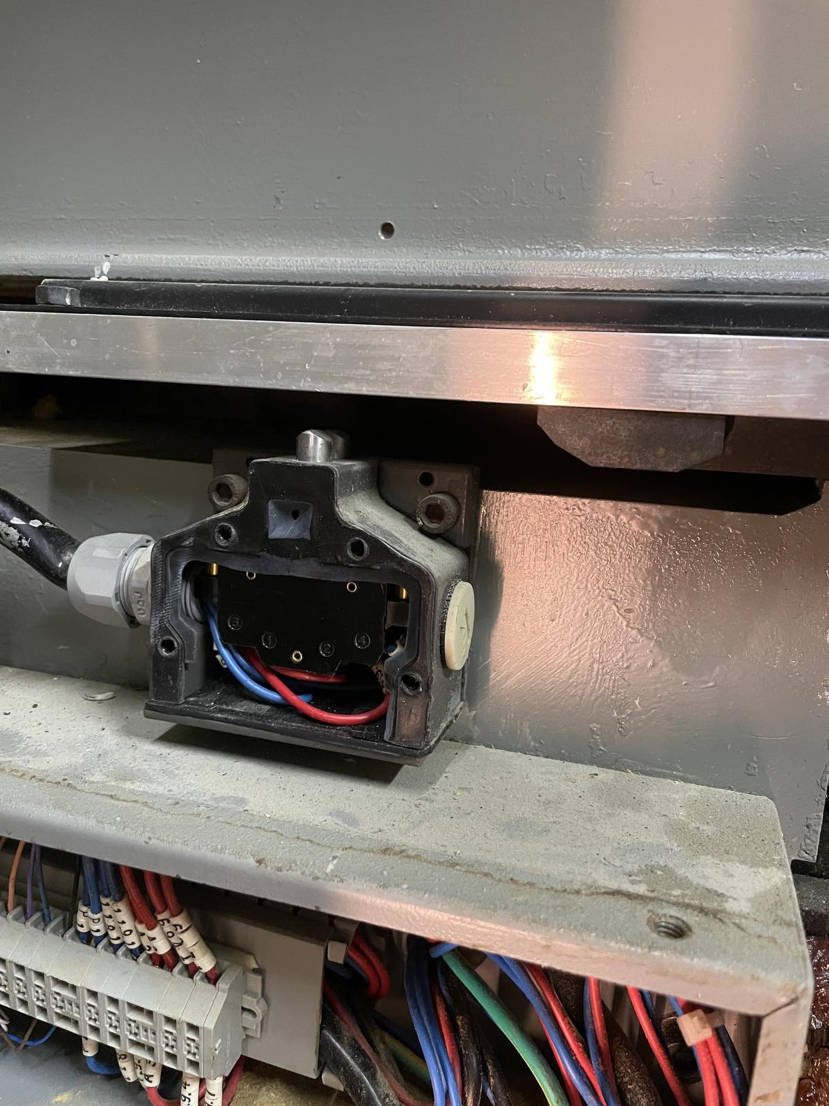

finally the new 7i77 has arrived and I have returned all the wires and again all three axes are working

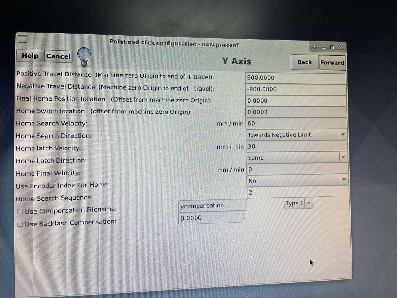

.. can someone on the basis of these pictures suggest what to write in the fields to home say y axis? home switch is Normaly Open and one end goes to input 1 on 7i77. Switch is only one for both directions of axis movement..here are so many points in the explanation that I have read many times and it all confuses me.thanks
- Posts: 22037
- Thank you received: 7505
25 Jan 2022 18:20 #233127
Replied by tommylight on topic biesse rover 316 retrofit
Wiring looks OK.
In PncConf (that i just noticed an issue where two entries have the same explanation "offset from machine zero origin" so now i have to guess ), the negative travel should be 0 (not -800, that makes axis 1.6 meter long!), final home position should be -3 or 3 (try -3 first), home switch position leave at 0, home final velocity at 30, and might also need to change the latch direction, but only after testing as is.

Tom it works:) except i put -3 on home search location not on final home location.. also i increase home search velocity to 1000mm/mm because 30 is too slow to reaching if i am far away from switch.Btw is somewhere custom spindle speed gadgets already made with rpm rounded clock for example, home all button etc? Thank you very much!
