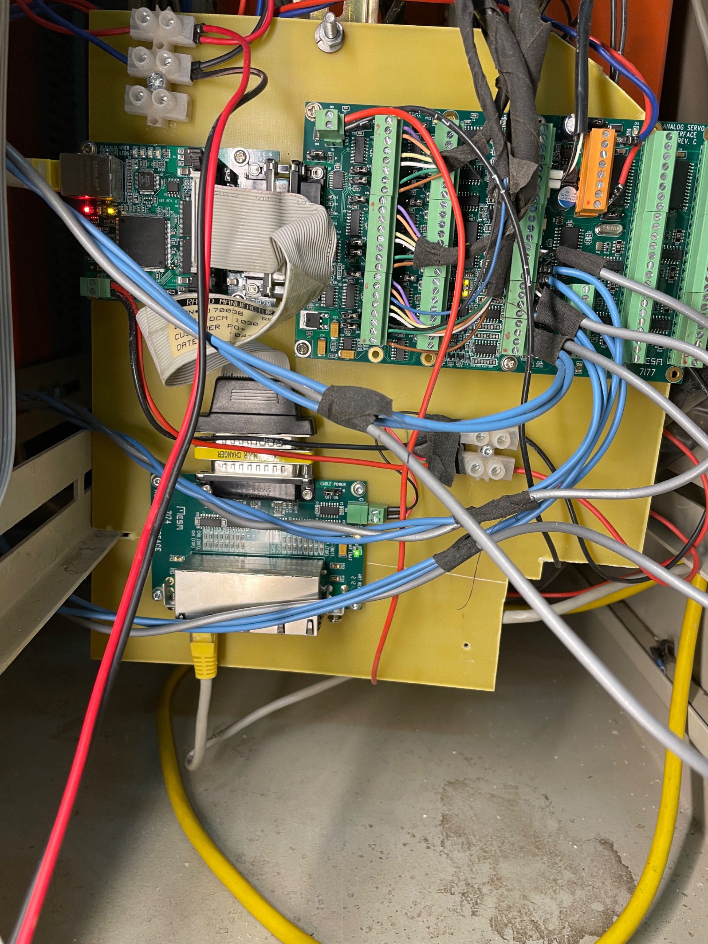

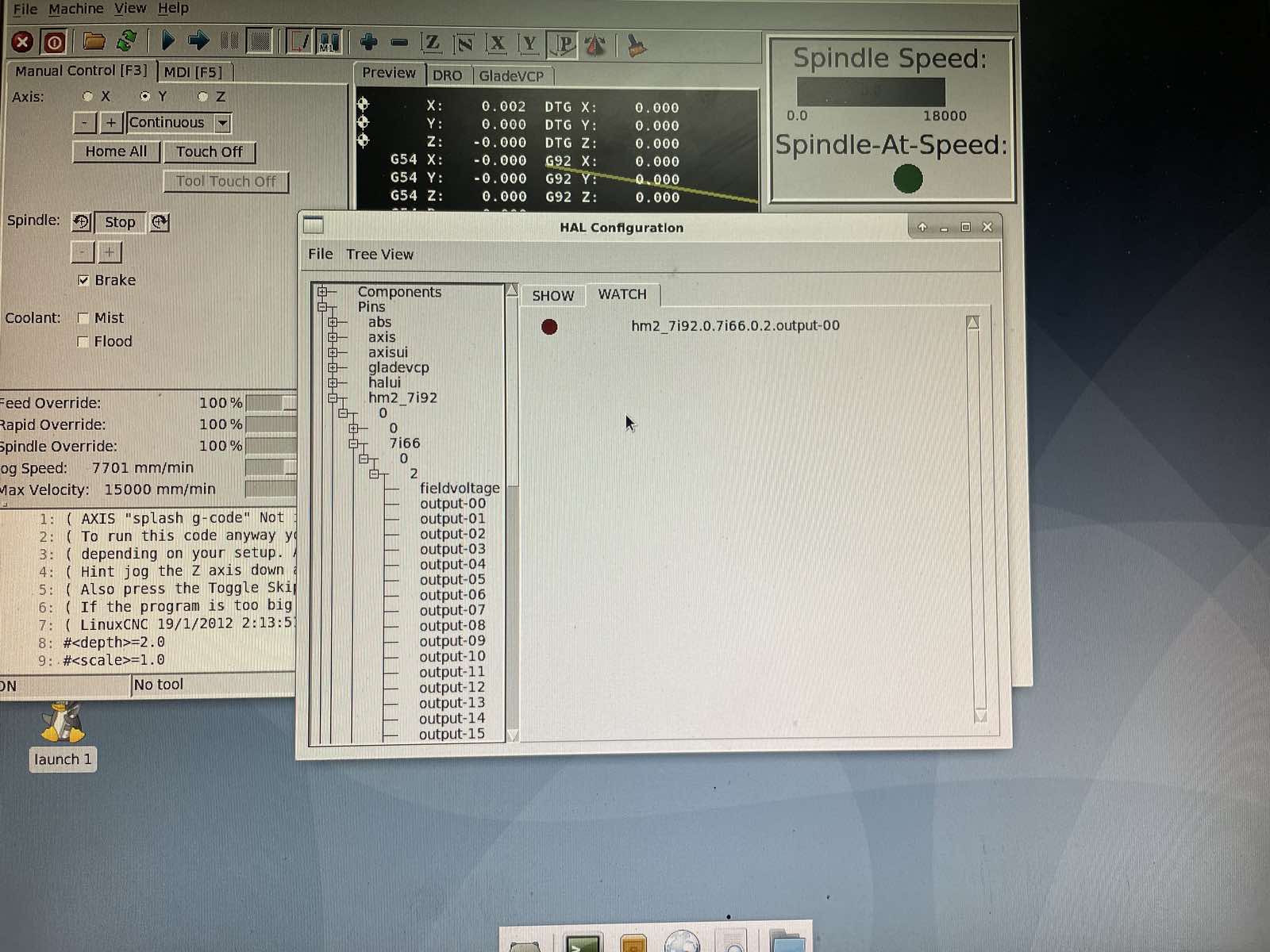

30 Jan 2022 12:40 #233567
Replied by tommylight on topic biesse rover 316 retrofit
PncConf will not help with 7i66, start LinuxCNC and use "show hal configuration" to find the pins.
And do check the red wire on the orange connector on the 7i77, it looks like it is falling out of place.
- Masiwood123
- Posts: 423
- Thank you received: 93
30 Jan 2022 12:45 #233568
by Masiwood123
Replied by Masiwood123 on topic biesse rover 316 retrofit
ok i connect now on sserial on 7i77 as you suggested before direct.. now we will see..( red wire is ok i just bend wire and look like on photo as it’s not connected)..Hvala:)

30 Jan 2022 13:48 #233570
by Masiwood123
- Posts: 22037
- Thank you received: 7505
30 Jan 2022 14:31 #233574
LinuxCNC = Ducati "Virus"
PncConf = bike with training wheels
Make a config that does basic stuff, save a copy, start editing the hal and ini files.
Now you have the pin names so adding them to the hal file and wiring them to solenoids and other stuff is a simple as:
net somesolenoid hm2_7i92.0.7i66.0.2.output-00
or
net machine-is-enabled hm2_7i92.0.7i66.0.2.output-04
or
