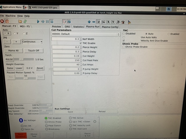

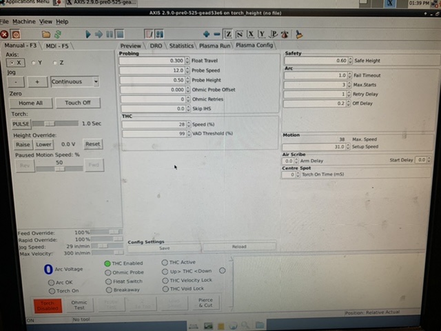

the settings helped it respond quicker now which is good. Now the torch is dancing up and down it cuts but it goes up and down while cutting. Is this cause I am getting moisture in the torch I see the my electrodes get swirly real quick?

Replied by tommylight on topic Machine has been working great but my Proma THC is responding slow when cutting
Lover the thc speed in Linuxcnc. Check the PlasmaC manual.

21 Feb 2020 20:23 #158174
by TexasCNC
Replied by TexasCNC on topic Machine has been working great but my Proma THC is responding slow when cutting
Lower the speed for the THC tab?

22 Feb 2020 02:48 #158180
If using toma_thc config, that setting is on the right side panel, can not recal exact name but the initial value should be 0.200,
Yes, lower the THC speed in the "RUN " tab or panel if you are using PlasmaC.Lower the speed for the THC tab?

22 Feb 2020 18:43 #158261
by TexasCNC
- Posts: 22043
- Thank you received: 7506
23 Feb 2020 03:25 #158285
Those are the same pictures.
The other tab ?
The other tab ?
- phillc54
- Posts: 5711
- Thank you received: 2100
23 Feb 2020 03:44 #158287
by phillc54
Replied by phillc54 on topic Machine has been working great but my Proma THC is responding slow when cutting
On the other thread.
forum.linuxcnc.org/38-general-linuxcnc-q...cuts?start=10#158262
