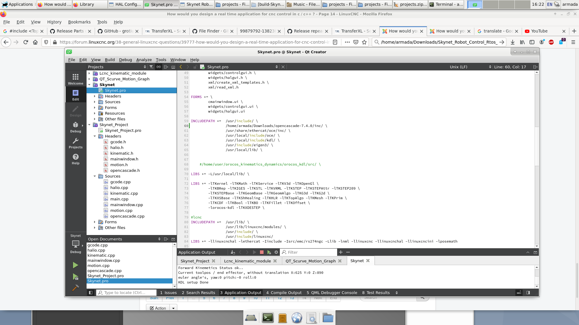

Can you explane step by step. How to run all neened app. I find all source file. But I haven't figured it out yet.
- Grotius
- Posts: 2419
- Thank you received: 2349
30 Mar 2021 08:31 - 30 Mar 2021 08:38 #204121
by Grotius
Replied by Grotius on topic How would you design a real time application for cnc control in c / c++ ???
You download and upzip. Load the project .pro file in Qt and compile.
It will run after compiling.
All apps have the same kdl and opencascade libs. If one app run's they runn all.
You are able to run skynet.
For other readers a quick start to get the libs : sourceforge.net/projects/skynet-software/

by TheRoslyak
I understand it.
I mean, all files are in different releases. And I haven't figured it out yet.
It would be nice if you collect all the latest modules and make a release.
Every zip files contains a project. It's not that files are spread around.
In other words, finish the project so i can use it. Maybe that is gonna happen, but
i don't know when it's gonna happen.
For now you can collect the most interesting features for yourself.
Some users are only interested in how the opencascade works for example.

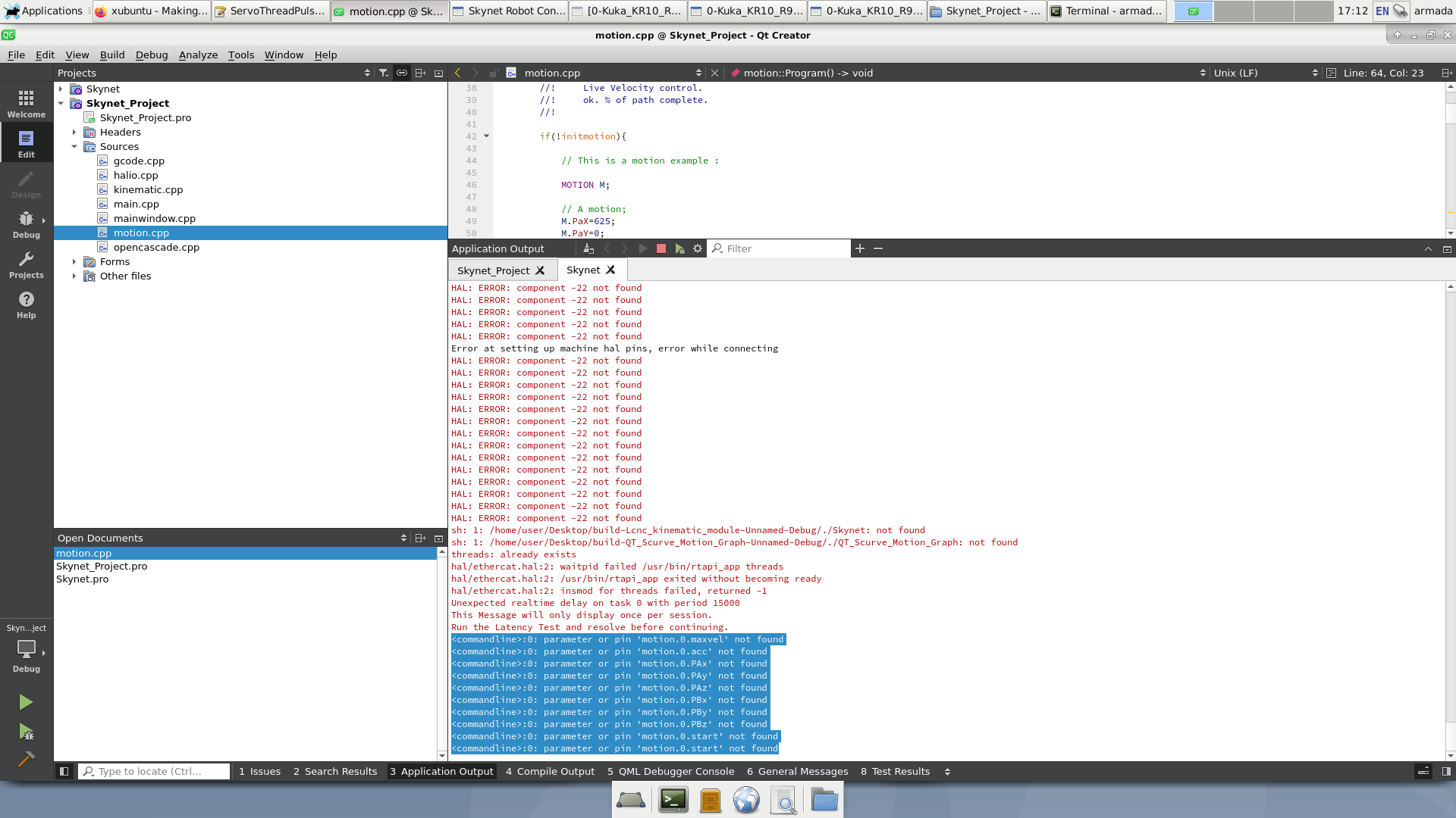

How to run any motion?
UPD I realized varible motion.0.maxvel and other on should be created. I found motion.comp. But how to use it. I have to add and connect these variables to ethercat.hal or something else

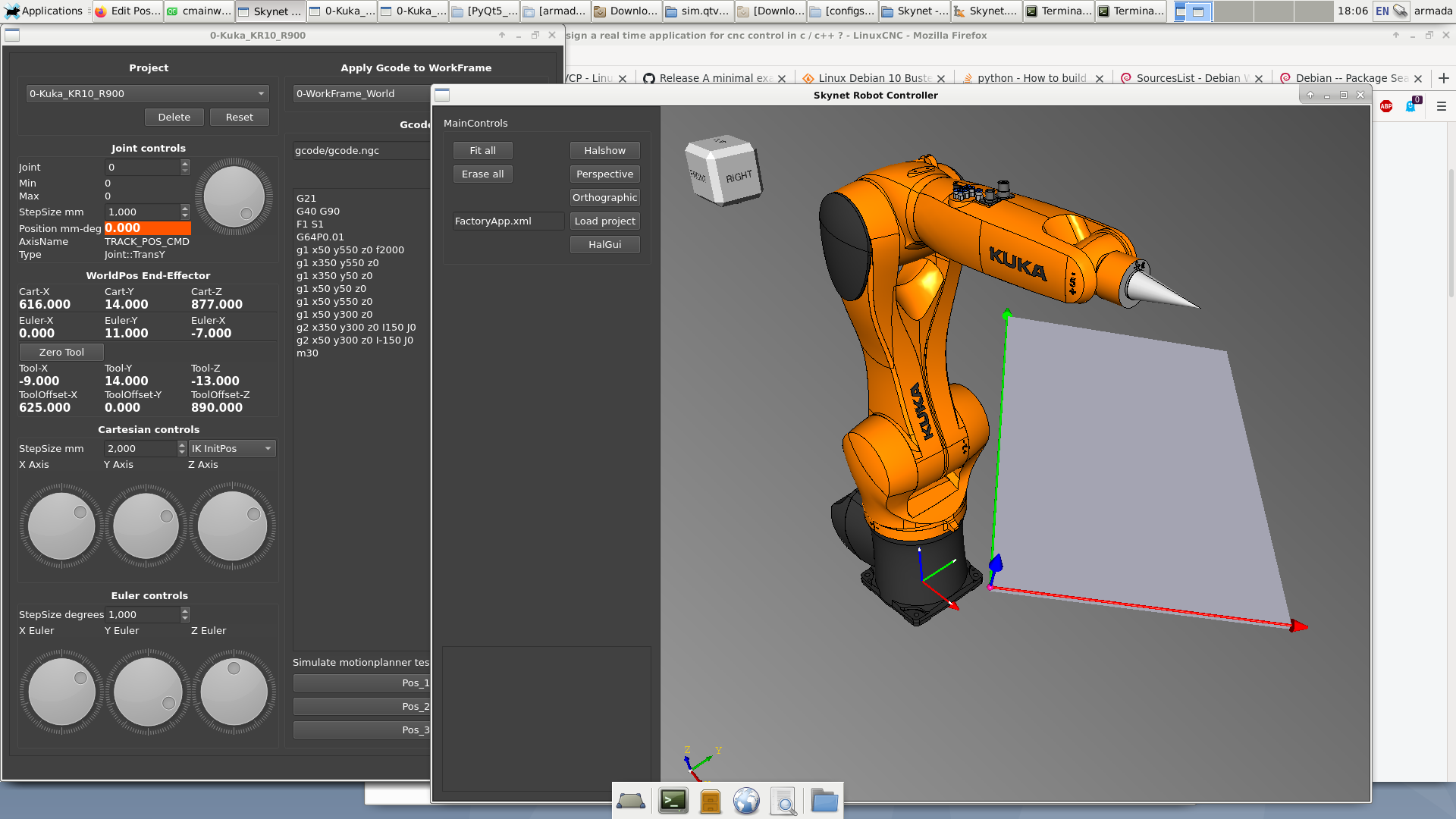

@TheRoslyak
In my example's it sends a float value to the stepgen component.
Maybe you can do that. For motion i used the stepgen component. If i sent a float value for joint 1. The stepgen will move joint 1
to this value including the acc/dcc motion. The stepgen component is like a pid. It's a usefull component even if you don't
use steppers in the real world.
In last example's the robot opencascade preview is updated by the "position feedback". Like encoder feedback of the stepgen component. This is done to give the preview a more realistic preview.
In other words, if you don't connect the stepgen. position feedback to the opencascade hal input, you don't see any motion.
You can shortcut this to connect the opencascade hal to the stepgen position command.

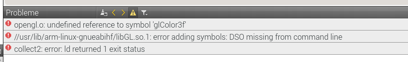

Hi Grotius
Not shure if this is the right plase.
Just send me if I'm wrong here.
Regarding: QT_C++_Linuxcnc_interface_gui
I'm at a RPi4-4G using QtCreator
If I try to build the projrct I downloaded from git
I get these errors.
I get these errors.

I see you use arm. Is the arm compiler set in Qt? It misses parts of could miss the whole the opengl library (links) with your error.
If this opengl error is solved, the next opengl error will appear.
The ld error, maybe add the includepath in the .pro file to your opengl library path.
Includepath += ...
Libs += -GL (i see GL in your error)
In the .pro file there must be a opengl include.
Try this to get running first : github.com/grotius-cnc/QT_opengl
Look in the .pro file for opengl.
QT += core gui opengl svg
unix: LIBS += -lglut -lGLU
And set the compiler to arm.

Hi
finaly it came up.
I had to add :
LIBS += -lGLU -lGL
thank's.
One thing though: I think a layout with more then HDMI 1080x1920 is a bit exotic. ( Bigger is Better ? LOL.)
finaly it came up.
I had to add :
LIBS += -lGLU -lGL
thank's.
