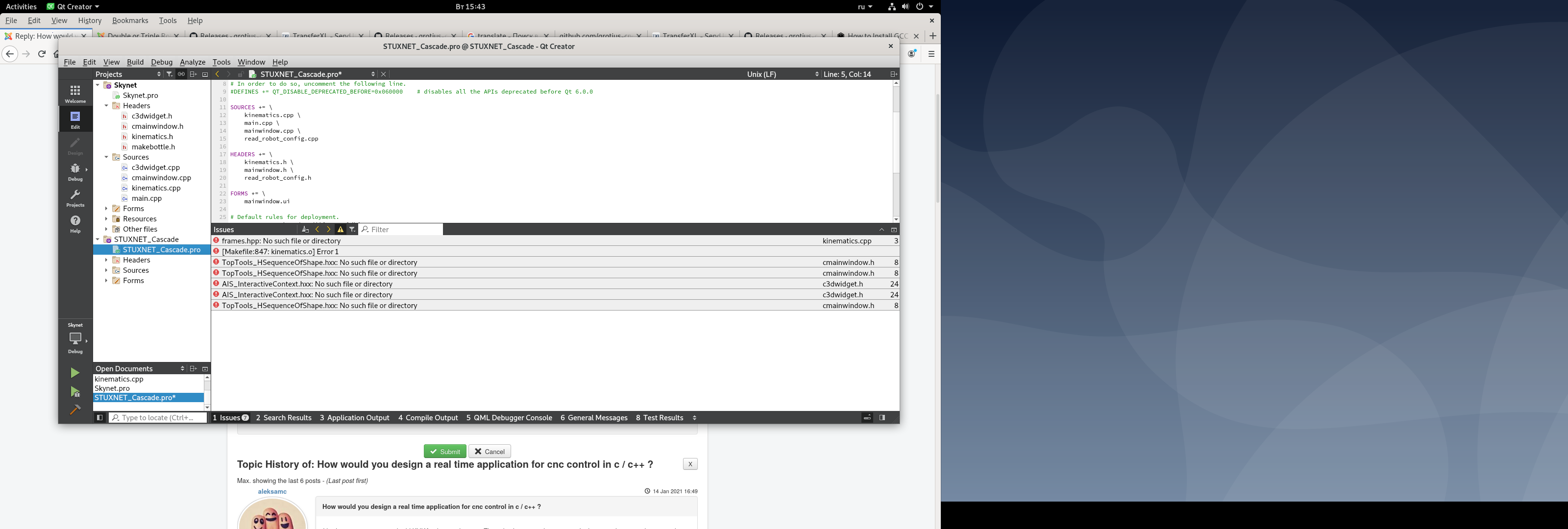

09 Jan 2021 07:11 - 09 Jan 2021 07:11 #194588 by Aciera
So, I've downloaded this again: github.com/grotius-cnc/Skynet_Robot_Cont.../releases/tag/1.0.15
And have been able to build it in QT without error when I run it the gui starts but as soon a I click on "load robot model" or "reset joints" the gui crashes with error .."/skynet crashed".
The problem of being able to switch between trivial and coordinated kinematics using KDL will also need to be adressed.
Just give me a detailled practical example of the problem. Then i can think about it.
Well, the problem is the math involved in the inverse kinematics. All known kinematics for serial manipulators and many others suffer from singularities where the results become infinite for certain values (See also "gimbal lock"). This effectively means that it is necessary to be able to use coordinated moves (using the non-trivial kinematics of say the KDL library) AND Joint moves (using trivial kinematics) that directly use joint angles in the "gcode". In LCNC I can use dewey garretts "switchkins"-branch to do just that: switch between "trivkins" and "genserkins" inside a gcode programm.
For this reason I had hoped it would be possible to wrap the access to the KDL kinematic library inside a modified LCNC-kinematics file. So instead of doing the forward and inverse kinematic calculations inside the C code of the kinematics file it would be piped through another file using the KDL library.
As I'm not a programmer I have no idea if this is totally ridiculous but it seems the easiest approach to me.
