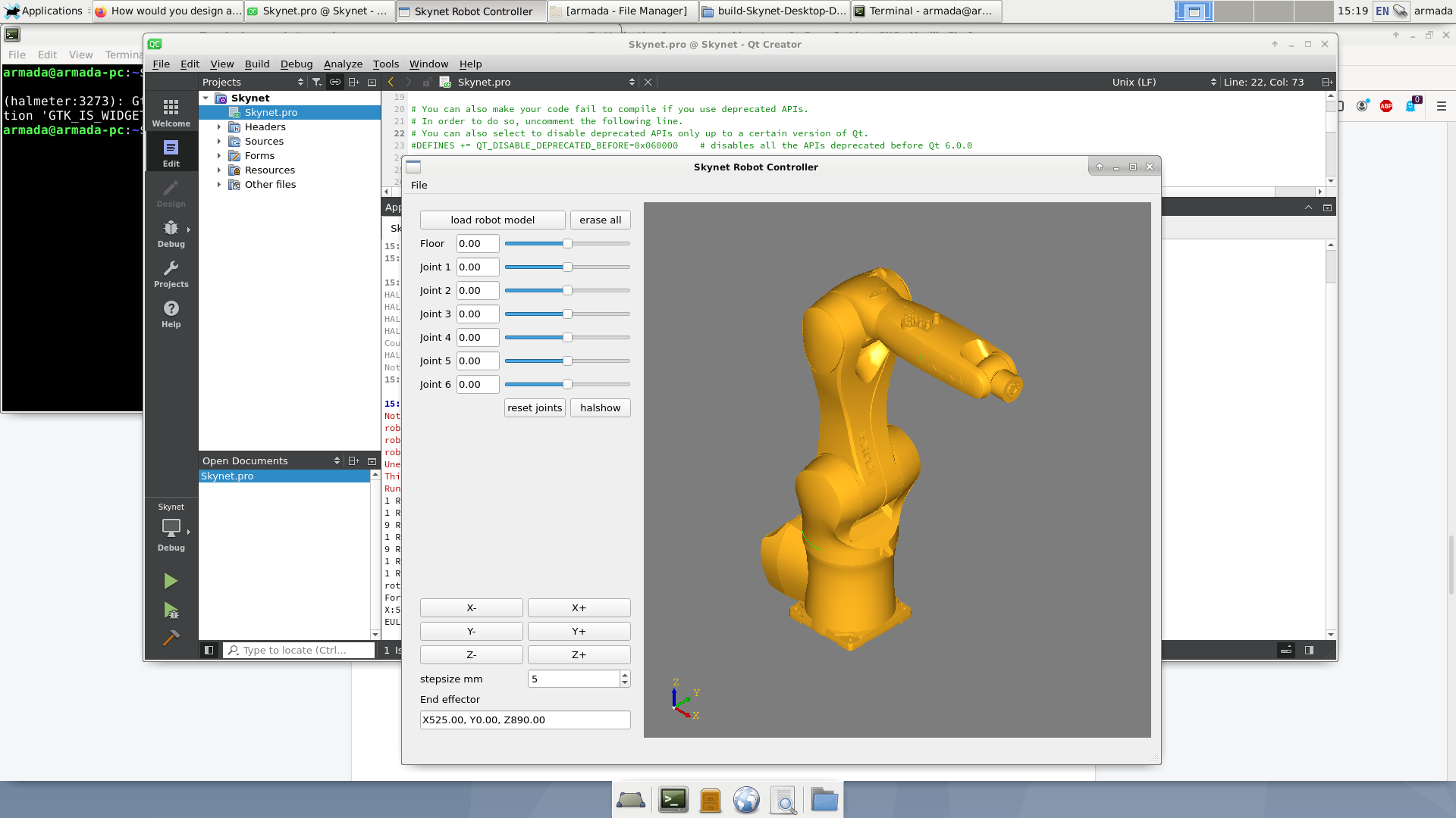

Hi everybody.
I'm ashamed of Grotius leading a topic on the forum forum.linuxcnc.org/27-driver-boards/4031...on-ethercat?start=40
And he gave me a link to his project and I try to build them.
I settled on an error. But "iso live-image-amd64.hybrid.iso, 3.275Gb" is broken.
Can you give me this iso or give advise to fix it?
Hi everybody.

I managed to build my own program. But I still couldn't start Skynet. All libraries seem to be installed, but some functions do not work

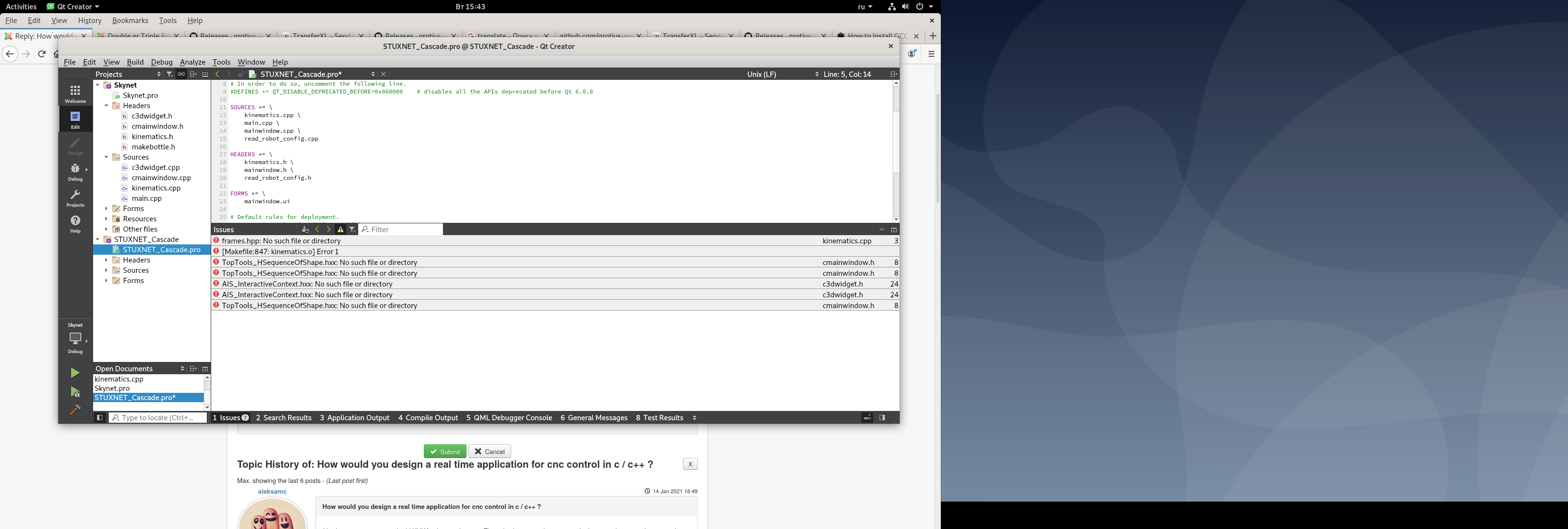

There is still a good iso on github for download. But there is a more recent one that takes some more time to download and
install, but is slighty better :
If you take a look here , you will be able to compile a program.
Take a cup off coffee. It will take some time.
At your previous picture the INCLUDEPATH+= => then the opencascade filepath name looks not right to me.
I think that's all.
At the moment i am building a new iso release for Debian 11 Bullseye. This is not easy, but step by step we go on.
There is a bug in the Debian live-build repository system. I finally managed to get a workaround.
I have managed to compile linuxcnc on it. The compile slogan is excluding gtk2. Gtk2 is lost on Debian 11.
Ethercat hg bus is working. Qt works, Opencascade Cad and Kdl Kinematics all work.
I did not get the dpkg-buildpackage program to make a linuxcnc deb package. I tweaked the script a little bit. But not enough.
I think i will make a deb package with another system that does not care about old dependencies, like python2.
And linuxcnc ethercat i have not done. A lot of work to do.
But Debian 11 Bullseye seems to perform slightly better for gaming then Debian 10 buster following a youtube video advice.

Thanks for the answer.
What about
If I comment out this line - it gives errors related to "opencascade".
I will try to install using the "skynet-software" guide and find what I have not installed.
As for the work of "skynet" and "STUXNET_Cascade". I do not understand where the discretization of coordinates occurs. Like it is done on linuxcnc. This is done in the basic soft that I build or should I correctly write * .hal.
What about
I do not think so. I try to use include opencascade 7.4.0 and 7.5.0 it turns out the same error.At your previous picture the INCLUDEPATH+= => then the opencascade filepath name looks not right to me.
I think that's all.

There are differences in the opencascade library's. The one i provided with the distro is tested with the distro. If you install other opencascade libraries or versions you could end up with errors. On github mr. tpaviod is working on the library's.
This distro has is own opencascade library attached in the iso 2 archive. Do not us other libs unless you know what you are doing.
If you can do it in hal by a component, do that.
If you need to do complex coordinate interpolation that needs a extern c++ lib, you can not do this in hal. Then you write it with Qt.
Your motion update time is then slower that when running a hal kernel module.
If you have a machine with a working linuxcnc motion planner, for example deltakins, gensterkins, etc.
You can import the encoder feedback values into a qt application to visualize the current machine position with opencascade cad.

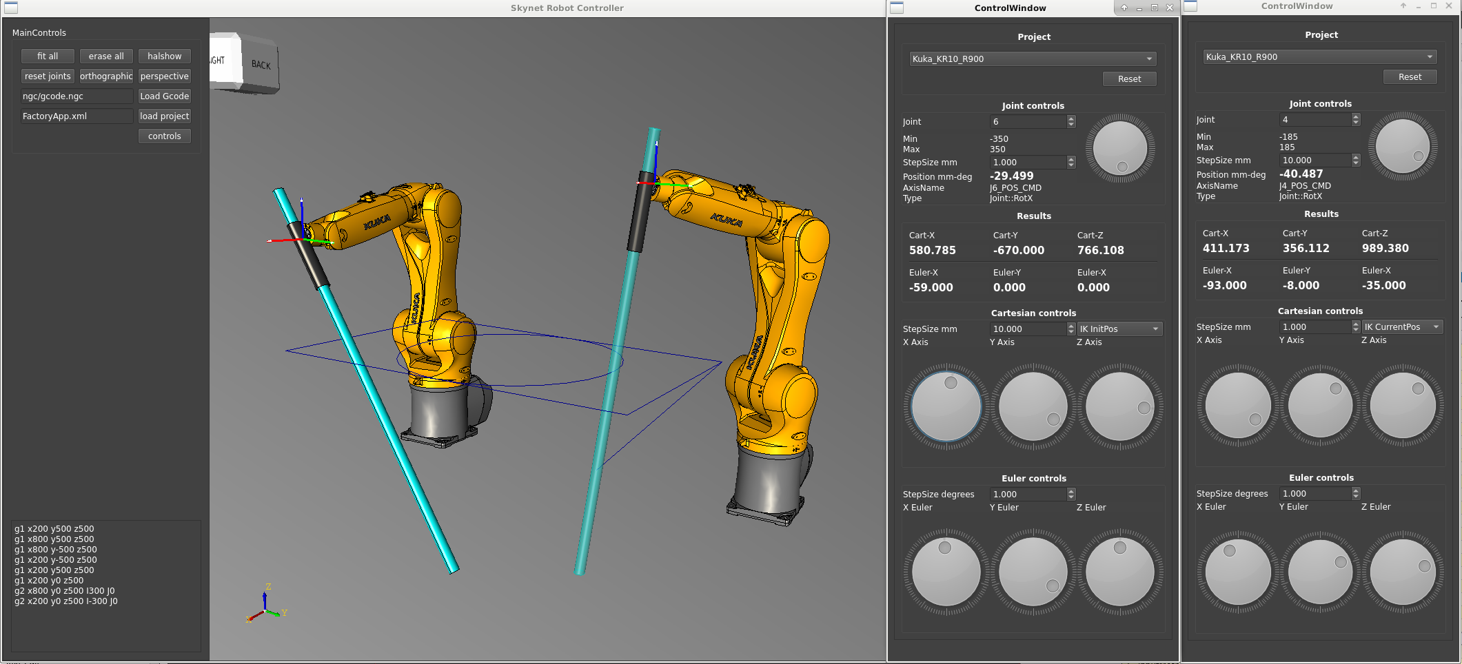

Hi Grotius
I was able to run Skynet . To my disappointment, it turned out to be not quite what you showed in the last pictures.)
If you can to get last version of Skynet (like on 1 pic) I would be thankful
I still do not understand how to start coordinates on RT. May be the latest version has what I need there
That is good new !!
Maybe you missed something no notice.
On the release page, there are about 20 releases.
One of them is your picture. This release can load multiple project's. So you have to load
2 projects in total to get it as the picture shows.
The code for loading multiple projects in the same environment this more complex then the last release. You will see this.
Everything that is loaded is stored in std::vector containers.
Every release has a zip file. Every zip file has different source code.
The containing zip file does (most of the time) match the preview picture of the release.
So you have to search trough the releases, you have to download the zip and see what's in.
About the rt coordinates. The last release is quite small coded (better to understand), but has the best rt performance.
The timer setup is quite different there. It calculates position on the current time. If a cycle takes longer time to calculate,
the steppers seems to perform better this way.
In other examples the rt performance is lower. I tested all the examples with a hardware test setup to see the motor performance.
You mean start the robot to move in automode? In the last release there is a start button wich will execute
a few motion movements. There is been tested with s-curve motion profiles. But still the code is not finished.
There are improvements to do for motor acc-dcc ratio calculations when the robot is doing a G1.
To keep the tcp exact on the path. You will problably not notice this difference by eye. But it is something to mention.
The perfect solution would be bringing the kdl into a kernel module. But that would be much work.
I hope my above comments will help you further in the process.
Load multiple robots :
github.com/grotius-cnc/Skynet_Robot_Cont.../releases/tag/1.0.14
github.com/grotius-cnc/Skynet_Robot_Cont...ad/1.0.14/Skynet.zip
This one is more advanched with workpiece roll pitch yaw.
github.com/grotius-cnc/Skynet_Robot_Cont.../releases/tag/1.0.17
github.com/grotius-cnc/Skynet_Robot_Cont...ad/1.0.17/Skynet.zip
Don't get lost in the code complexity !
