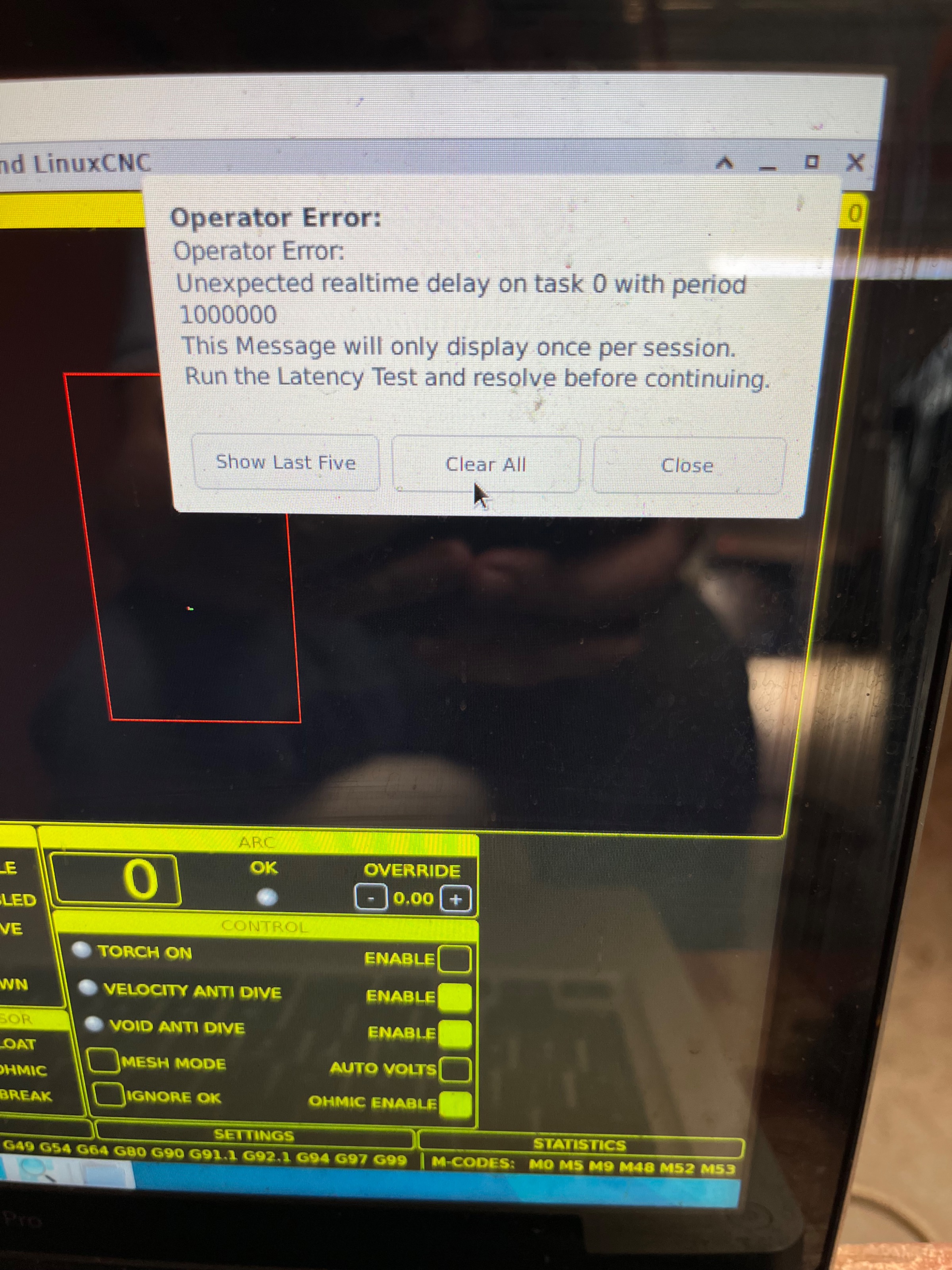

So I upgraded to linuxcnc 2.9 and the error message is back? What can cause this?
- Posts: 22043
- Thank you received: 7506
12 Jan 2025 11:18 #318801
Replied by tommylight on topic Building a chain driven Plasma table.
What error?

12 Jan 2025 17:49 #318833
Replied by PCW on topic Building a chain driven Plasma table.
You likely need to disable IRQ coalescing as described in the hm2_eth manual page
man hm2_eth
man hm2_eth

18 Jan 2025 08:05 #319278
by Creative25
Replied by Creative25 on topic Building a chain driven Plasma table.
I have been busy the last few days.
It looks like IRQ coalescing is disabled by default.
Just reinstalled ethtool.
No error message so far.
Just waiting to see if the error appears at random.

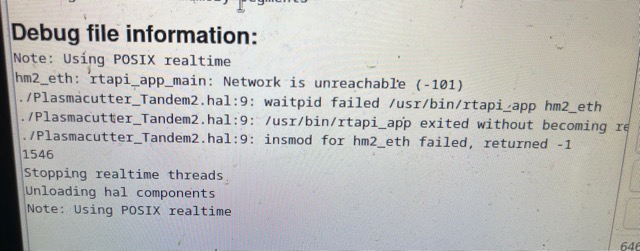

I tried to install tigervnc and it destroyed my system after logingb in with the correct password it just keeps taking me back to the login.So I reinstalled linuxcnc und updated it.now I can not connect to the mesa Ethernet card 7i76Ei get the following error.
Did I do something wrong during installation?
