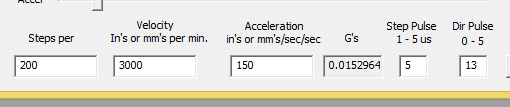

Have been editing a bit between my kindey stone pains, Can somebody have a look if it looks OK now?
Cheers
Bengt
Replied by tecno on topic Time to setup my lathe with 7i76e
Cheers
Bengt

I know nothing about Mach, but it looks like your acceleration and velocity settings are different in your .ini file than the screen dump. Remember that LinuxCNC reports velocity in mm/sec so make sure you convert from mm/min
I'd increase my ini file settings to agree with what you were using in Mach to start with. The 7i76e should be able to let you increase these without loosing steps so you may like to experiment with increasing these values once you have a working system.

Hi Rod, thanks for that one I obliviously missed.
Cheers
Bengt
Cheers
Bengt
