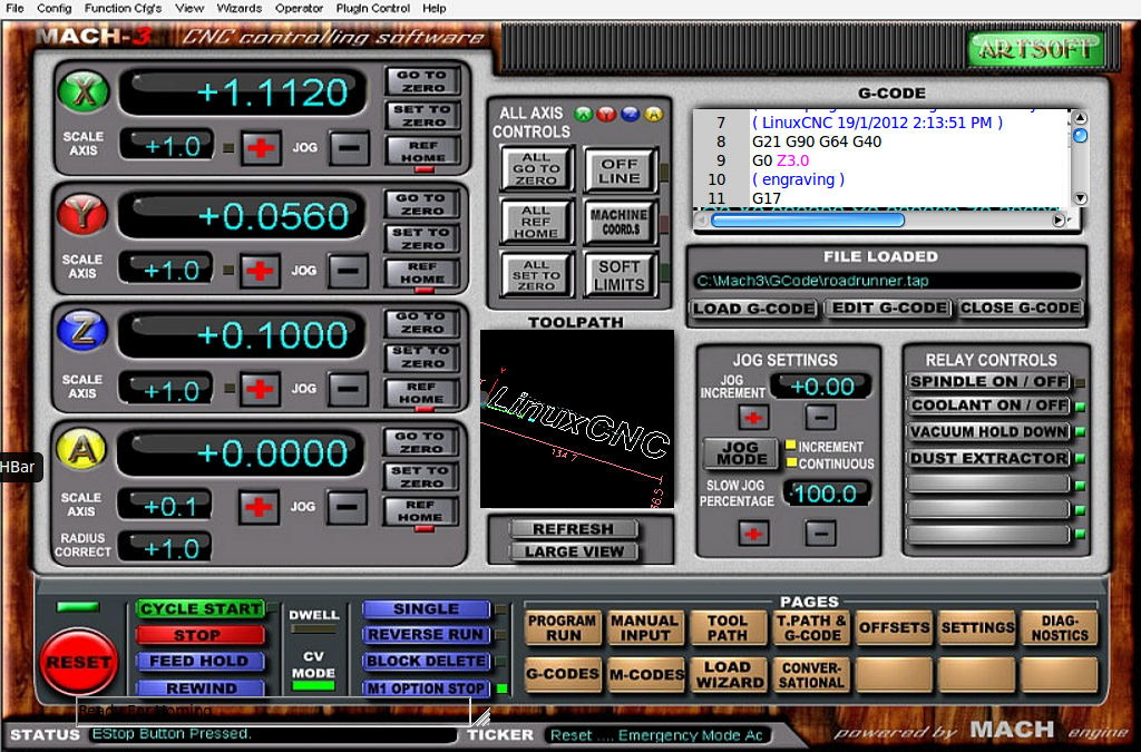

For those who really liked MACH screens ....
I borrowed a screen JPG converted it to a PNG and built a config to show it.
Then placed a graphics plot in the center and a Gcode view in the upper right.
I placed these in the respective places they belonged to in the original screen.
It's a real pain to set up and you can't resize the screen or everything is out of place.
But it shows the power of Gscreen and gladeVCP ...... and Linuxcnc
If anyone happens to build a nice background pic I would consider actually finishing it as a sample.
Replied by cmorley on topic Gscreen - a GTK / Glade / Python based screen

02 Dec 2012 19:20 #27123
by awallin
Replied by awallin on topic Gscreen - a GTK / Glade / Python based screen
why would anyone want a panel that looks like that ?
Two questions:
- can you get a pop-up on-screen keyboard if on a touch-screen the user clicks a text-entry field?
- similarly, can you get a pop-up number-keypad when the user switches focus to a number entry field?
These are ofcourse trivial if you have a keyboard attached, but how does one enter (small amounts of) text and numbers through touchscreen?
Two questions:

03 Dec 2012 00:34 #27127
awallin
Gscreen (actually gladVCP) has a pop up calculator that doubles as a entry widget.
If using a mouse you double click the entry widget if using a touch screen (with the cusor hidden) touch it once.
I didn't build a keyboard widget but I beleive Ubuntu 12.04 has a 'ghosted' keyboard for touch screens built in.
I remember seeing this but have never inverstigated it.
Yes that MACH screen is not for me either, It's the reason I won't bother making it fully functional.
It was the concept of widgets over image that I was interested in. I'm not an artists but if someone comes up with a nice design I will atempt to make it fully functional.
Chris M
Chris M

03 Dec 2012 00:42 #27128
by BigJohnT
Replied by BigJohnT on topic Gscreen - a GTK / Glade / Python based screen
How did you position the widgets?
John
John
- Posts: 7368
- Thank you received: 2181
03 Dec 2012 02:30 #27129
I use 'fixed window' on top of the toplevel window.
This is why you can't resize the screen without the widgets being in the wrong place.
To make this easier I might try building a custom wodget that allows one to load an image on it.
Then I,d have to play with the fixed window widget so the image showed thru....
