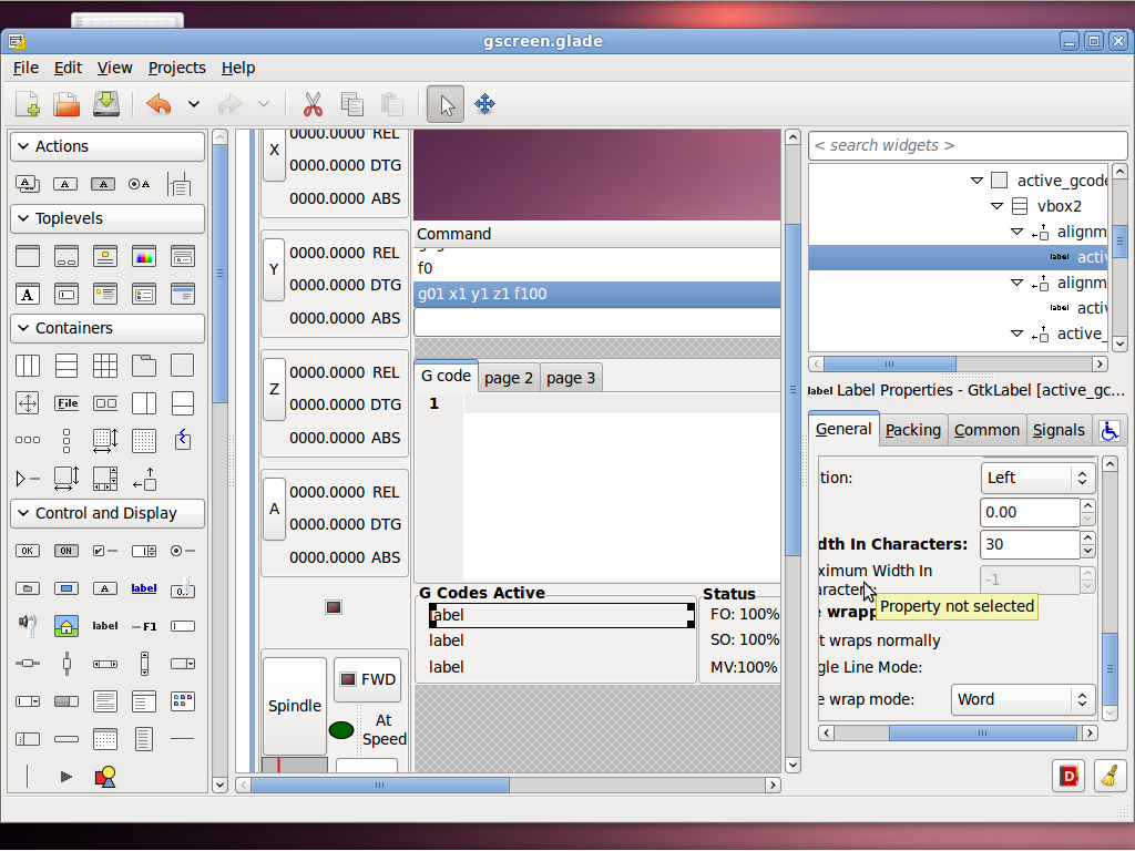

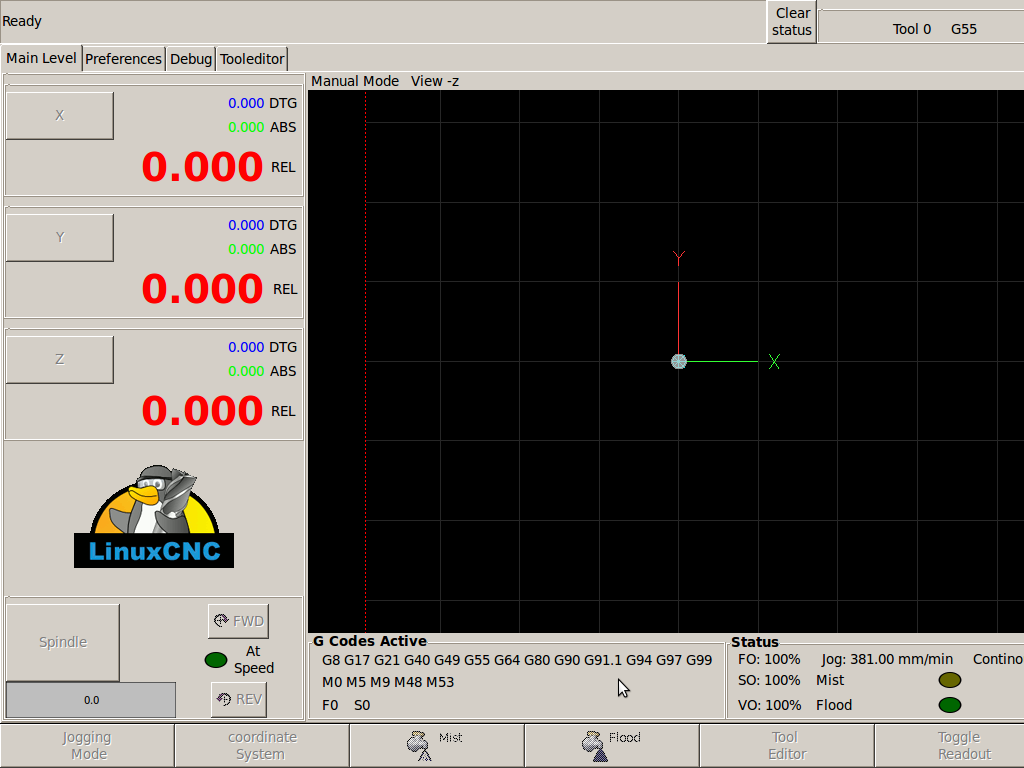

Hi Chris,
the changes are looking good. I am frantically wiring things up so I can use this for real.
This is what the unmodified Gscreen displayed like
You can see the "G Codes Active" make a long line that pushes the right hand side of the screen out of view.
What I changed was the "width in characters" of that box. probably not the correct way of fixing it but it worked
Maybe I have something else set wrong if no one else is having these problems. I am using metric units if that makes a difference.
Thanks for the ongoing efforts.
Jayson.
Jayson.

13 Nov 2012 20:44 #26531
by BigJohnT
Replied by BigJohnT on topic Gscreen - a GTK / Glade / Python based screen
If you set the width to -1 it will float with the screen size. That is one of the annoying things about Glade and Gtk.
John
