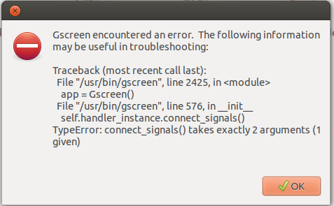

I have installed LinuxCNC and tried gscreen. LinuxCNC will not load for me. I have seen you keyboard and would like to install it on a machine for an operator to use. I am runnig Ubuntu 12.04 I am just running sim.

Paste bin of error
I can load the standard gscreen just not the custom.

hmm how did you get that version? buildbot or did you build from sources?
It's behind be quite a bit..
When did you get it? you need to update it. That version is more then 11 days old. my last commits were about 5 days ago.
Chris M
Chris M

I used buildbot then tryied from source with the help of Kim Kirwin. How do I update?
This is from the termnial afterloading the keyboard:
2012-12-21 08:01:24,162:WARNING:KeyboardSVG: Loading legacy layout format '1.0'. Please consider upgrading to current format '2.1'
I also just had a thought. Can the keyboard buttons use a long press like smart phones and tablets?
Replied by tjamscad on topic Gscreen - a GTK / Glade / Python based screen
Chris M

to upgrade buildbot try this:
open a terminal and type:
sudo apt-get upgrade
It will ask for your password.
I had to do this twice for some reason..
You should see some text as it searches - it may ask about unsigned keys it's ok say yes.
hopefully that upgrades it.
I assume the keyboard did load and work though? Was this with the 12.04 ? I modified a 10.04 version keyboard.
