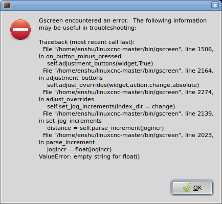

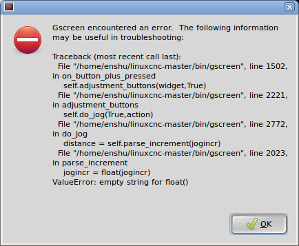

I have gscreen installed on one of our machines. It is not ready for production yet as there are several alarms and errors. It looks as though everything works except the hardbuttons on the control. I plan on building a standard control however this one is not it. The hard Estop button works though which I am happy about. The jog wheel is not functiong and I cant change the jog increments or jog with the incremental touch screen buttons. Postion goto works just fine. feel free to tell me what I dont know

Can you post the INI file.
I bet you didn't add the jog increment entry to the INI (TOUCY doesn't use it)
As for jogging - did you remember to click the on screen button 'jog' to enable jogging?
Chris M

Yes not having something like :
INCREMENTS = .001 in, .01 in, 0.1 in, continuous
under the [DISPLAY] heading will cause the jog increments error. (it should mention the missing entry in the alarm page.)
I will fix it to add sane defaults.
For jogging the button is called 'jogging mode' and you must select an axis as well.
Chris

Yes, I selected the Jog button and the axis.

You are correct once again. No "INCREMENTS" in the ini file.
