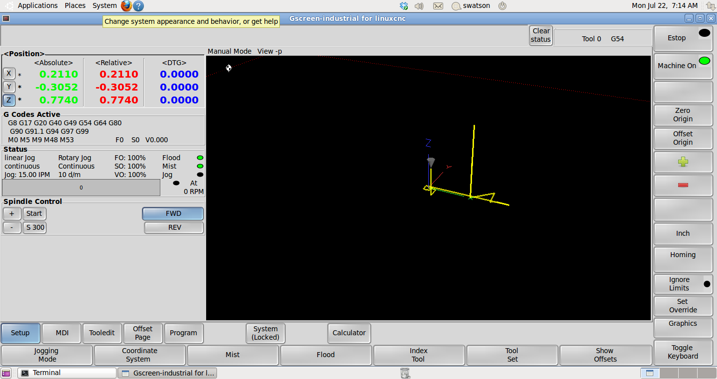

Chris,
I like the keyboard on the bottom but it messed up your status panel. It will also be difficult to get more than 3 axes on there.
Can it be done so that on Setup, MDI and Program it only fills the space under the gremlin view area but still be at the bottom?

Replied by cmorley on topic Gscreen - a GTK / Glade / Python based screen
It didn't - I changed it.
Since you don't want screen controls for the spindle, You could hide that little panel, giving you more room for axes.
You need to do that by editing the glade file.
look for frame5 look under properties/common/visible click no and save.
Now if you do want spindle screen controls....hmm
I'll have to look at the layering of the layout for your other suggestion.
Chris M
Chris M
