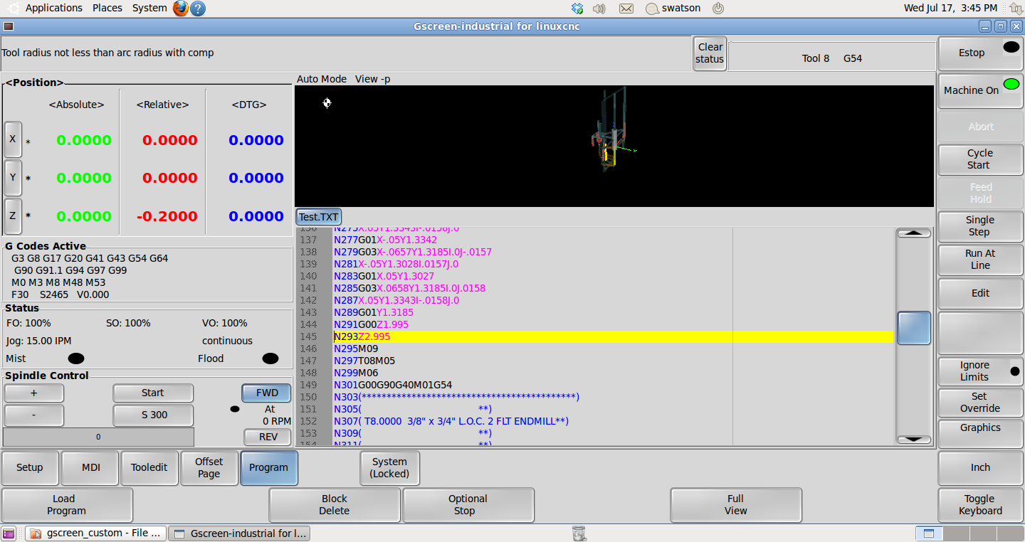

18 Jul 2013 03:37 - 18 Jul 2013 04:16 #36750
by tjamscad
Replied by tjamscad on topic Gscreen - a GTK / Glade / Python based screen

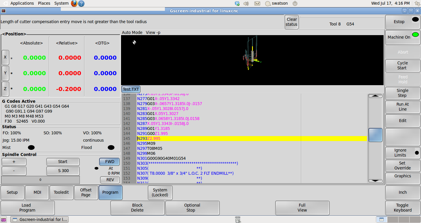

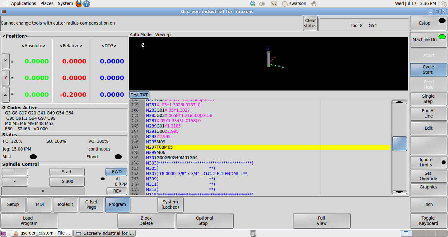

Is this a LinuxCNC message or program alarm?
Last edit: 18 Jul 2013 04:16 by tjamscad.

18 Jul 2013 04:09 #36752
by tjamscad

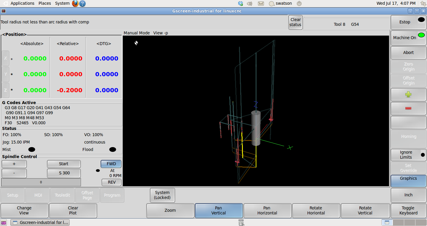

This is why the operators dont like the picture show (gremlen). This is just a small 3 axis part and it already looks like spegitti.

18 Jul 2013 14:40 - 18 Jul 2013 14:41 #36758
Replied by cmorley on topic Gscreen - a GTK / Glade / Python based screen
The pics are linuxcnc showing program errors.
Chris M

- Posts: 7360
- Thank you received: 2173
18 Jul 2013 14:57 #36759
It's possible to turn off different plot options, such as rapid moves etc - might make it easier to see.
probably could get it down to feed moves and current tool position .
Chris M
