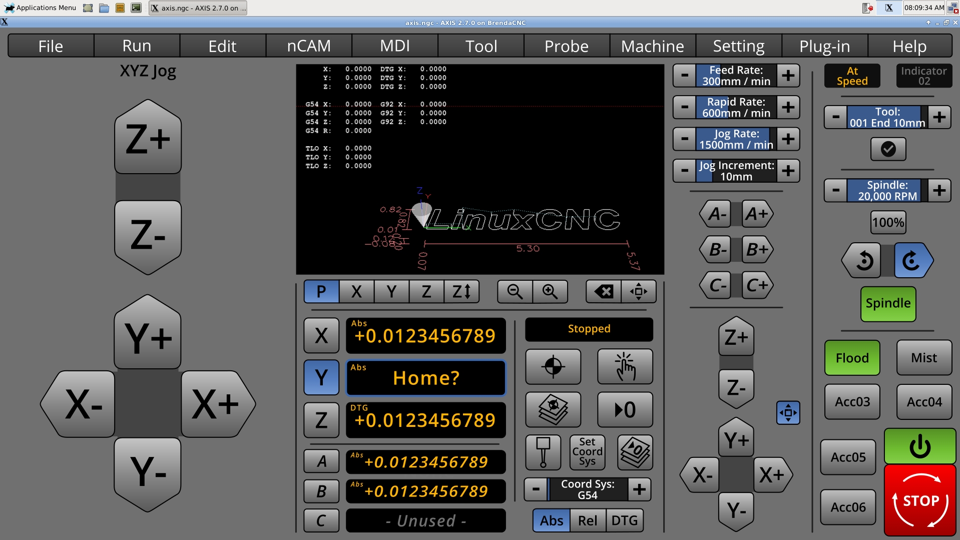

I feel a little bad because while I have the interface roughed out, I still want to have something for the lathe people.
Today, while I had my CNC computer hooked up to a 16x9 monitor, I took a screen shot to see down to the pixel how how much room the XFCE's bar takes up, and how much whatever GTK 1? controls that are on Axis takes up.
Someone has offered to at least help code it; I want to have respect for their time, in that I want to make sure that there isn't a dead end or a situation, where everything has to be moved around.
If you check this thread, you may see that I've only been working on this a few like 3 weeks (May 17th.)
Today, I also got a chance to install NativeCAM. It's great, far exceeding my expectations. It will do at least everything a manual mill DRO can, and much more, which means that the "DRO" menu can just be an extended readout display for jogging, if it even needs to exist at all.
Perhaps I am doing too many update posts. I want feedback.

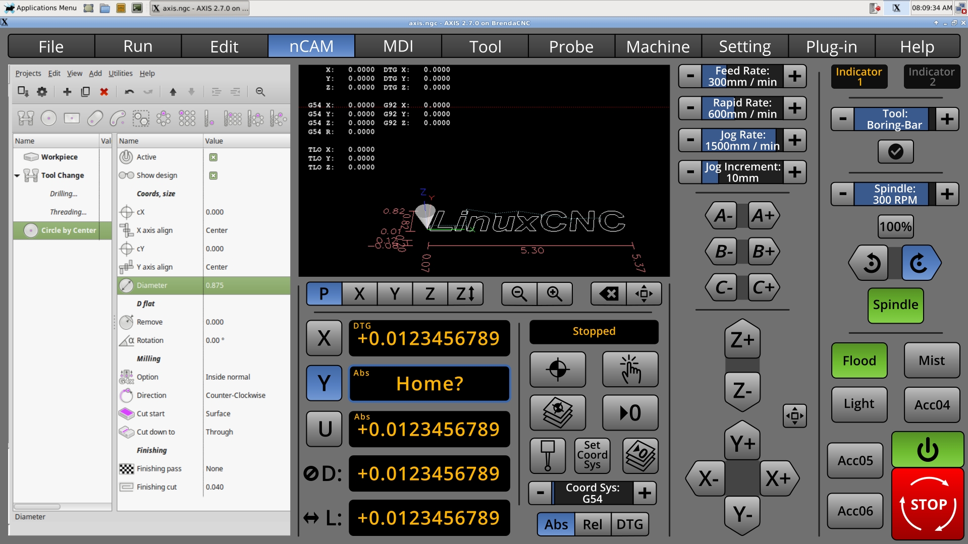

* First Lathe Attempt. I think the readout controls should be modular.
* Showing NativeCAM, which is a pretty long word. For now, I just shortened it to nCAM so it fits. Having tried NativeCAM, I feel that it does what I wanted a DRO tab to do. Perhaps the control color scheme could be made to match. I've tried making the main command bar light, like Native CAM, but it I feel it's hard to concentrate at the rest of the interface.
Perhaps someday, there could be a button in Nativecam, which make it expand and take up the left and center panel areas.
* Added Abs, Rel, DTG indicators. Earlier versions had these. They have returned out of safety considerations.
I've not known what to do with the menubar, whether or not to integrate all of Axis menus, cull them, or compromise, like this.
Most of the other things have changed little, but adjustment and refinement.
I am starting to feel that they general layout will work. I feel that it is a "reasonably workable layout" .
Do you see what you don't see? That crappy XFCE dock thing! I am not sure why they used "Applications Menu" when it's obvious that it's a menu. Just the little cute mouse would have done better. Apple has their little Apple menu. Windows has its Start menu. XFCE has two words.
* Added expand button near jogging controls to make the large like Touchy. Although the toggle button is rather small, pressing it would make the jogging control take up the left 1/3 of the screen. Because I made compromises to accomodate 4-6 axis mills, I wanted to give something back to the people with only 3 axis. Yes, the controls are quite large.

Looking great! Its been a while, but I think I got most of NCAM ported from Gtk2 to Gtk3. If I ever finish that up it would be pretty easy for somebody with CSS skills (i.e. not me!) to theme it so it looks more consistent.

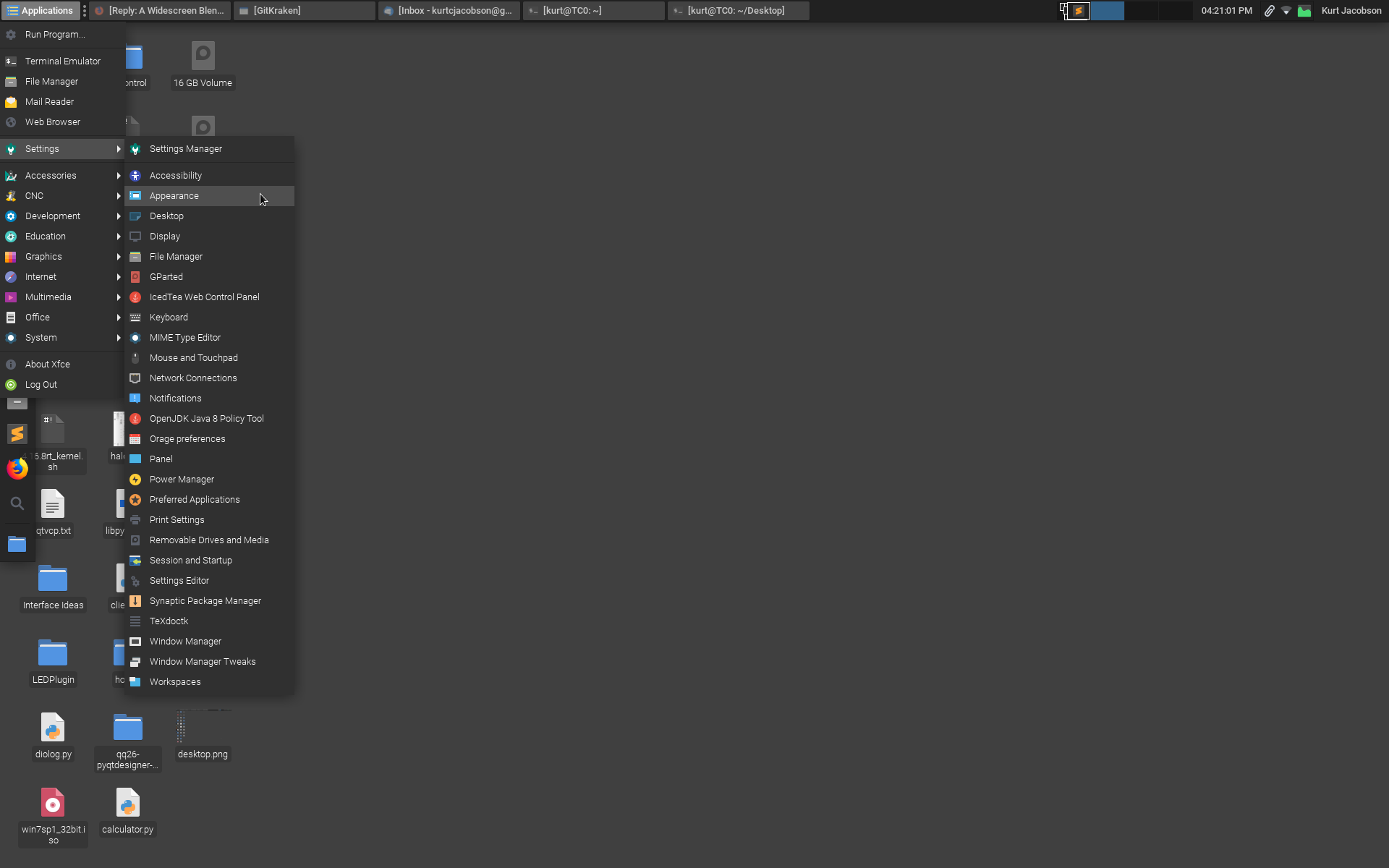

Re: The XFCE dock, panel, whatever you like to call it. It is very easy to customize its appearance however you like. Right click >> Properties and you can set the display text, icon etc. On my CNC machines I have the panel set to auto hide so I have full screen real estate for the UI.

Thank you. The issue is: the dock would have taken up too much screen real-estate. As you know I was pretty upset about it.
I am glad it's easy to disable it, because I am designing the UI without it. In other words, users will have to shut off the dock to use this interface. On a 1920 x 1080 screen you can fit a more than a dozen icons on the upper bar.
The dock wastes too much space, and unlike a Tribble it not only provides no benefit, it doesn't love you.

I like the dark theme : ) I had no idea what NativeCAM was under the hood. It's great. The controls in Axis are often logical, but the widgets are getting on in years, a little small for touch.
My thoughts on colors are:
Red: Trouble
Blue: Choice
Green: On
Amber: Info
I could post a pic of the interface with a white background, but people would be confused that I had lost my way.

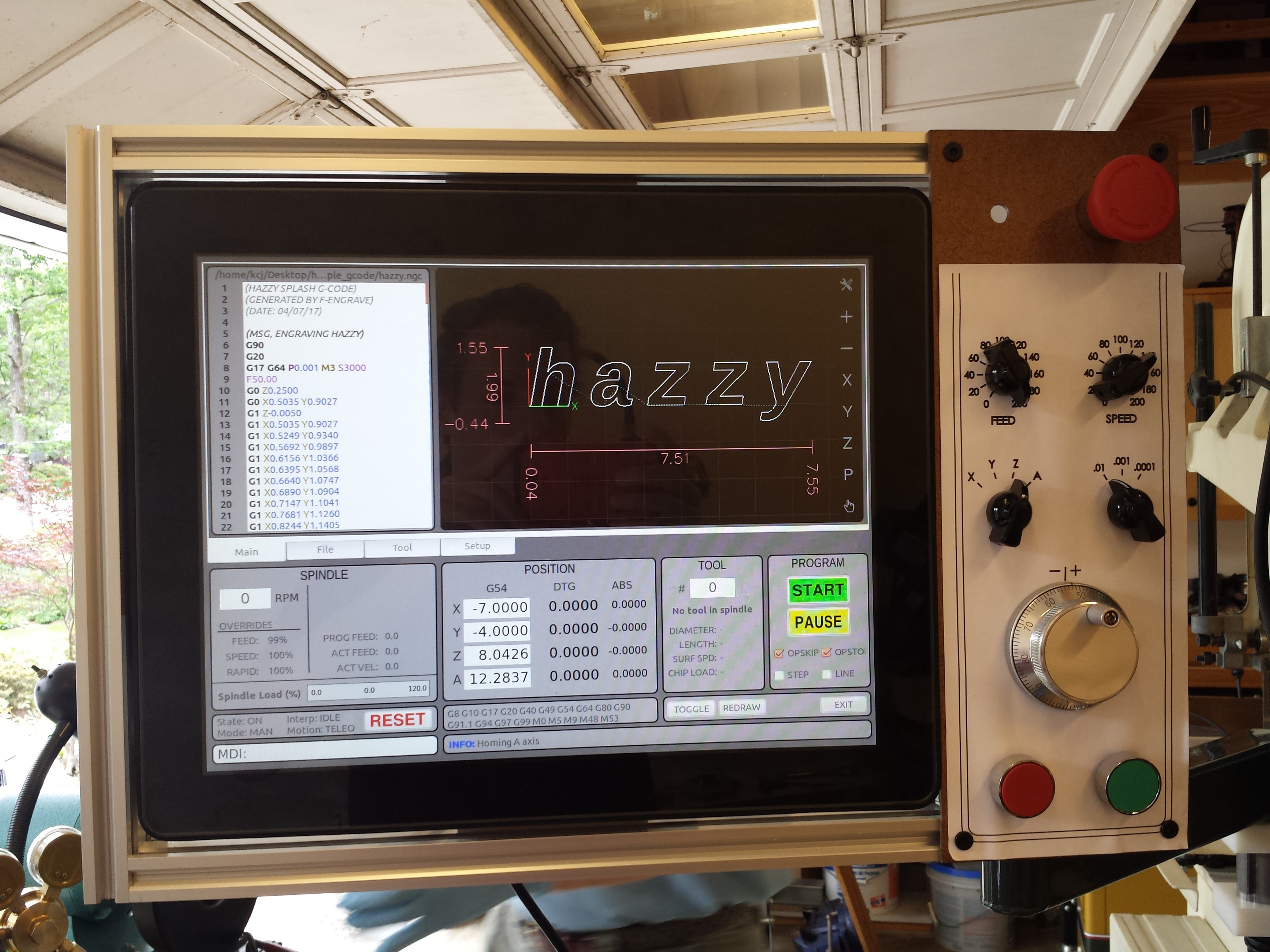

That is how I designed my first interface, the background image was 1024x768px so it filled the entire screen. I did not leave room for window decorations or the panel. I had some code in the init section that would check the screen size, If the screen was 1024x768px it would disable the dock and remove the window decorations (the bar along the top with the title, close/minimize buttons etc.), else it would add window decorations and enable the XFCE panels so it could be moved around.
It seems like you are aware of this, but the disadvantage of using images extensively in a UI is that is becomes non trivial to make the window resizable, but it is possible. It seems easier to do in Qt than in Gtk, though PP is entirely image based and uses Gtk and is resizable. I never could find the code where they resize the bitmaps, but it was not for lack of looking ...

Nice panel!
I like the chicken-head knobs.
You need to send that jog control to me. : )

I think you need to get a lathe. (Everyone needs a lathe, but most don't realise it).
The typical lathe UI needs a left/right Z and an in/out X.
X should show radius or diameter (selectable) but I don't think anyone would complain if there was only diameter.
An optional C display/jog would be cool.
I have said this before, but I will repeat it: Much better to make a great mill/plasma UI and ignore lathes. Then, if you feel the urge, make a great lathe UI. The key to a good lathe UI would be a good preview, that handled both front and back tools at the same time.
