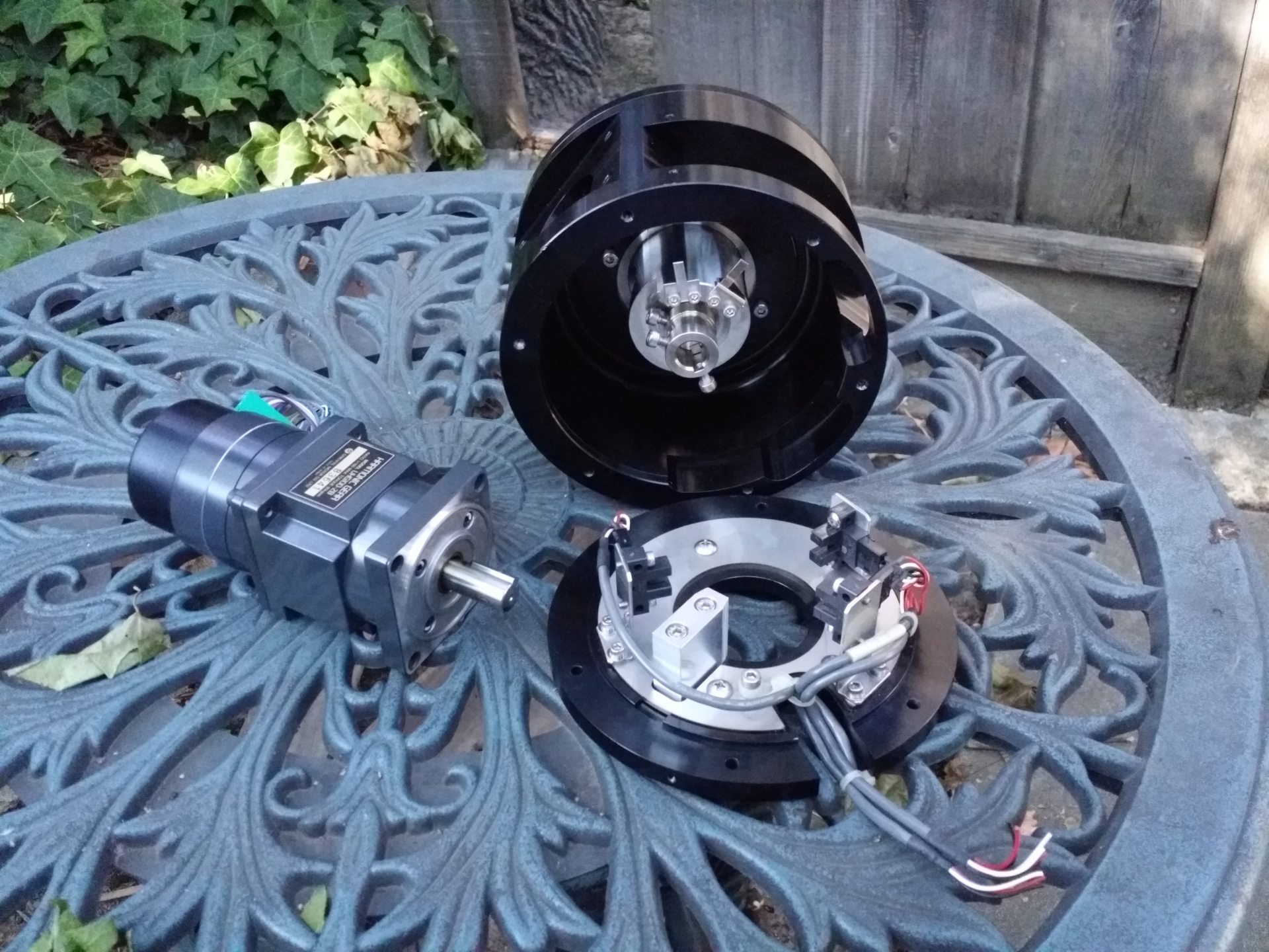

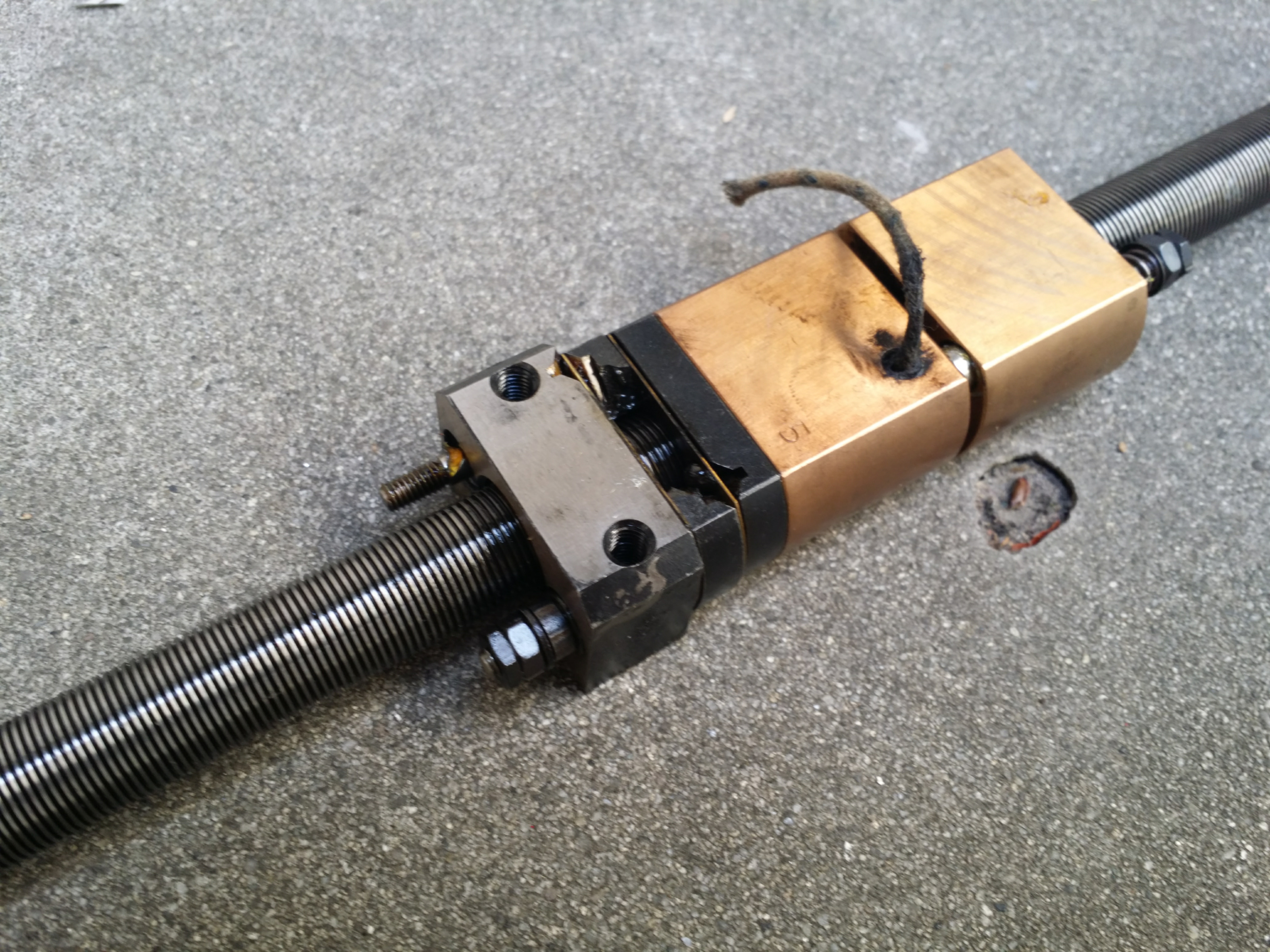

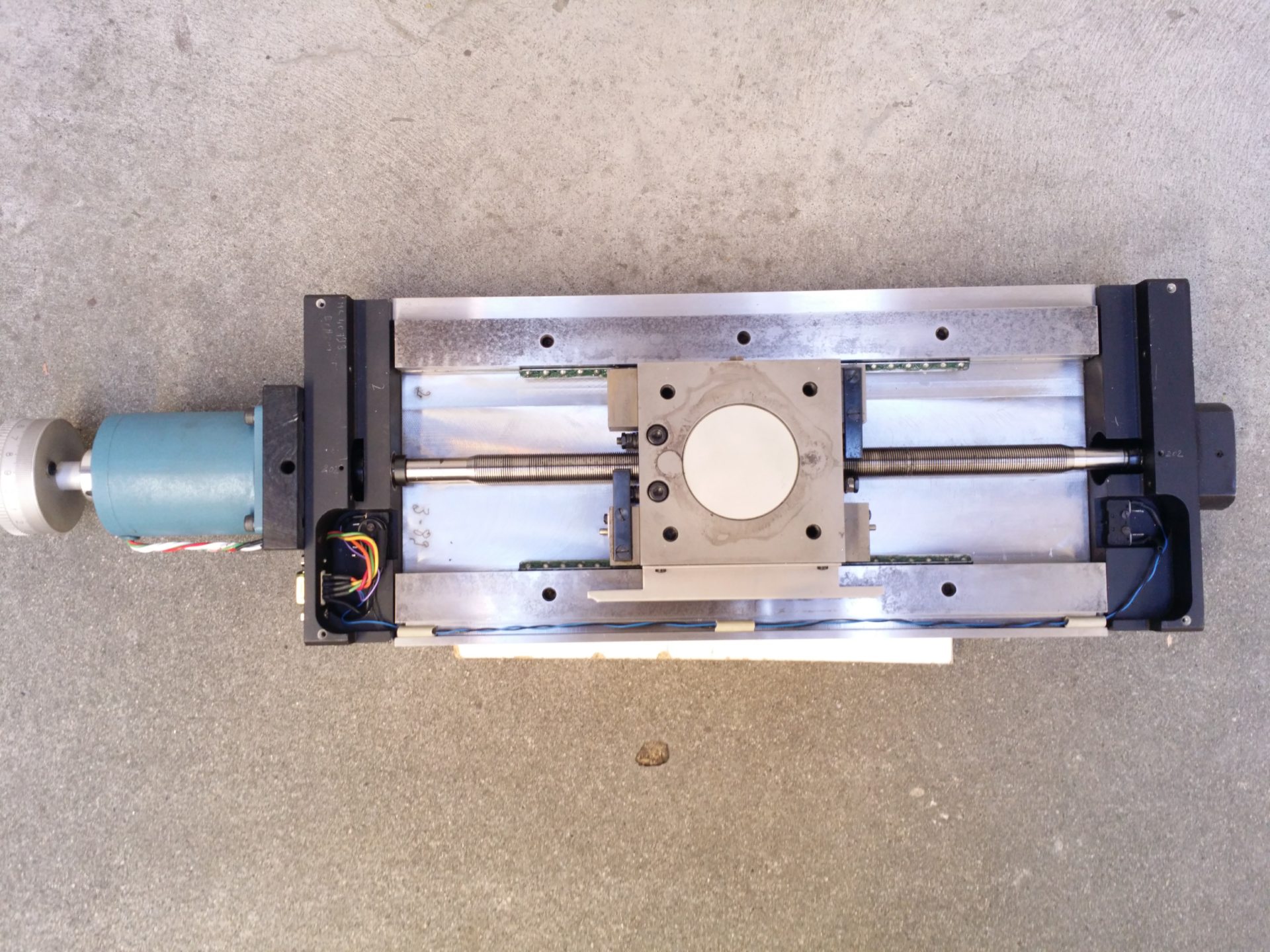

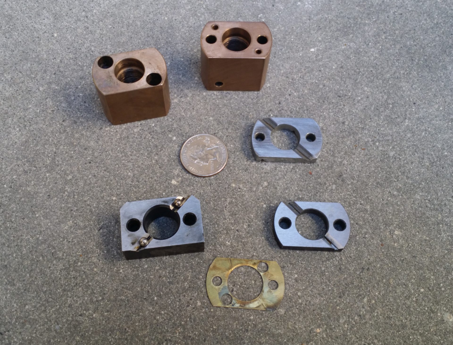

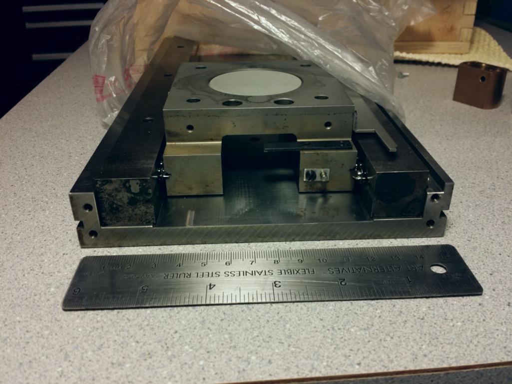

I have 2 axis; they are part of a wafer inspection microscope. The axis was made from ground wireEDM'ed tool steel. Originally the axis had wicks and a tank for lubrication. The leadnut had sliders to decouple its radial motion from its axial motion. In the photo, one of the sliders was broken, so I tried my best to make a new one from oil-hardening tool steel. Still, you can just see the bearings. The axis is stained, but it still seems to work pretty good.
The screw is 1mm.
The original motors were 200 step motors.
The units came with a 4:1 reduction drive.
There was hardware to run this closed-loop with microstepping, with photointeruppters, which were to the best of my recollection 4x.
The unit originally were set up for 0.0003125mm steps, or 0.0000123031(4960629921)".
I dumbed them down a little by installing .36 degree motors to .0001mm without microstepping.
From here, you need piezo manipulators, anti-vibration table, and yes, likely heating.
I also have some harmonic drives which are 50,000 steps per revolution.
From my perspective, there are people on this forum who want me to finish this design. I am time constrained, and I am not sure if truncating the digits will give me a full button width, and I don't know what controls universal to most machines need to go there. Functionally, I don't see a problem with the way it is.
The nail in the coffin is: the digits can't be much taller without hitting the ABS/Rel/DTG indicators, which I feel need to be there for safety.
Or, if you look at pragmatically, if I am designing this interface, would I not also make it inclusive to my needs?
I am looking at time VS benefit, and while you may not see the need for that much accuracy, I don't see the benefit to change it.
I appreciate it being brought to my attention. If I get desperate for space, perhaps I can shave a digit or two off, but it looks like 4 or more digits would have to go for another button row.

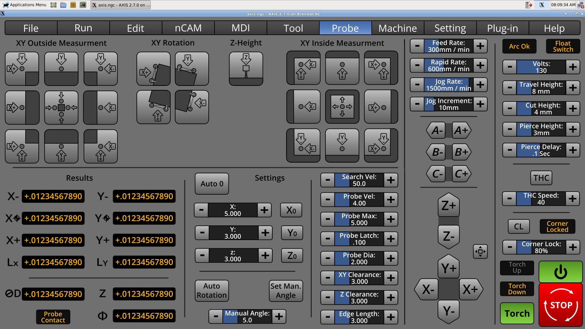

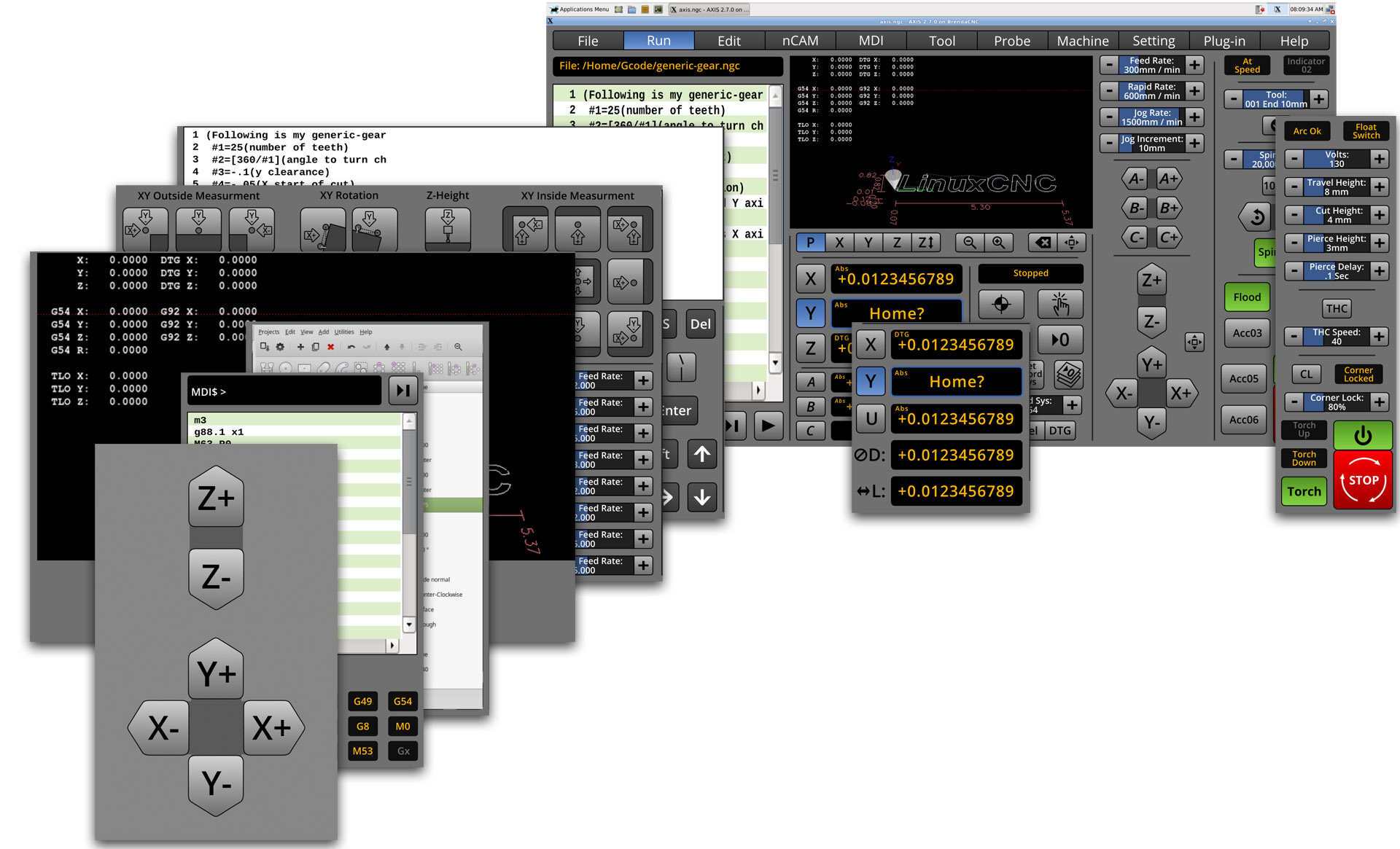

I've had a pretty bad cold, but the probe screen is still progressing. Layout-wise Verser's probe screen was good, but the controls need to fit into 2/3 of the screen, and work for touch.
* The probe symbol is changed mostly to top-downs. My other ones were from the side, but that was confusing once Z axis came into play.
* The arrows and axis letters are integrated to give a good sense of direction.
I don't like cramming all eight settings together like that, but there is not enough width to make another column.

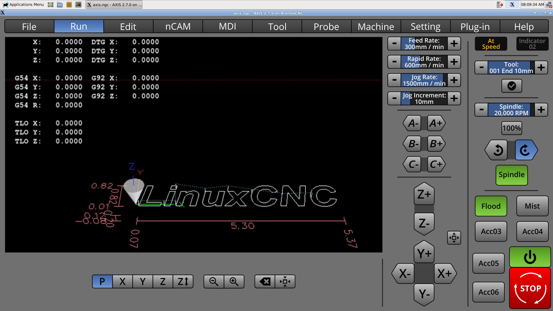

I made an updated collage' showing most of the panels. There are two sizes of left panels; the larger ones also cover the middle portion of the screen as well, but not the jog and machine-specific controls. The left panels are: Run, Edit, Probe, Large-Screen, nCAM, MDI, and Large-Jog. The center overlay hopes to be for a lathe. The right overlay is for a torch.
nCam could have 2 sizes, either taking up just the left, or the left and middle sections, perhaps taking the jog controls as well when the machine is not running.
The lathe controls still need more work, as do the panels for Tool, Machine, Setting, Plugin, but the screen arrangement works fairly well.
It's my hope to get enough together to create a system that other people can add to. The style is still largely Blender (coloring, Axis(vertical), and Gmoccapy(buttons), with a newspaper-like separator strip motif to lead the eye around, and elements from the other interfaces.
I hope there to be an inclusive interface system, just as I hope that LinuxCNC integrates NativeCAM, and the probe screen, whether this is done with the next LinuxCNC release or not.
LOL, I got your big jog buttons right here : )

how can I test this interface?
- BrendaEM
- Posts: 266
- Thank you received: 120
27 Jun 2018 05:54 - 27 Jun 2018 06:00 #112913
by BrendaEM
Replied by BrendaEM on topic A Widescreen Blender-Style Interface
Thank you for the interest.
It has to be programmed first, and well, I need to finish the design before the programming starts, at least as much to make sure the programming effort is efficient. I've been working on this about 5 weeks.
The interface is meant to be very derivative from the other interfaces. I'm just trying to meld together what's already here.
