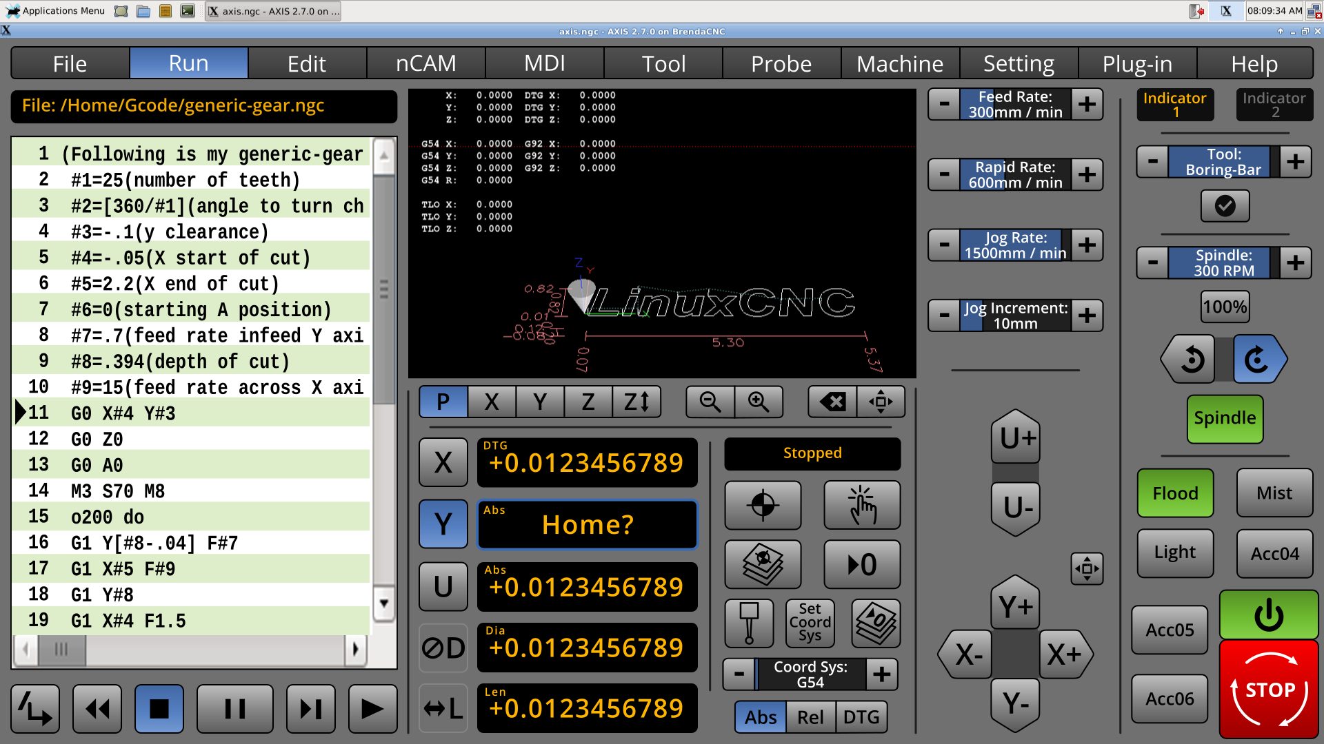

I did test to see what exporting a single button was like. Not bad...though, Inkscape has and issue that I will have to work around: Inkscape cannot stroke objects on the inside of their parameter. So, I guess, I will export each button large, and then 2 smaller sizes from the export.
I am thinking that the buttons, like web graphics, can be exported in 3 states each, up, down, and deactivated(greyed). Supporting touchescreens means no mouseovers.
I have tried to limit the number of button sizes, and control types.
When things get far enough long, I will of-course upload the inkscape .svg file somewhere. Oddly, the inkscape .svg will currently barely fit on this webforum page itself, but it will likely just grow over the limit.
Thank you Chris, still the interface design is built mostly on top of the work that many other people have contributed.

The Inkscape .svg will probably shrink as a plain .svg
SVG is cool! I made a slicer for a 3D printer where the output was an SV G and you could view it layer-by layer in any web browser just by appending slice heights as ?z=nn to the URL.
Annoyingly, I lost the code that did that.
You could potentially make your whole GUI SVG. It would make scaling to different screens easy. (but it would distort). I am pretty sure that SVG can be made "sensitive"
tavmjong.free.fr/INKSCAPE/MANUAL/html/Button.html
Should you? Now that's a different question

I have a problem in that, I see several different axis definitions for lathes. I've read, X,Y,U. I have seen the ways the apron slide across be called Z.
I am not sure what buttons most people will want.
I've noticed that on the probe page that just applying labels to indicators makes it uneasy for the the eye to scan them. Perhaps a lable area thingy can be used, which are lighter than the button perimeters.
BTW, lathe feedback would be appreciated. As with the mill and torch, I am trying to meet most needs, and not be too limiting.

Well, I finally got to run my CNC machine, today. I think that using my machine will make a better interface.
For some reason, I did not find it easy to read the Gcode in Axis.
Aside from layouts, I had a few UI ideas:
- Wordwrap on the gcode editor, that can be toggled.
- Long press/click on the readout to enter a go-to position. Of course it would need an are-you-sure.
- Coordinate systems can have real names, or still use g54....
- Adjusters that can be long-pressed/clicked for entering numerical values like in NativeCam]

Before you spend any more time trying to export images ... I do not think it is a good idea to use images (in any format) for UI elements. It is a nightmare trying to keep up with all the image files for the different states, and if you want to tweak a color (or border width, or .. ) you have to regenerate ALL the files. Also it makes the code much more complicated and less efficient as you have to load and unload the images constantly,
A much better approach is to style widgets. Almost all modern GUI toolkits support styling in one way or another. Both Gtk3 and Qt use a form of CSS, which is easy to use and extremely powerful.
In a few minutes and 40 lines of code, I came pretty close to reproducing your DROs using Qt widgets styled with qss:
Concentrate on the design, that's is clearly where your talent lies. Don't worry too much about the implementation at this point!
Cheers,
Kurt
