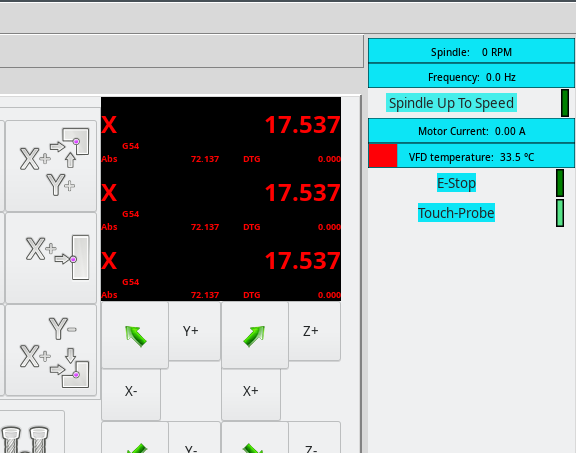

I see other errors - the invalid number of TAB names - if I load my own panel (not a tab) it creates the same error :
[GladeVCP.QTVCP.QT_ISTAT][WARNING] Embedded tab configuration -invalid number of TAB_NAMES vs TAB_LOCATION - guessing default. (qt_istat.py:430)
**** probe_screen GETINIINFO ****
Preference file path: /home/karl/linuxcnc/configs/wells/probe_screen.pref
**** PROBE SCREEN INFO ****
**** To many increments given in INI File for this screen ****
**** Only the first 5 will be reachable through this screen ****
88080387
I don't think the tab names warning is about probe - I see the same error with my glade pannel..
The line that calls probe is:
EMBED_TAB_COMMAND=gladevcp -c probe -x {XID} -u psng/python/probe_screen.py -H psng/psng.hal psng/probe_screen.glade
I'm thinking that a github for your work would make sense - it is possible to put the probe directory in ~/ then just create symbolic links from linuxcnc/configs/machine/ for the python and psng directories.
The Black screen area has X three times instead of X, Y and Z..

I also have warnings about TAB_NAMES vs TAB_LOCATION and currently I'm not sure how to fix that.
I'm not familiar with git/github (locally I'm using svn), and for now the changes are "too experimental" in my opinion to put them there (my own opinion!! - please argue
). On my pc I have a bigger project with machine schematics, etc and one directory is dedicated to complete linuxcnc configuration. This directory is then linked to ~/linuxcnc - similarly for what You said.
In glade file I missed "joint" property for combi_dro widgets, sorry. I must copy/paste something and glade lost it. I would like to add step buttons, as in original code, but need to learn GTK more for this. Anyway here is the hot-fix version, thanks:

28 Jul 2023 22:29 #276493
by lrak
Replied by lrak on topic Work with probe
That worked.
As per github - there are LOTS of projects there that don't work at all. Don't worry about it being 'experimental'. The advantage is you can make it available so more people can easily try it - find bugs - help fix bugs - it gets polished. Software is never finished.
As per glade, I used the new glade interface designer (3.40) just yesterday, seems improved, but couldn't find the GtkHBox widget (I must be missing the way to point to a lib or something changed?) - so I copied and pasted. Have you tried opening probe_screen.glade with the new version? Should make it easy?
