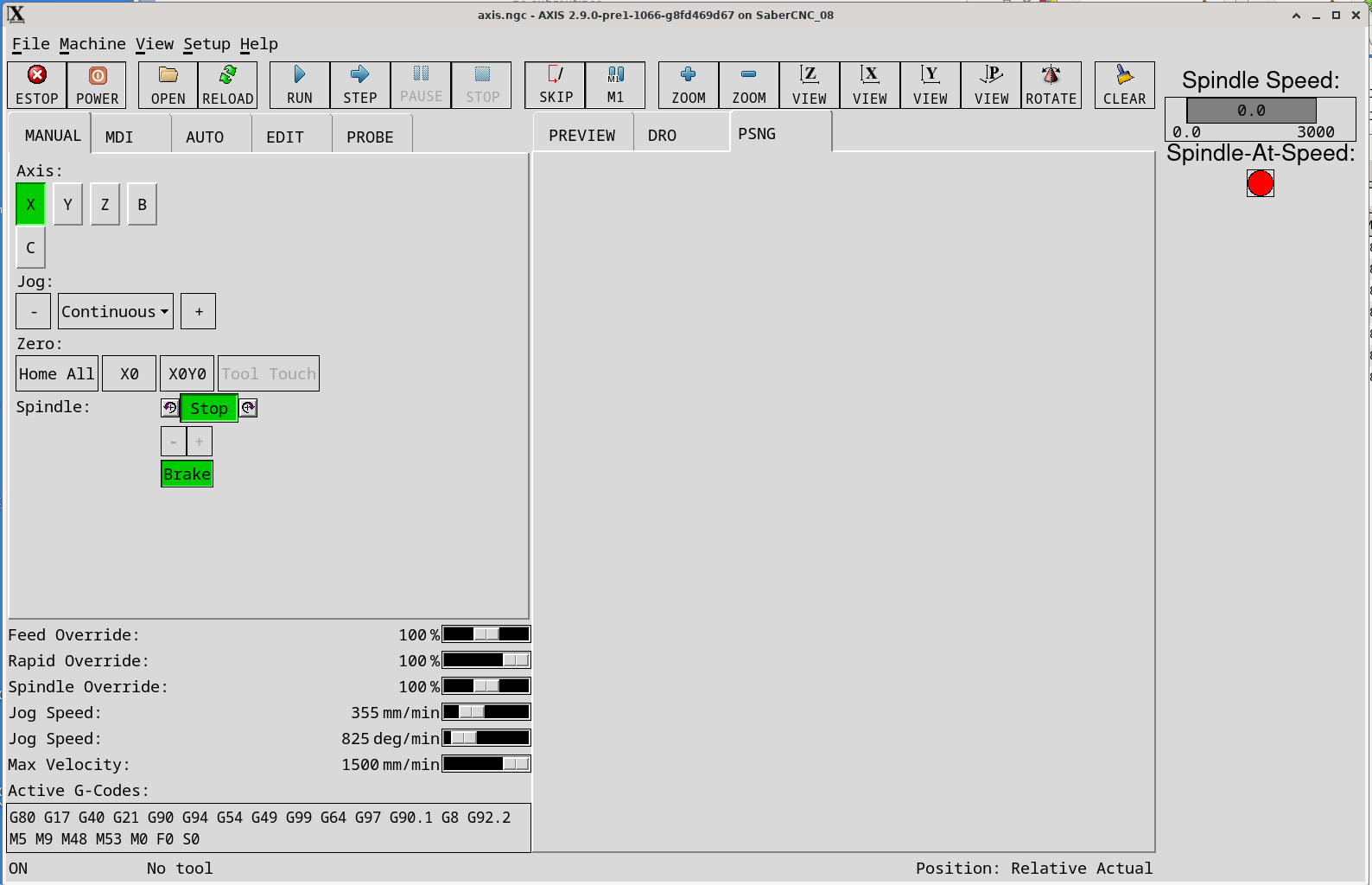

I have tried to install alkabal's PSNG Master, because I'm on 2.9...
Linuxcnc ver: 2.9.0-pre1-1066-g8fd469d67
Linux Bookworm, kernel 6.1.0-11-rt-amd64
I have reached the point of having a blank tab where it says PSNG
I have tried to follow all the instructions as closely as possible. I downloaded from the PSNG_V3 / Master branch on August 10, 2023
Any quick ideas?

Initial fiddling at the .ini file stage suggests that if I remove from the
EMBED_TAB_COMMAND
line the "-H nc_subroutines/psng/psng.hal" part, then at least the graphic displays inside the tab.
So that suggests something in the psng.hal is essentially 'crashing' in a way that disables the gladevcp.
I am too tired now but will try to crawl though that tomorrow.

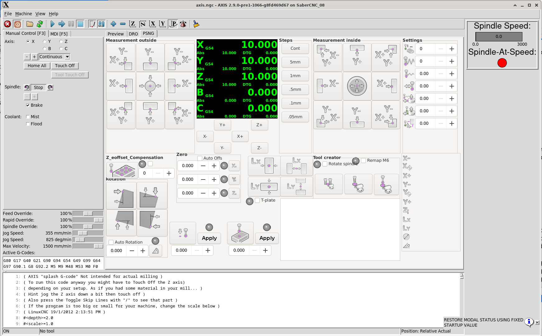

OK, I think I'm making progress.
Yes, I think my surmise that one must include the hal component in the EMBED_TAB_COMMAND is correct, because after using the terminal logging approach, it turns out the error is:
and the line 22 in the hal file is:
And the comment above that is: "Z_EOFFSET_COMPENSATION component you need sudo apt-get install python-scipy"
And then sceeerch... I'm on Bookworm, and bookworm has, you guessed it, not python-scipy in the repository.
Fork in the road perhaps... does Precious need Z_EOFFSET_COMPENSATION?? And if Precious does, then where is it, Precious?!?
I've attached Preciouses' terminal log output (go straight to the end) and the psng.hal file that's being fed to the psng_mod.glade.

Doh! There's no python-scipy, but there IS python3-scipy.
But No, once that's installed, the error stays the same.
But Yes, if we change the line to:
loadusr -Wn probe.compensation python3 ./nc_subroutines/psng/python/compensation.py
The errors change and Lo! (choral music plays)
The screen hath appeared.
Testing will have to wait until tomorrow, I've opened an issue on alkabal's project page for PSNG_V3 to alert him to the documentation and changes for Debian 12.
Thank you for everyone being there to let me text out loud while I work this through.
