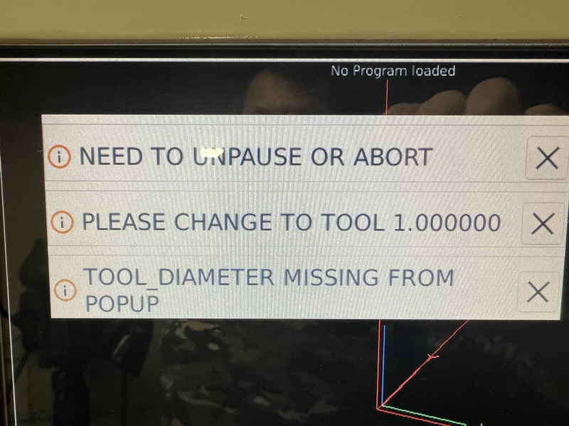

27 Nov 2023 22:49 #286643
by Serg452
Replied by Serg452 on topic Work with probe
installed version V3. The machine goes to the shift place, gives information and that's it, no window for confirmation.
Enter does not help, Esk interrupts the task. Who managed to start this, share the knowledge that you need to click or how to call the window.
And why the tool number with six zeros?
