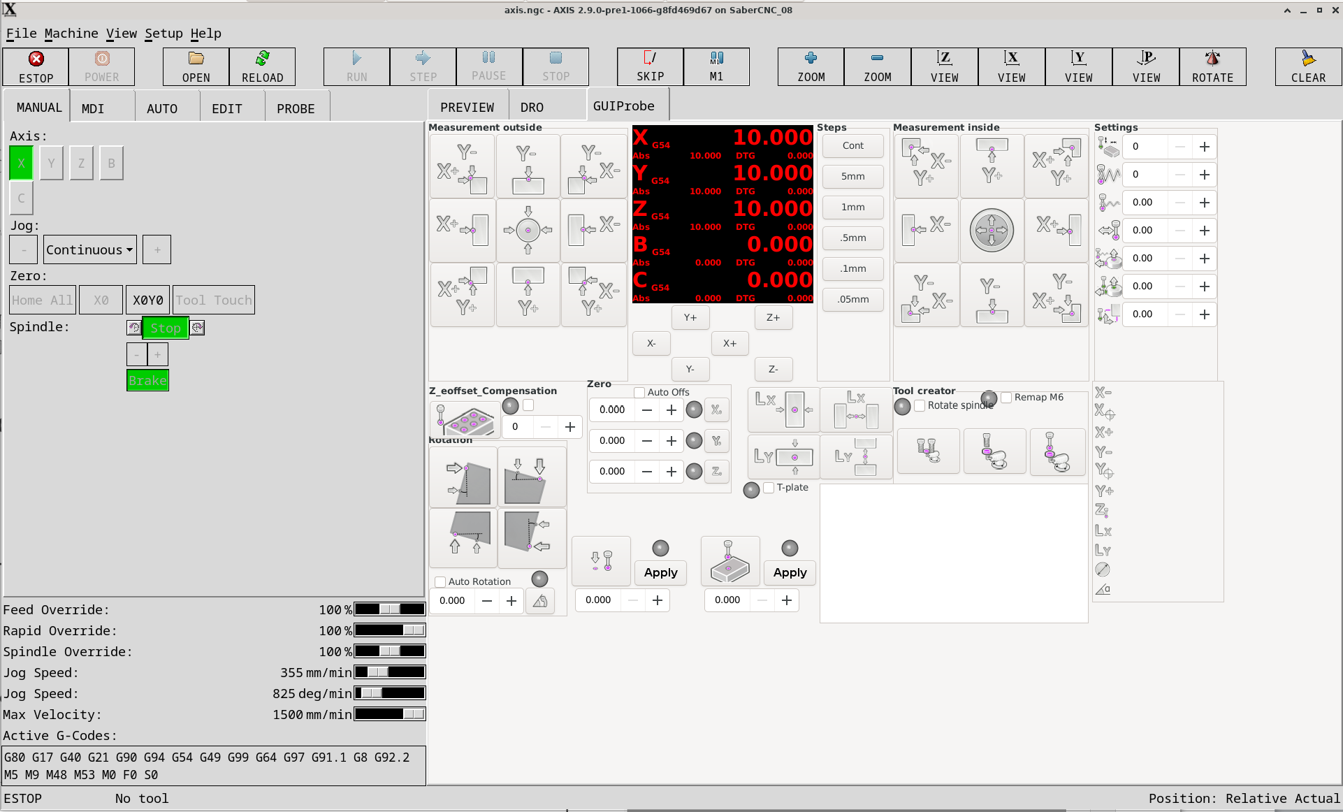

@Vector

Did you see this version? PSNG_V3 ?
Looking at github.com/alkabal/PSNG_V3
It fails - appears to be looking for dynamicZ.so which is not part of linuxcnc-uspace - returns this error:
Read what I wrote more carefully - I pointed you to the python3-fixed code that mwidlow provided. (It is closer to working).
There is a real problem that we have so many forks..
@mwidlow
dynamicZ: dlopen: /usr/lib/linuxcnc/modules/dynamicZ.so: cannot open shared object file: No such file or directory
post-gui-dynamicZ.hal:6: waitpid failed /usr/bin/rtapi_app dynamicZ
post-gui-dynamicZ.hal:6: /usr/bin/rtapi_app exited without becoming ready
post-gui-dynamicZ.hal:6: insmod for dynamicZ failed, returned -1
**** PSNG_V3 INFO Place in table ****
3
**** probe_screen GETINIINFO ****
Preference file path: /home/karl/linuxcnc/configs/wells-probe/wells.pref

15 Aug 2023 00:18 #278014

(To recap, on 2.9.x, on Bookworm, to get PSNG_V3 to install, I believe the only changes needed are to insure python3-scipy is installed and to change the loadusr line in psng.hal to python3 in place of python.)
Which brings us to your errors, Irak....
...in my install, the file your error log shows as missing does exist: /usr/lib/linuxcnc/modules/dynamicZ.so
So what is your version of LinuxCNC and of Linux?

- Posts: 12171
- Thank you received: 4153
16 Aug 2023 02:28 #278107
Replied by rodw on topic Work with probe
I am assuming you are both using the 2.9 getting linuxcnc docs to install Bookworm,
linuxcnc-uspace-dev is built at the same time as linuxcnc-uspace as documented in the building Linuxcnc chapter
it can be installed with: sudo apt install linuxcnc-uspace-dev
It includes development tools that are not required to run linuxcnc
One of those tools is halcompile which is used to compile custom components.
I don't believe dynamicZ.so is part of Linuxcnc. If it was, the man page would be accessible from the main docs page. It probably been created by halcompile from a source file likely called dynamicZ.comp with a command like:
sudo halcompile --install dynamicZ.comp

16 Aug 2023 03:35 #278111
by Vector
Replied by Vector on topic Work with probe
That's It!!! Thank you, thank you!
(Dang, Rod, you're amazing. Hope things are going well.)

And I must've done it without remembering or documenting. Anyhow, Rod's right, I now remember I did run halcompile.
Top of PSNG_V3/Your_Config_Folder/post-gui-dynamicZ.hal; it says:
@Irak, does that help?
And Rod is exactly right, there it is: dynamicZ.comp right there in that folder
(And being in the mod, of course, it couldn't be found even when searching for just dynamicZ in the linuxcnc files)
