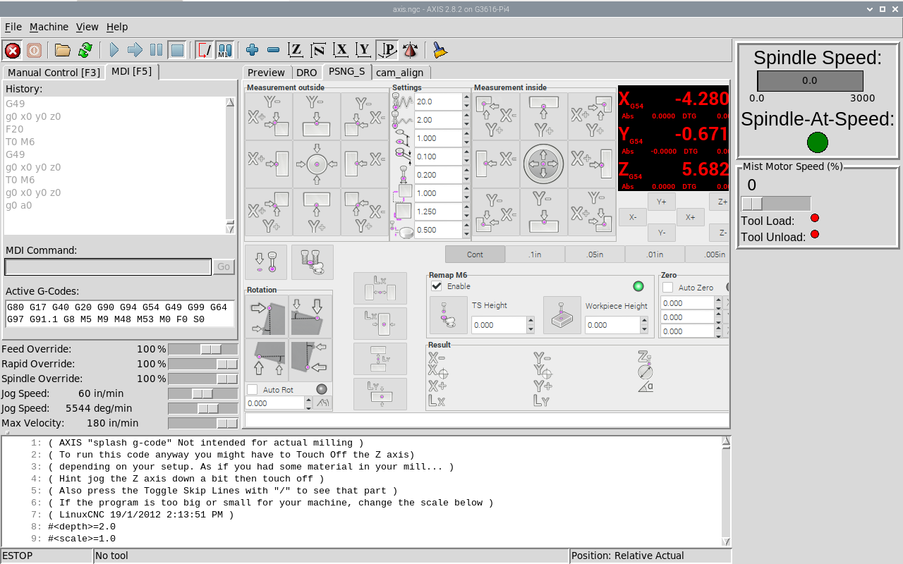

The problem isn't fixes as much as a different approach to using the system. I don't want to measure every tool since the TTS allows me to have pre-measured tools in the tool table. And only if the tool table length is zero use the tool height sensor.
And for measuring tools I'd rather see the screen have a measure tool button which then inserts the measured value, not relative to the workpiece, but absolute value, into the tool table.
Each new version of the PSNG also appears to move things around and create a different user interface which I find confusing.
Finally, and at the moment this is a bigger issues as I play with the Pi4 and LinuxCNC is that the new 1200x800 LCD touch screen I just installed doesn't work well with the icons_1024x768 and psng1024x768.glade.
The <object class="GtkHBox" id="hbox4">  doesn't fit in the AXIS tab so none of the messages are visible.
A little bit of the text box shows up if I autohide the menu bar.  But it doesn't look like the screen was actually set up for the 1200x800 size screen.
Last edit: 09 Aug 2023 17:09 by jcdammeyer. Reason: Added Screenshot

The Linux I have running on an old macbook is a Raspberry Pi version. When I run glade it pops up with 3.38.2 for the version.
Loading psng_1024x768.glade results in "The following required catalogs are unavailable: gladevcp"
Click OK and continue and the next error is:
psng_1024x768.glade targets Gtk+2.16 But this version is for GTK+ 3.
Make sure you can run this project with Glade 3.8 with no deprecated wigits first.
Especially because there are 8 objects that can not be built with types: EMC_Action_Reload, Combi_DRO, HAL_LED, ToolEdit
What's the approach to be able to work with this glade file? My first time mucking with glade so have no idea where to start.
