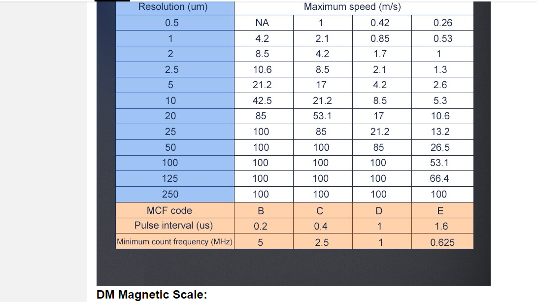

just to add some information about linear scales of the magnetic type. i just picked up 3 of these and in the process of ordering i leaned than there is a big difference between how fast the reader heads can follow the signals when you get into the 1um range of scales and readers. it turns out that even though they can work well at 1 um they can't read the signals all that fast so this limits the rapid rates of the machine. at the 5 um ranges they can do well over 2000 imp which is crazy fast for any home build. every manufacture is different so this is something that has to be looked at closely before you pick a brand of linear scale. for me i had to think about total cost since the budget keeps getting tighter and tighter
but Ditron scales are reasonable in price so that's the direction i went. seems they have a decent product and i have came across a few good reviews so i will soon fin out if that is right or not
i also ended up going with the 5 um scales since the 1 um scales would be to slow and defeat the whole idea of closing the loop and having accurate positioning.

I was planning to buy Dutton magnetic sales as well. What kind of speed would you say is achievable with the 1um scales?

the Ditron site has them listed at 4m/s but i don't think that is correct and i think it is more like 4m/m on a 1 um reader and scale. because the person i spoke with told me the 5 um will do 150m/m which i think is more in line with what i seen as far a reader head speeds from other manufactures. this was on their store on aliexpress so maybe the actual website might confirm the correct speed for sure. most of the website information is not in English and only a few aspects are readable for me at least.
this was added after i bought my set of scales but clears some concerns up. so a 1um scale would appear to do up to 2000 IPM and a 5 um scale would appear to do up to 10,000 IPM which seems pretty fast to me? so i would take this with a gain of salt and do some research
