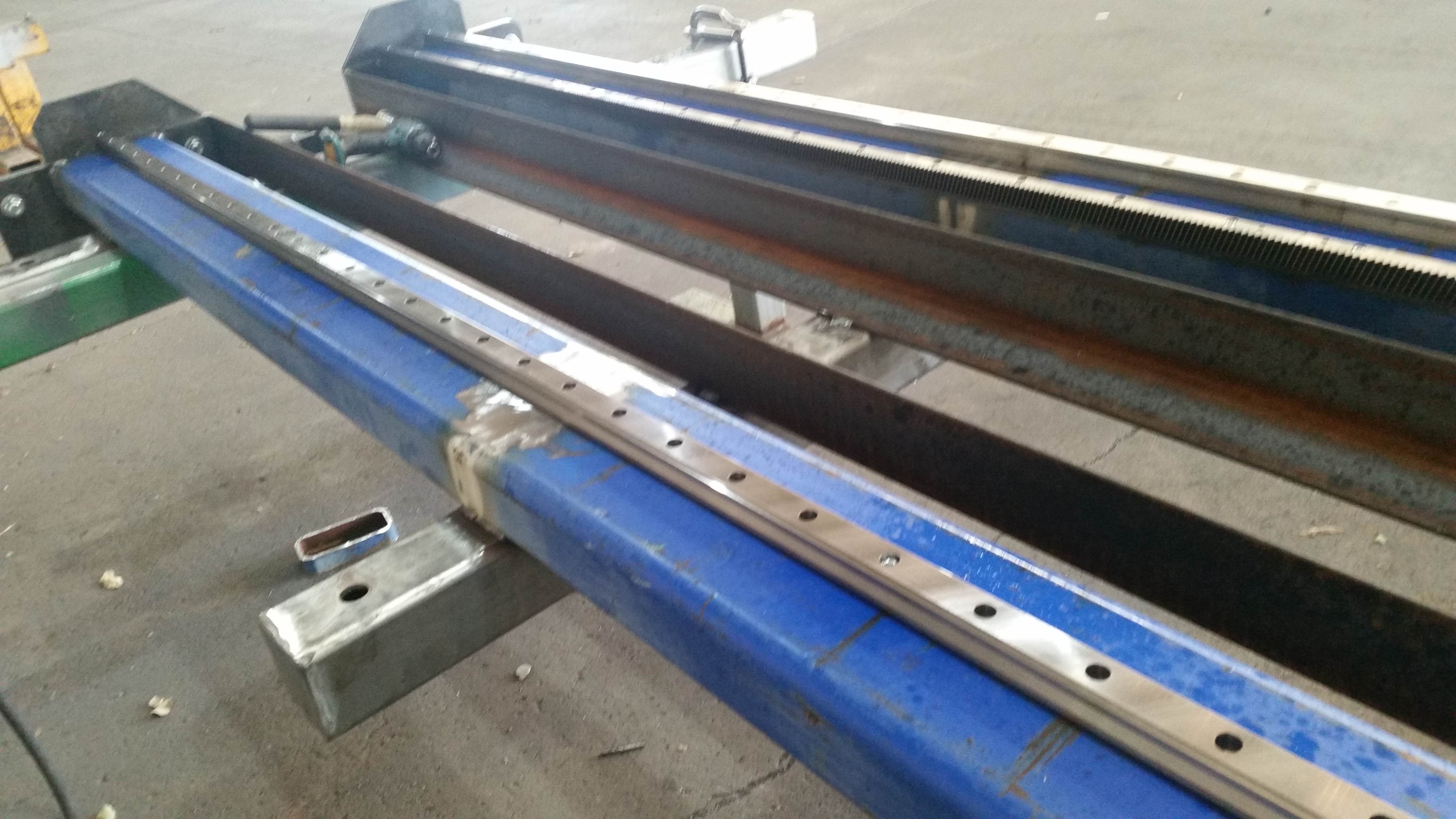

by thefabricator03
Not really. Would be handy to be able to do that for hi def machines. But if you had a milling machine capable of doing that, it would make sense to process all welded plasma machines the same way regardless of the plasma power unit.
I would be using the machine mostly for robotic linear tracks. In robotic precision is king. Although I am working on some sensors to try and lower the high precision barrier, it would be nice to be able to skim the surface of a linear guide mounting surface to get it a bit flatter.
When I built my robot linear track, where I welded I needed to straighten the main beams a little. I then had to grind a section flat near where I welded. I just ground a little then checked with a straight edge. Its pretty flat now but not 0.01 accurate.
Replied by thefabricator03 on topic Random stuff, reduction, servo motors, ideas and thoughts
BUt for non high def air plasma cutting table, Is that level of accuracy required for our blunt axe plasma machines?

Replied by rodw on topic Random stuff, reduction, servo motors, ideas and thoughts
Stefan, I think for parts like that, I'd get Laser Central in Brisbane to cut the beams and the holes on their tube laser cutter. Then everything would be in perfect position and You just need to tap the holes. I think you could put some sort of fence on a bridgeport sized machine table and slide the rails along to machine the channels. But it would be a long way down an 8' table on my little Seig SX3 mill! with 400 mm of travel. I drilled all the holes for my gantry on it like that using a piece of linear rail as a drilling guide.and it was a pain in the butt!

by machinedude
Replied by machinedude on topic Random stuff, reduction, servo motors, ideas and thoughts
it is not easy on a Bridgeport size mill either. the problem is the stock is never straight to begin with so that cause problems working on 2 foot sections at a time. story of my life the past 10 months. any kind of linear rail needs machined surfaces to get the most out of them. structural steel tube is any thing but flat especially on a long section of the stuff. so as you mount the rails to it you follow the bow and twist of the tube when it gets bolted down. then you get into a set of rails which is worse yet they need to work together so they play nice with one another. it would not be hard to for things to get sideways on you honestly.
then you get into squareness between each axis. your not going to have precision with a pistol drill and tapping the way most go about it. with plasma you can get away with it but it's not what you need to do for more precision applications.
you could use shim stock to correct some stuff but that's a pain and a lot of work fighting with stuff to get in the ballpark.
