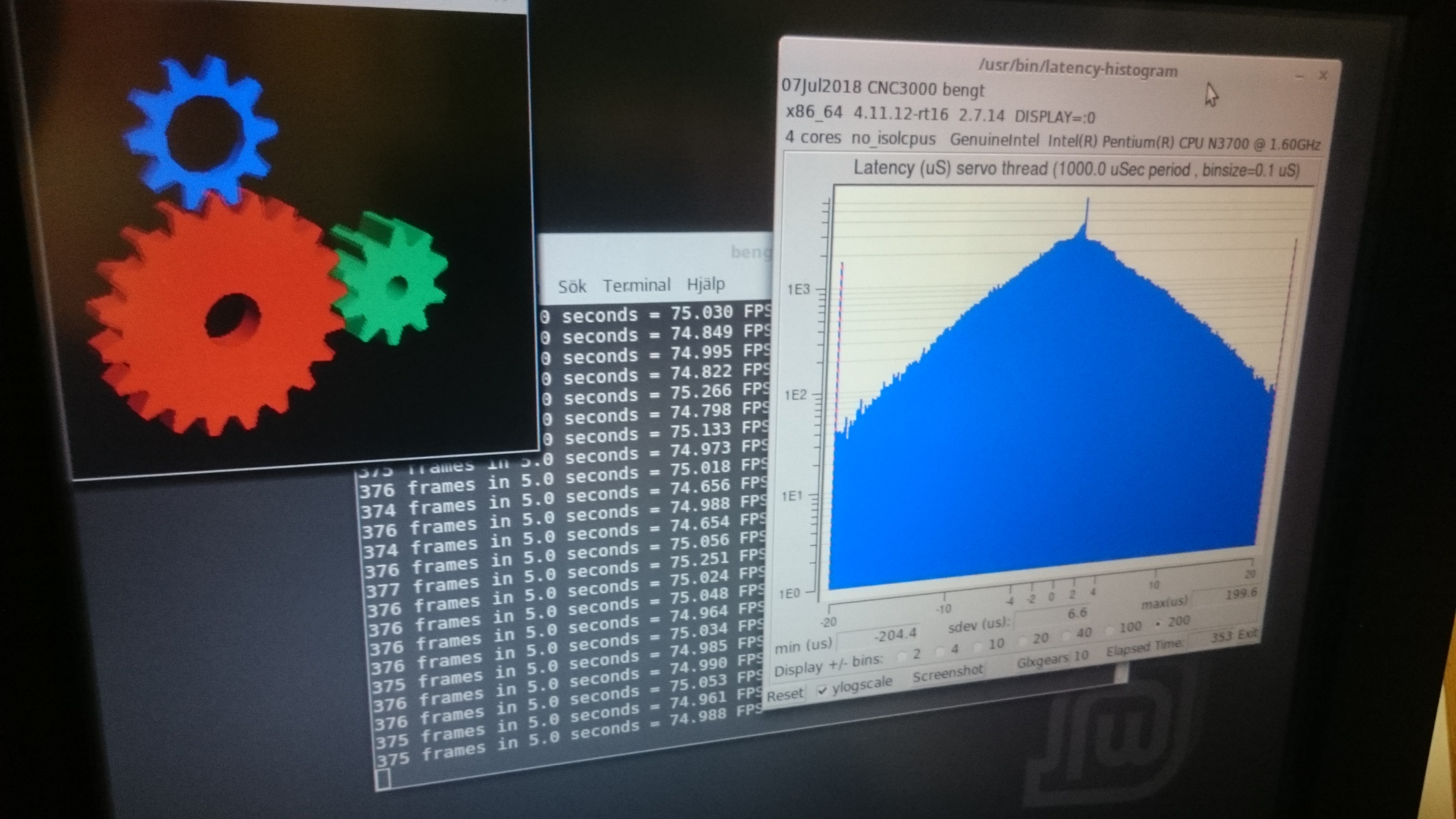

07 Jul 2018 04:34 #113652
by tecno
Replied by tecno on topic Upgraded to 2.7.13 -- W T F --
Test results are here.
LCNC has been running for almost 15 hours and no error messages, Did run testfile and all well. Closed down and restarted LCNC and run test file = no problems, did the same again and no problems.
Now to latency test and it loads and added 10 GLX Gears and is now running.
I will let this run for a while and see if I get a freeze or not.
Only thing I did yesterday was to grab a screw driver and re tighten all connections on 7i76e and PSU,
This might have been why I got those error messages from 7i76e but that should not affect the freeze in my opinion.
Later today with additional report.
