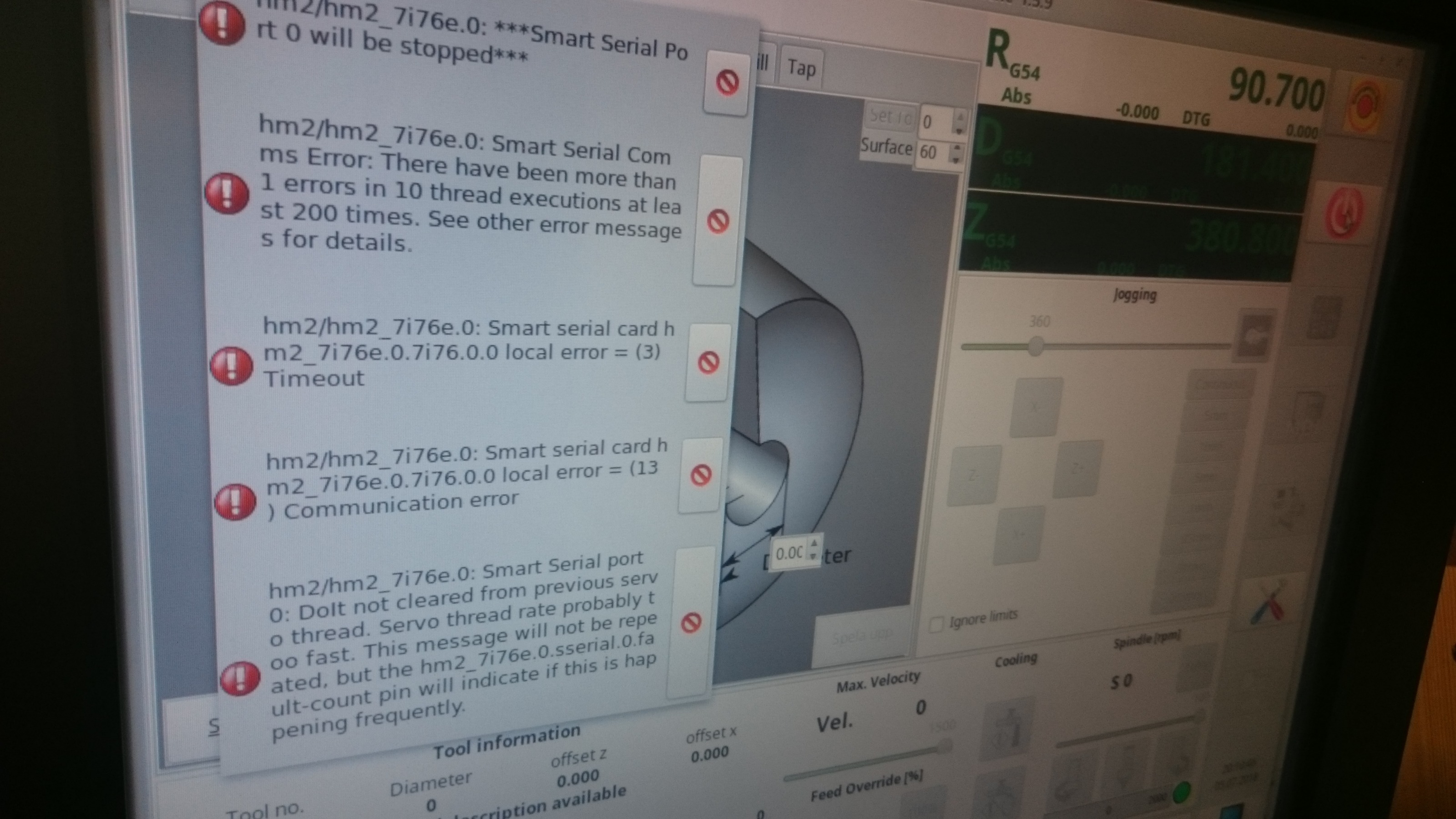

Obviously this story has not ended yet, still some errors!
I just rigged up work to be done and took a dinner brake and after about 2-2½ hours this on the monitor.
LNCN left power on but not F2 !!
Here the terminal output
I would appreciate if you guys can see something obvious that is way wrong in my setup here.

hm2/hm2_7i76e.0: Watchdog has bit! (set the .has-bit pin to False to resume)
hm2/hm2_7i76e.0: Smart Serial port 0: DoIt not cleared from previous servo thread. Servo thread rate probably too fast. This message will not be repeated, but the hm2_7i76e.0.sserial.0.fault-count pin will indicate if this is happening frequently.
hm2/hm2_7i76e.0: Smart serial card hm2_7i76e.0.7i76.0.0 local error = (13) Communication error
hm2/hm2_7i76e.0: Smart serial card hm2_7i76e.0.7i76.0.0 local error = (3) Timeout
hm2/hm2_7i76e.0: Smart Serial Comms Error: There have been more than 1 errors in 10 thread executions at least 200 times. See other error messages for details.
hm2/hm2_7i76e.0: ***Smart Serial Port 0 will be stopped***

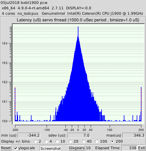

That's a latency issue
I would first make sure the all power management/speed switching is disabled in the BIOS and remove the isolcpus statement in the grub config
Isolcpus typically improves dispatch latency (what the latency test and histogram display) but very often makes Ethernet latency worse

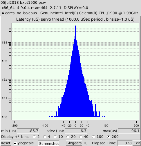

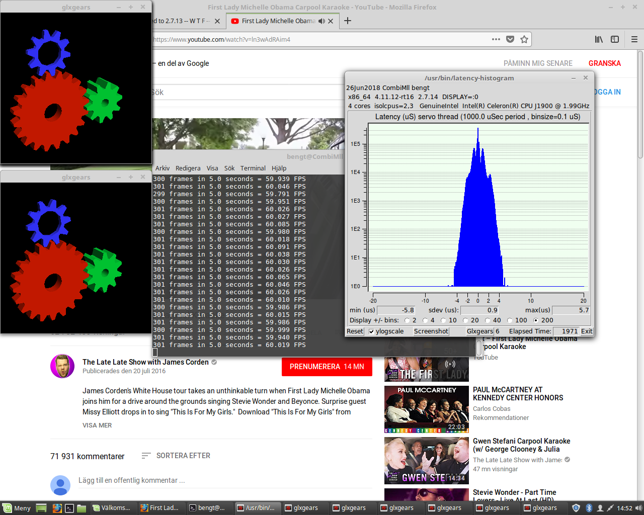

Hi Peter,
If I take isolcpus out the latency values goes really bad, have a look forum.linuxcnc.org/9-installing-linuxcnc...t-f?start=150#112879
As I recall all power management is disabled
