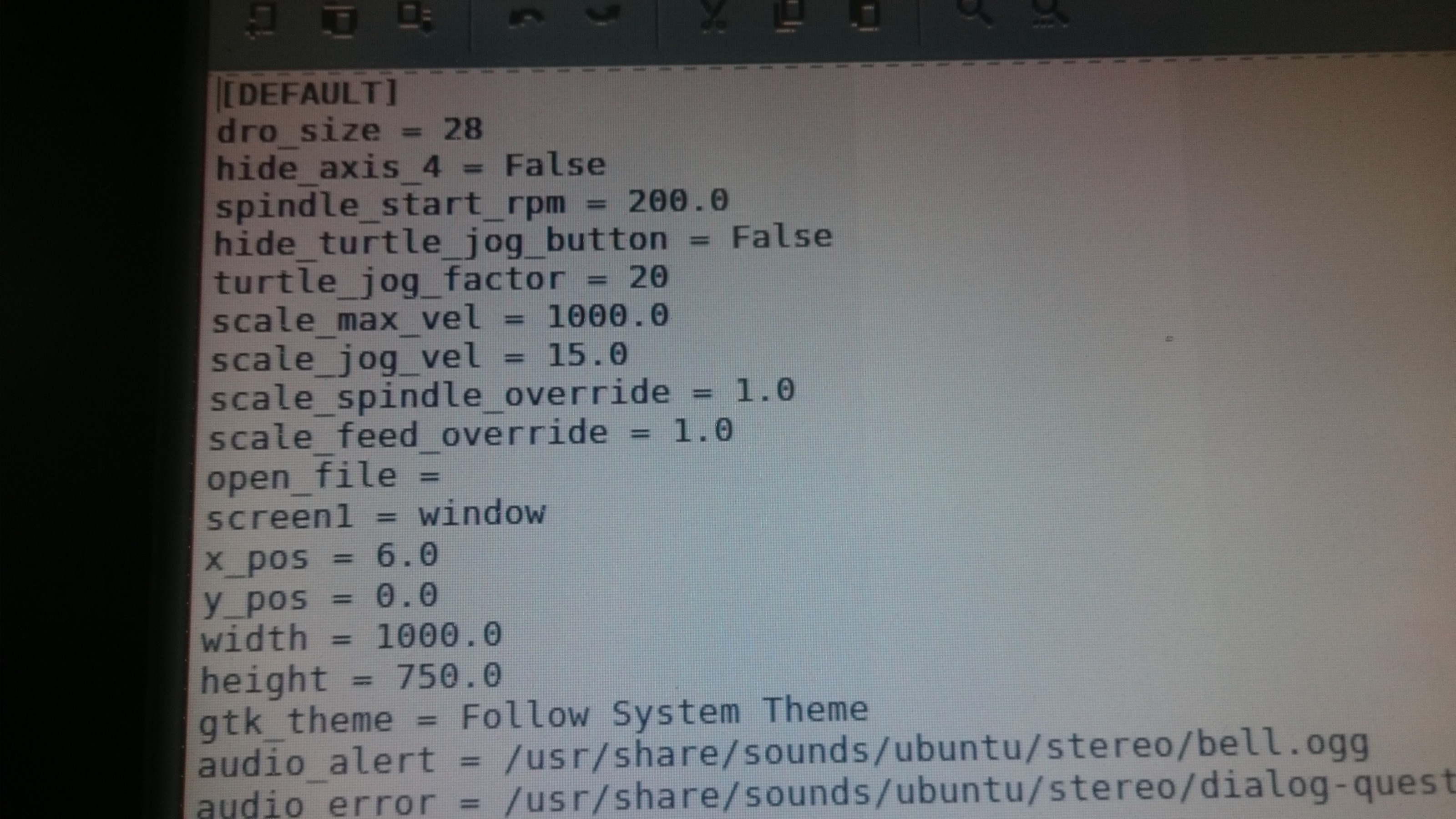

No freezing so far with LCNC running, so it seems to be OK.
Now time to setup Gmoccapy so it functions as it supposed too.
Noticed that the gmoccapy setup is somewhat fucked-up. Take a look at scale_max_velocity value!
I can assure you that this scared the shit out of me when I tested to run 'lathe-pawn.ngc'
Maybe somebody ought to have a look at this as it is straight out of the box! It should be 1 not 1000!

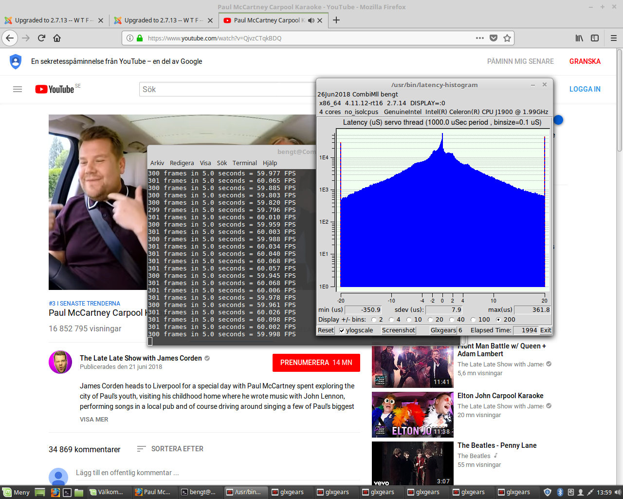

Received my Gigabyt GB-BXBT-1900 today and installed Mint 18.3
Following 2 lines Error file not found or something like that
sudo apt-get install hostmot2-firmware-all mesaflash
sudo apt install glade3_3.8.6-1_amd64.deb >>>>>>>>>>>>>>>>> solved double click on package!
Running LCNC in SIM faults like this
bengt@CombiMll ~ $ linuxcnc
LINUXCNC - 2.7.14
Machine configuration directory is '/home/bengt/linuxcnc/configs/sim.axis'
Machine configuration file is 'lathe.ini'
Starting LinuxCNC...
Found file(lib): /usr/share/linuxcnc/hallib/core_sim.hal
Note: Using POSIX realtime
Found file(lib): /usr/share/linuxcnc/hallib/axis_manualtoolchange.hal
Found file(lib): /usr/share/linuxcnc/hallib/simulated_home.hal
Found file(lib): /usr/share/linuxcnc/hallib/lathe.hal
task: main loop took 0.012027 seconds
task: main loop took 0.012469 seconds
task: main loop took 0.021057 seconds
Unexpected realtime delay on task 0
This Message will only display once per session.
Run the Latency Test and resolve before continuing.
Did a short latency test and numbers are not good running all 4 cores = a bit disappointing.
