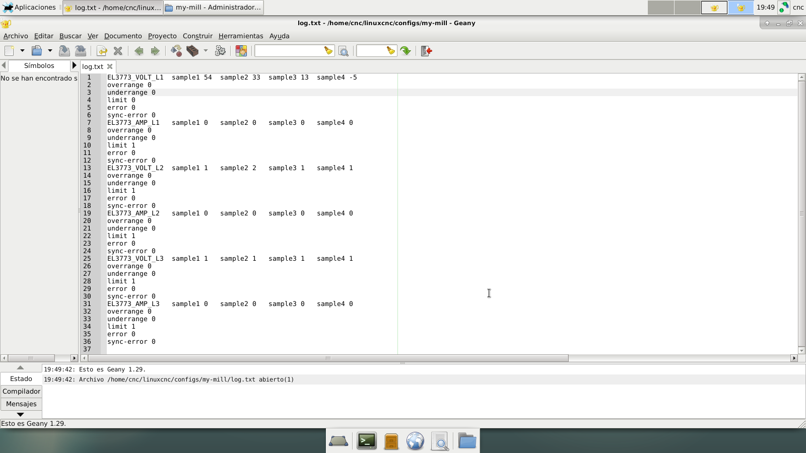

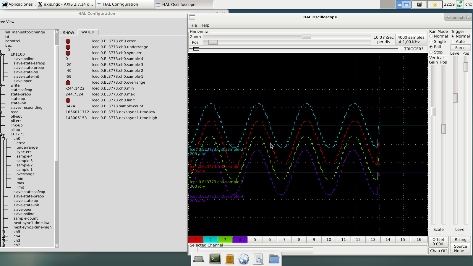

Thank you Chimeno for your excellent work,
EL3773 | Power monitoring oversampling terminal
The EtherCAT Terminal EL3773 is a power monitoring terminal for state monitoring of a 3-phase AC voltage system. For each phase voltages up to 288 Veff/410 V DC and currents up to 1 Aeff/1.5 A DC are sampled as instantaneous values with a resolution of 16 bits. The six channels are measured simultaneously based on the EtherCAT oversampling principle with a temporal resolution of up to 100 µs and passed on to the control system. The control system has sufficient computing power for true RMS or performance calculation and complex custom algorithms based on the measured voltages and currents. Through the oversampling principle the terminal is able to measure at significantly shorter intervals than the cycle time of the control system. AC and DC parameters must be connected and measured with a common reference potential. The EL3773 supports distributed clocks and can therefore measure synchronous with other EtherCAT devices.

That is interesting, especially here as the mains fluctuate a lot.

Tommy,
If you have a modern frequency transformer, you can connect this one to linuxcnc too and read out diagnostics about different value's.
We can ask the Iranic stuxnet victem's for more info.
The EL3773 makes life easyer if you need this component. Just add a few xml lines....
We have to think about backuping more Linux Ethercat component's to the Git.
If the hard disk of the forum crashes. It will be a nightmare.
