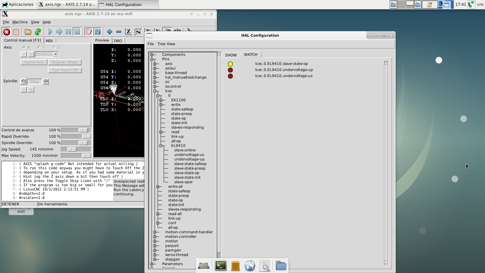

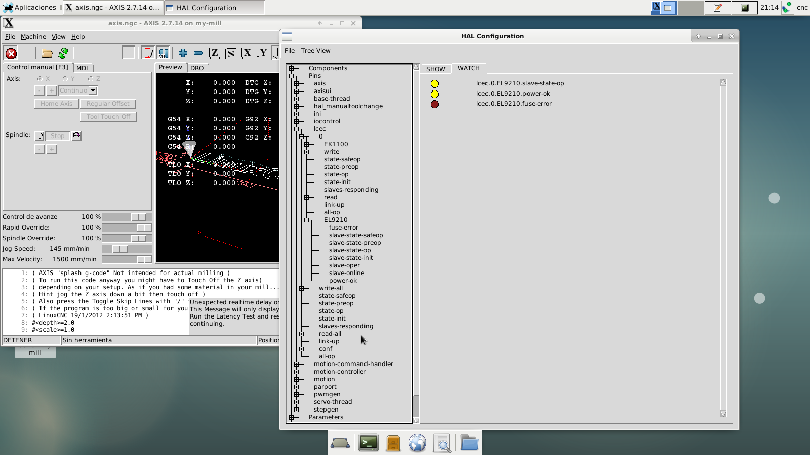

Hi guys,
added the module EL9210 to the standard configuration, greetings Chimeno

Hi guys,
added the module EL9410 to the standard configuration, greetings Chimeno

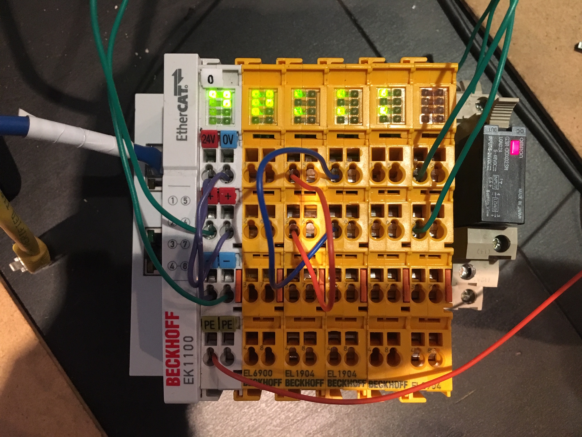

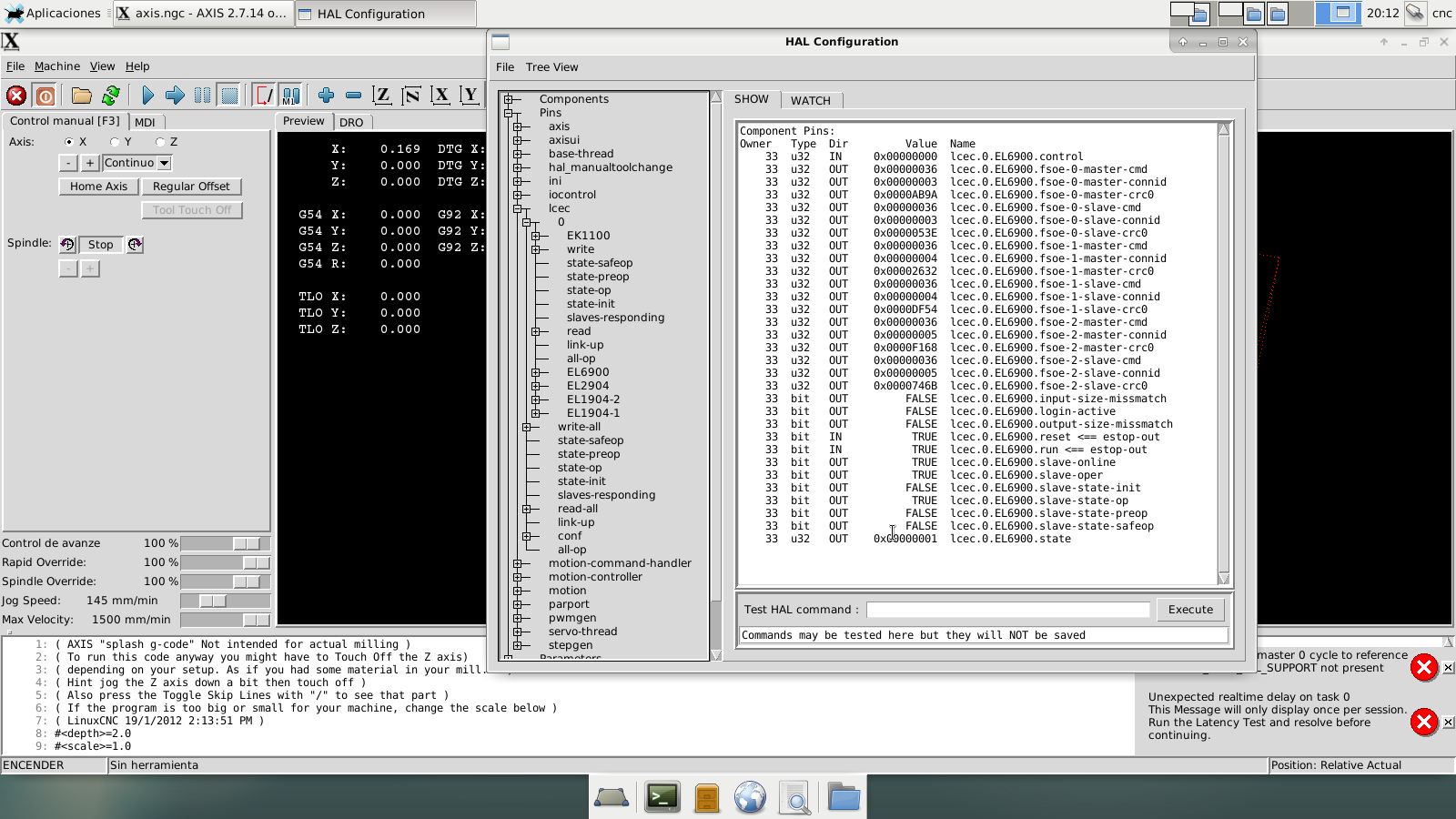

09 May 2019 18:29 #133267
by chimeno
Replied by chimeno on topic Ethercat HAL driver
hello guys, tested and operated the system safety beckhoff, EL6900, EL1904, EL2904, with the function safeStop, I have some problem in the conflict of groups but can be reset with the variable ACK, in principle works well, for more ... . Regards
Chimeno
Chimeno
