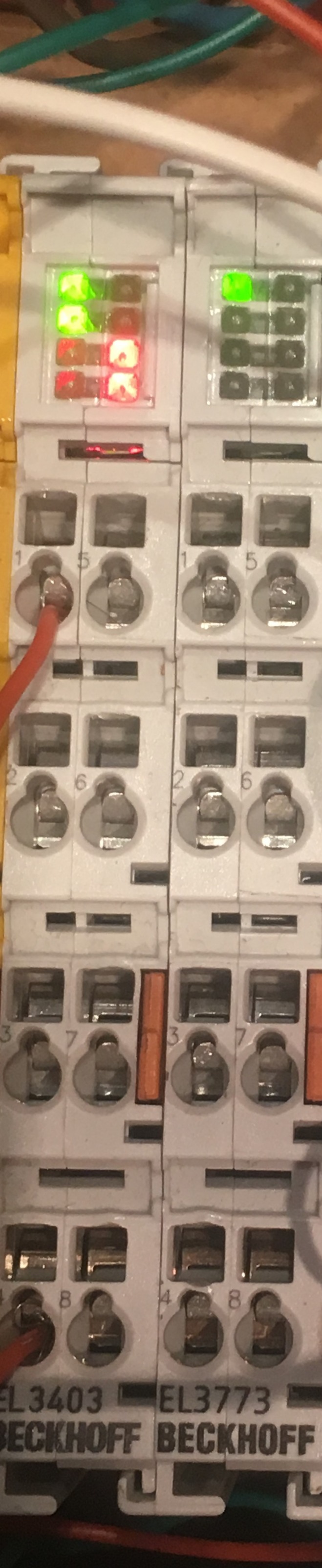

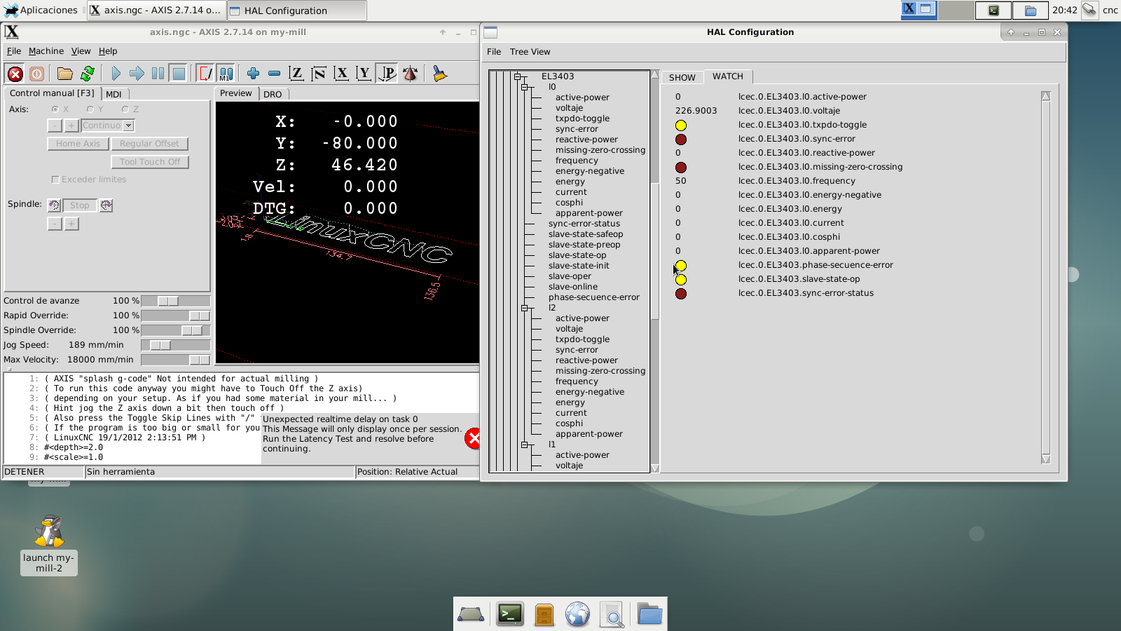

29 Jul 2019 18:53 - 29 Jul 2019 18:58 #140914
by chimeno
Replied by chimeno on topic Ethercat HAL driver
Hi guys,
I attach a new EL3403 controller.
regards
Chimeno
regards
Chimeno

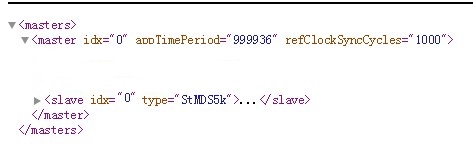

- cheng
- Posts: 57
- Thank you received: 9
28 Aug 2019 09:00 #143420
by cheng
Replied by cheng on topic Ethercat HAL driver
- marcin2458
- Posts: 10
28 Aug 2019 10:35 #143436
by marcin2458
Replied by marcin2458 on topic Ethercat HAL driver
I tried it, but it doesn't work.
- cheng
- Posts: 57
29 Aug 2019 02:10 #143517
by cheng
Please execute "dmesg" after the error.
You need to determine if the servo drive you are using now, MDS5015, can use the stmds5k driver, and if not, you need to use the "generic" driver.
It is recommended that you search the forum for similar questions. I've seen similar questions before.
