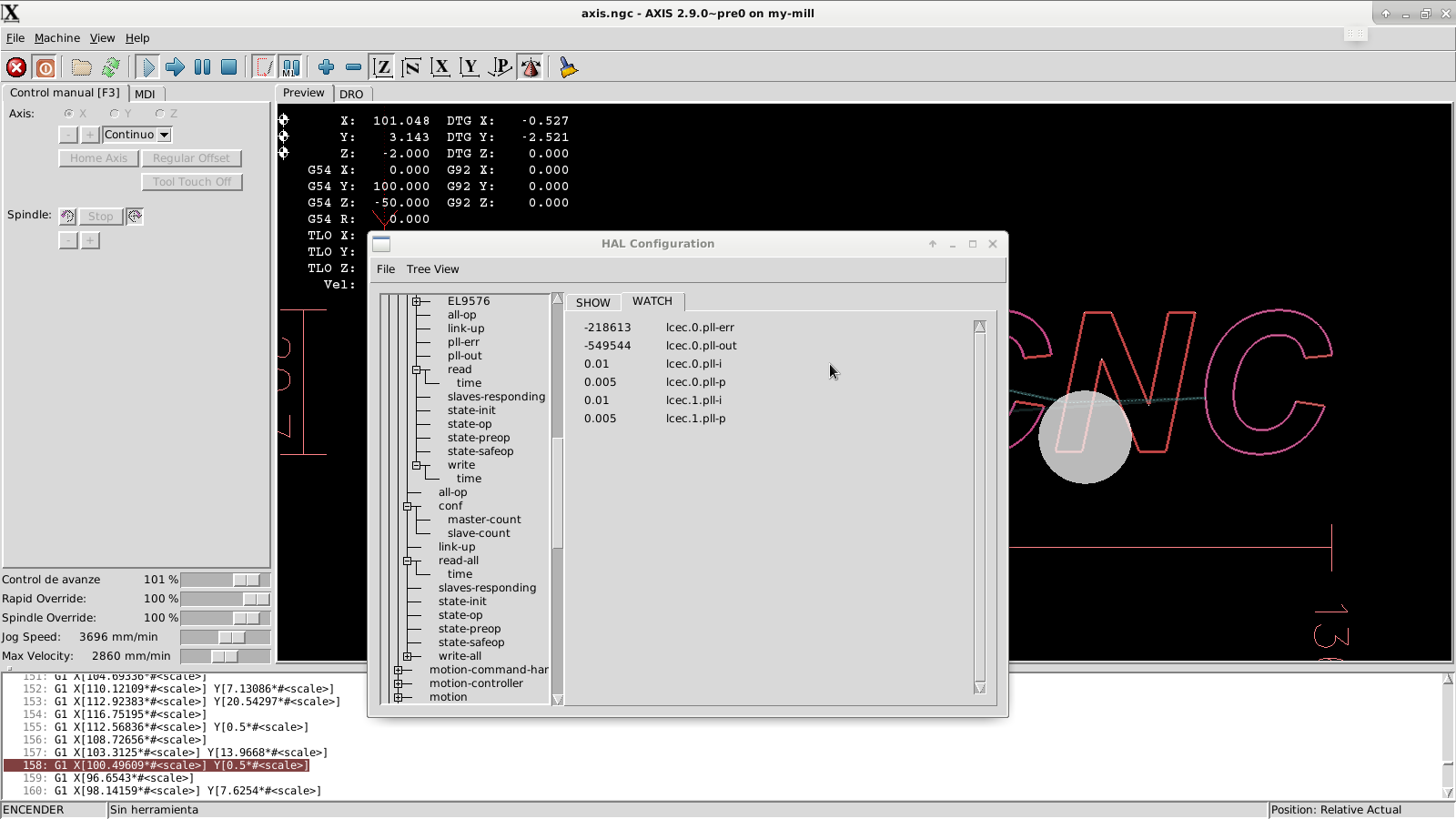

Hello guys,
I have a question, I'm trying to install the linuxcnc-ethercat patch in version 2.8 or 2.9 but it doesn't work, only version 2.7 works for me, if anyone can help me.
I attach the patch file.
Thank you
Chimeno
In the end it works in version 2.9, we go with the first synchronism tests, there are quite a few changes since version 2.7, I will have to update.
Thank you
Chimeno
Last edit: 18 Oct 2019 19:02 by chimeno. Reason: attach screenshot
