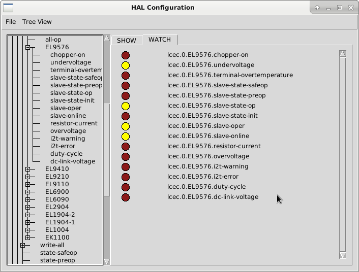

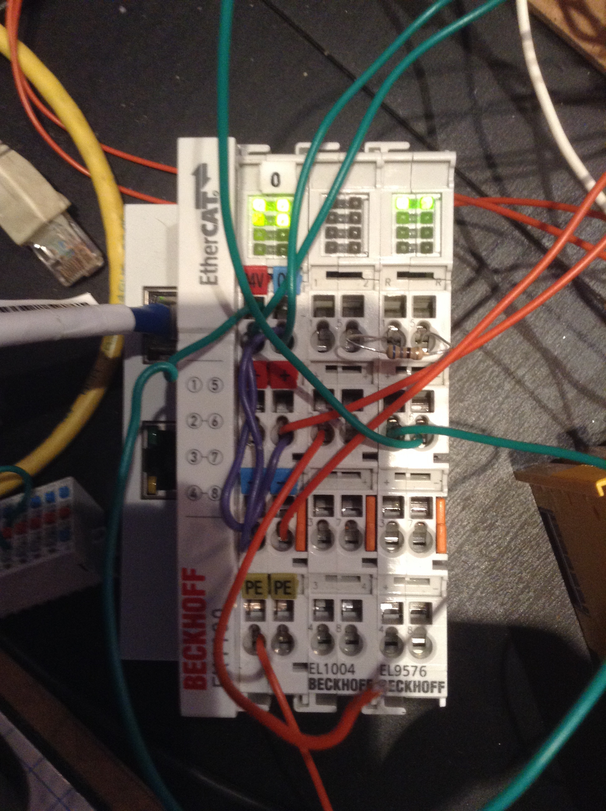

Hello guys,
I have attached a new EL9576 controller, for you players!
regards
Chimeno
