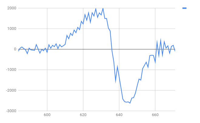

The attached chart shows what happens to torch voltage when crossing a kerf (data from a hal plot at 200 Mhz sample time:
So if we use a moving average, we can compare the change in voltage over this time period with the average over the last 100 readings and if it differs significantly, we hold THC behaviour. In practice however, I think a single servo period is too short to be doing the comparison with as normal hysteresis around the torch voltage set point might be enough to trigger the component from one period to the next.
Hmm 200 Mhz.. This diagram looks to fast to make a conclusion for me. I can't figur out what the scaling value's are, sorry.
If i can see a chart of a periode of time T versus volts V, i can imagine how the arc is responding.

Sorry, I was not clear. The graph is not of arc voltage. It shows the change in voltage per second (dV/dT) so the full scale is 2000 volts per second. THe X axis is just a count of 200 Mhz Steps.
And there is no need to buy a data logger. You can use the Halsampler and sample components and log data to a file every servo thread cycle for further analysis in a spreadsheet. I captured 16000 readings of torch voltage using this method.
So I want to recapture the dV/dT data using Halsampler.
An alternative to a seperate thread is to skip a number of servo thread cycles. This is easy to do using a counter and modulo division something like

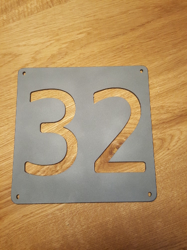

Today cutted a sample for my wife with the new C code. After tuning a few gui parameters, it cut's better then Mach3 windows.
But it's a long way to the top. At the picture my nozzle was damaged, so i am not satisfied about the holes.

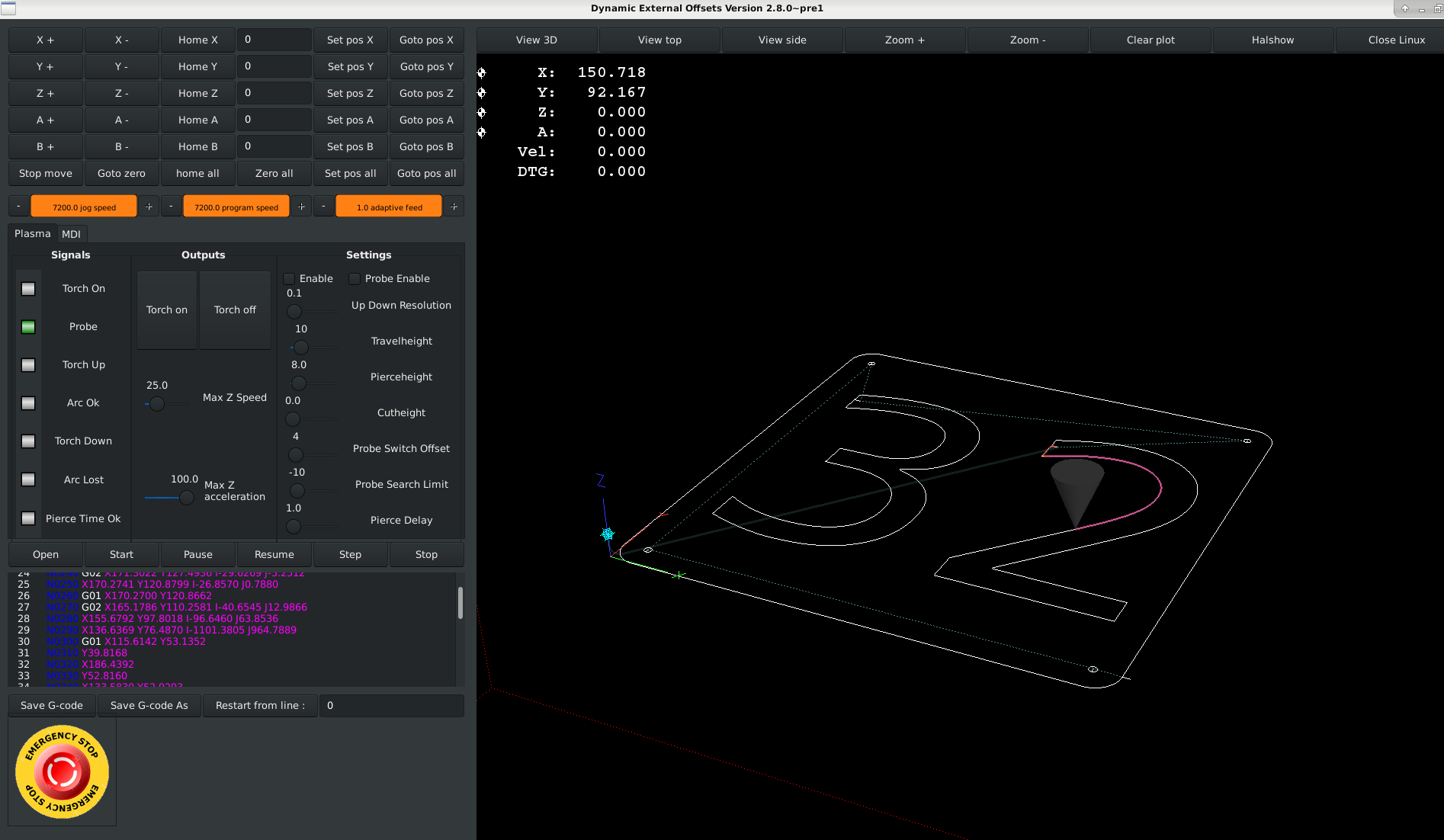

My investegation is import a dxf right into the gremlin screen as g-code with inkscape only loaded as blockchain.
