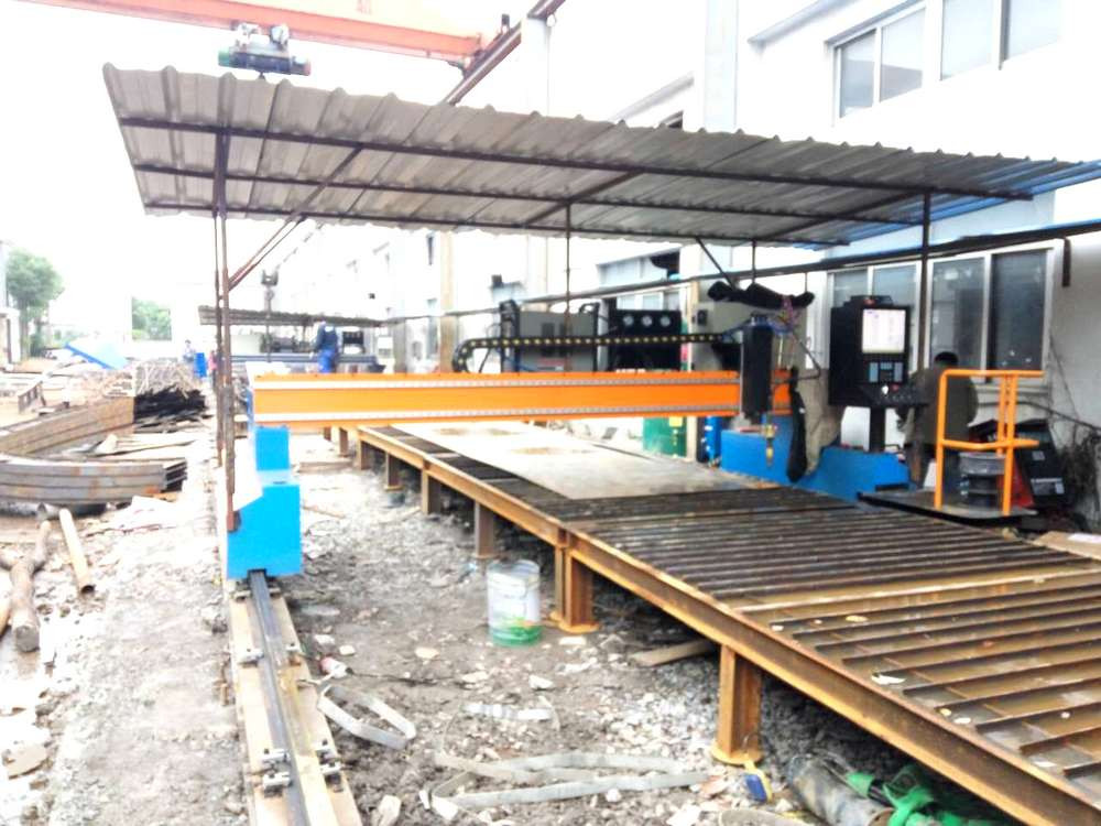

Info on the small machine.
As a guideline,
- 1x1 meter or thereabouts is a nice starting point for a usable machine.
- using HiWin or THK linear rails, 15 or 20 mm ones is a nice compromise between cost and functionality and a very long life, they do not get blocked from dust as they have vipers
- unsupported round rails are also usable from 20mm and up, they do sag a bit under load but that is not important if using a THC
- supported round rails will end up costing nearly the same as the above mentioned linear ones as there must be 4 rails, 2 for each axis and 2 carriages per rail.
- a single carriage per rail is more than enough for a plasma, so the total cost for 3 meters of rail and 3 carriages can be from 250 to 300 Euro ( usually there are 2 carriages for one rail at that price )
- GT2 belts 6mm wide are more than enough for this size and weight, cost for 5 meters with 5 pulleys (16 or 20 tooth) is 5 to 10 Euro
- stepper motors, Nema 17 or Nema 23 work fine, as long as the nema 17 are at least 40mm high, or 1.2A. Some Nema 17 from older photocopy machines have GT2 14 teeth pulleys, 2 of them can move a 20KG gantry easily up to 12 meters/minute without ever loosing position. Using Micro stepping drives is essential for direct drive, info bellow at the motor section. Cost anything from 40 to 100 Euro for all 4 of them.
- Z axis and floating head, drawer slides with ball bearings ( 2 of them or one dual slide ), M6 or M8 all thread with a coupling to the motor, nema 17 are always enough, even 0.8A ones. A single limit switch for probing, more if limits and homing are to be used. Cost around 20 Euro.
- A simple welded or bolted steel structure is all good for the machine, same goes for the table. Welding a water table is not an easy task so ask for help or leave it to a professional. It works without the water table, but the dust created during cutting is very fine heavy metal dust and breathing it is not healthy at all. Cost anything from 50 to 200 Euro.
- THC preferably Mesa THCAD, more complicated to install and set up, much quicker and more control for making finer cuts. Proma THC 150 is easier to set up and use, it works perfectly with Linuxcnc, it is a bi slower, Generates it's own ARCOK signal so no need to fiddle with the plasma power for that. Cost 100 to 200 Euro.
Estimated total cost from 400 to under 1000 Euro for a fully functional, fully automatic machine that will last a long time happily cutting all day every day. Add to this the cost of the plasma power source and a decent compressor.

Info on the big machine. 6x2 meters.
Just to be clear, this is not something that can be done as a hobby or home made, this requires a lot of tools and experience, costs a lot, so it is not to be taken lightly, especially not to be started as a project and later giving up on it.
The end result should be a fully functional machine that can be used 24 hours a day every day, and that implies using heavy duty parts, reliable electronics, a lot of safety features especially if using servo motors and drives. Also a lot of compromises are inevitable for cost/functionality/reliability to get to an acceptable point.
- This has to be a long machine as making a sturdy 6 meter gantry is not an easy task.
- Rails, 20mm are enough but i would prefer 25mm for the long axis, 15mm or 20mm for the short one. The only problem is there are no 6 meter lengths of those types of rail, only 4 meters, so the minimum for a 6 meter rail is 35mm for THK and HiWin, so this is where the supported round rails come in as they can end up cheaper but much harder to find at that length. cost would depend on the size and would range from 1500 to 2500 Euro.
- Motors, again for the X and Y axis nema 23 can be used but the 2 N/M variety for the long axis with reduction, nema 23 works perfectly for the short axis, nema 34 are also nice with reduction for the long axis. Cost is anything from 150 to 500 Euro for steppers, at least 1200 to 2000 for servo motors with included drives.
- Belts, again GT2 9mm or 10mm wide is enough for the 2m axis, preferably 15mm, at least 25mm wide for the long axis, preferably 40mm wide. Cost anything from 150 to 300, pulleys included.
- Rack and pinion is much better for the long axis with reduction, This would require 14 meters of rack for both axis and 3 pinions. Cost 250 to 400 Euro
- Z axis and floating head, drawer slides with ball bearings can also be used here but i would prefer something much sturdier, M8 all thread with a coupling to the motor, nema 17 is enough for the slides, nema 23 for anything bigger and stronger, A limit switch for probing and 2 for limit/home. I would suggest using two floating heads in case you get 2 plasma cutters later on or use 1 for plasma and 1 oxyacetylene torch, the latter would not need a floating head just a normal Z axis. Separate configs can be made for plasma and for oxyacetylene cutting so it would switch between heads as needed. Cost 50 to 400 Euro.
- A welded steel structure is all good for the machine, a bolted one will not be easy to make. Same goes for the table. Welding a 6x2 meter water table is not an easy task so professional help would be required. It works without the water table, but the dust created during cutting is very fine heavy metal dust and breathing it is not healthy at all. Cost anything from 450 to 1500 Euro.
- THC preferably Mesa THCAD, more complicated to install and set up, much quicker and more control for making finer cuts. Proma THC 150 is easier to set up and use, it works perfectly with Linuxcnc, it is a bi slower, Generates it's own ARCOK signal so no need to fiddle with the plasma power source for that. If anyone has a better idea please do share. Cost 100 to 200 Euro.
Estimated total cost from 2500 to under 5000 Euro for a fully functional, fully automatic plasma and oxyacetylene machine that will last a long time happily cutting all day every day even 100mm thick plates depending on the oxyacetylene torch. Add to this the cost of the plasma power source and a decent air compressor and the acetylene torch with the required hoses and oxyacetylene bottles.
