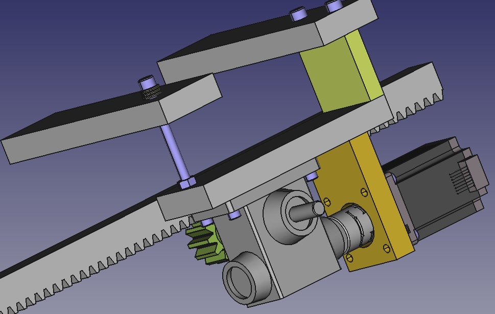

you can go with cheep ballscrew as of 12m/min up to 1m table 80cm cat area
then considder Rack pinion with 1:5 gear cheep and good for 8m/min cuts
the Timingbelt woudt be a AT5 the best to use no flex on 10m Width 750KG of tention
my 4 plasams and the 5th are on Rack pinion with 30:1 wormgear at 3Nm 72V
running 20m/min at 0,1mm/step
this is the setup tighten with a spring to the rack
it runs for a full shift with no steploss at 8m/min cut G64 P0.3
Double shielded ROBOT Cable 4x 0,75mm² in e-chain length 12meter at 72V 4,2A M880 7i76
Last edit: 25 Apr 2019 09:01 by pl7i92. Reason: image

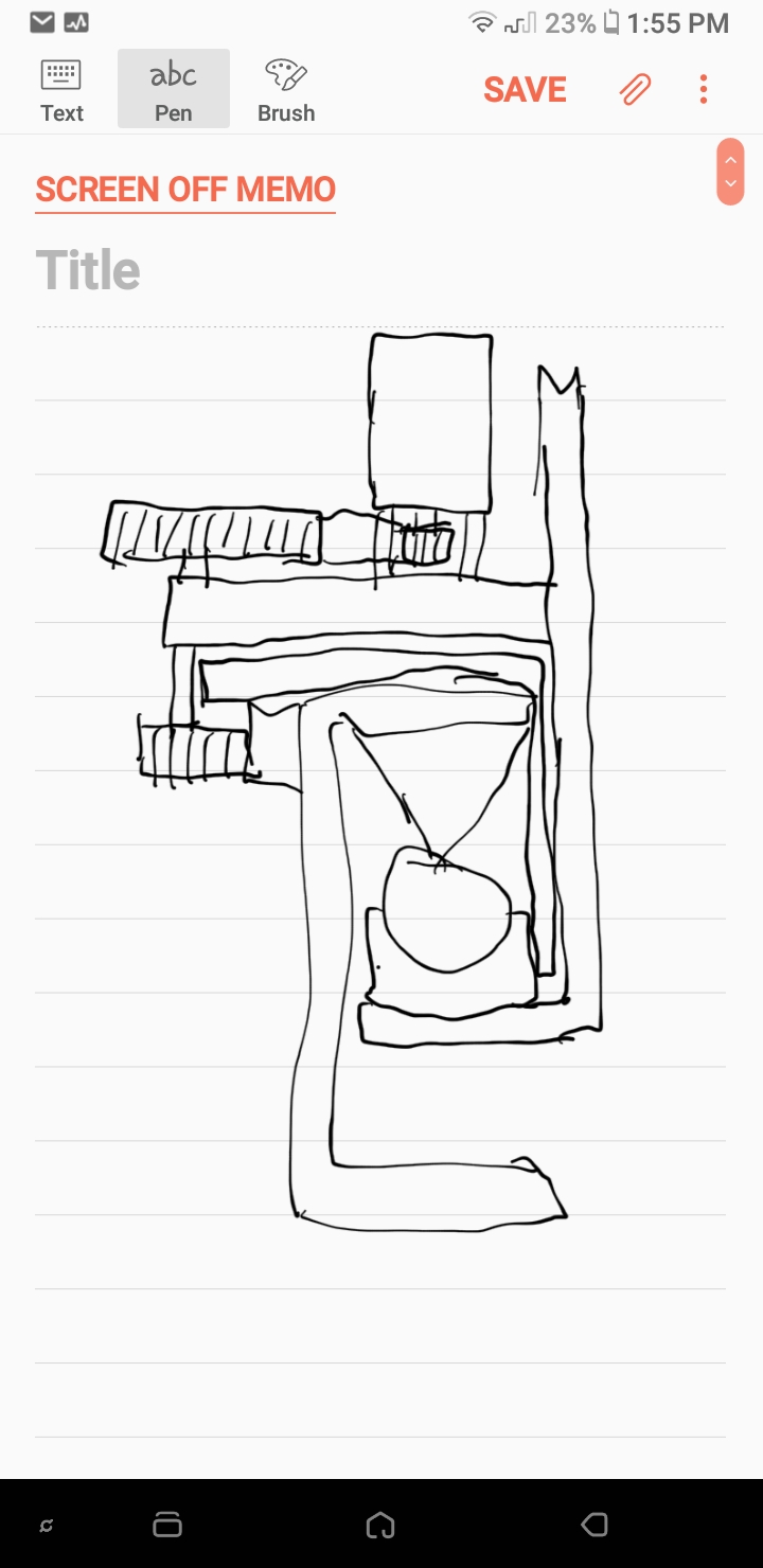

Been long enough !
Sorry for the delay but the friend that was providing parts for me from Germany is back in Kosovo so i am having difficulties sourcing parts, but at least now i order a lot more so i gathered a nice pile of Mesa boards, Lam Technologies and other types of drives, lots of power supplies, and finaly yesterday got a delivery of 6 meter long round supported rails at 16, 20 and 30mm with respective carriages. Took 2 months to have them here! Next shipment will be here a week after i order, so that is one less problem.
Now i have to do some calculations and some drawings to first check how much i can squeeze with what i already got then order a lot of metal profiles ( IF i can manage to gather some money as i am almost broke!
I have :
Linear round supported rails:
16mm 6 meters plus 12 carriages with holders and 16 without holders.
20mm 6 meters plus 12 carriages with holders.
30mm 15 meters plus 15 carriages with holders.
Linear rails square
Hiwin HGR25
1 piece 118cm long
1 piece 78cm long
1 piece ~55cm long
1 single carriage.
I need to build:
1 small machine at 2X1 meter cut area.
1 medium machine at 3X2 or 3X1.5 meters cut area.
1 big machine at 6X2 meters cut area.
The big machine will use the above mentioned 30mm supported rails for the Y axis, meaning having to cut the 3 meter piece and but join it to the 6 meter ones to get 7.5 meters of rails on both sides, planing on making the gantry very wide at 60 to 100cm, so that will end up with 6.5 to 6.9 meters of cut area.
Now comes the tricky part, i would like to use the HiWin for the X axis, but, but joining square linear rails in a "hand tools" work shop is a no go, so any ideas are very welcomed. This would leave the 20mm and 16mm ones for the other 2 machines to play with, but no matter how i look at it, i will need some more rails. Luckily i have a local source for unsupported round rails ( local hydraulic equipment service ) and a local bearings shop that has a stock of carriages for round rails and rack and pinion module 2 just for me !
Since this is a joint venture, can someone please do a drawing or a render or a scrible of how a plasma machine should look like as a finished product. Not the standard ones. It has to look as a piece of art, not a square box. Even some nice decals will do, if it contains the words: Linuxcnc and Mesa, and maybe, just maybe a company name ( i do own localy " Kosova Hardware" and " PC Kosova ", the first is usable but to long ).
As i have access to a lot of local busineses, printing on anything, plastic sheets, and some other stuff is easy, good paint job is very hard so i have to use car repair shops that costs a lot, but i have to go that route.
More to come.

27 Aug 2019 06:57 #143317
Replied by tommylight on topic CNC Plasma cutters, DIY, building info and guide
No ideas ? Drawings ? Scribles ? Nothing ???
Oh well, been thinking about how to mount the rails so that they are covered completely to protect from fine dust and debree while working around the table, came up with an idea and have some chicken scratches i made on the phone ( the Galaxy Note pen is such a nice thing ), so i will try to upload that now.
Not much to look at buy a rough idea.
Regards,
Tom
