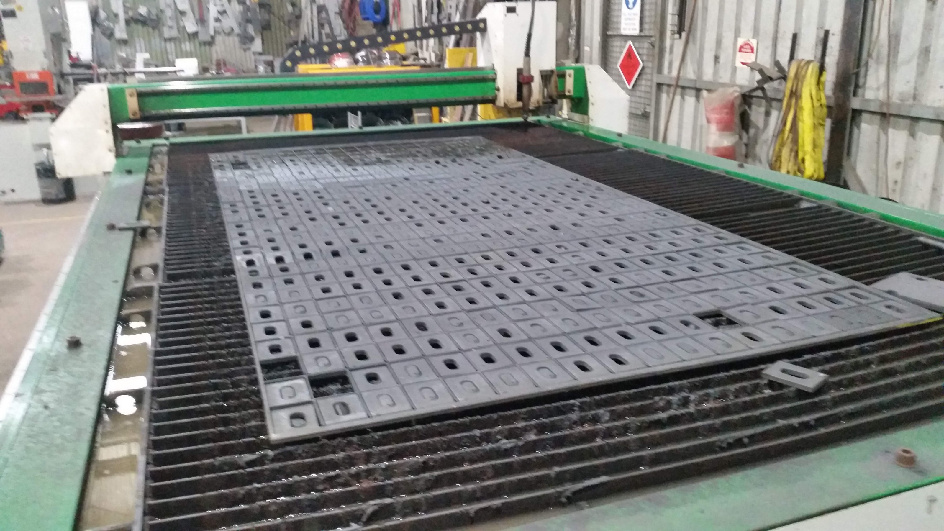

02 Jan 2020 05:09 #153785 by thefabricator03
Replied by thefabricator03 on topic CNC Plasma cutters, DIY, building info and guide
How difficult is it to cut <4mm with floating head and vice versa, >4mm with ohmic?
It can be a big pain the the ass.
I have done a bit recently with 1.6mm black hot rolled sheet and if the material is warped the torch will come down for a touch off - push the sheet down until the limit switch trips - moves up to pierce height then lowers to cut height but the material will push back up and cut height will be lower than the top of material. Then the torch drags and destroys the part.
Only way around this is to baby sit the machine and keep the material flat by pushing it down with a length of rod or RHS until the cut has started and the THC will take care of the warped sections and maintain the correct arc length.

02 Jan 2020 23:15 #153864 by thefabricator03
Its not bad at all,
The problem I have been having with the ohmic sensor is false readings triggering a stop.
I cut all sorts of parts and one of them has a large slot in the center, When the air from the torch blows water from the center of the slot into the torch is causes a fault reading and stops the machine.
I have not had time yet to play with RodW's new hypersensing design but it should have some ability to tune the reading voltage to overcome some of the false readings.
03 Jan 2020 01:50 #153868 by rodw
I'm not sure if it will! I never had any probe errors until I added a water table. Sometimes I get a false trigger via a short on a water splash much higher than the material. But what I've found is that Plasmac recovers so perfectly I don't stress about it. I just hit resume and keep going. Pulsing the torch to get post flow going before the first pierce helps I think. And also pulsing the torch is helpful clearing water out of the torch before resuming. I also now park the torch in the middle of the table at the end of a sheetcam job so water does not go everywhere.
I actually tried cutting some 4mm at 40 amps for the first time last week. The first part was a failure as it was not cutting right through so I reduced the torch volts by 3 volts and nudged the amps up a little bit on the fly and by the time I was ready for the next cut, It was pretty much perfect. So I just need to reduce the cut height by 0.3 mm and see if the on the fly changes can be translated to final settings. The next cut was perfect and the dross just knocked off pretty easily.
