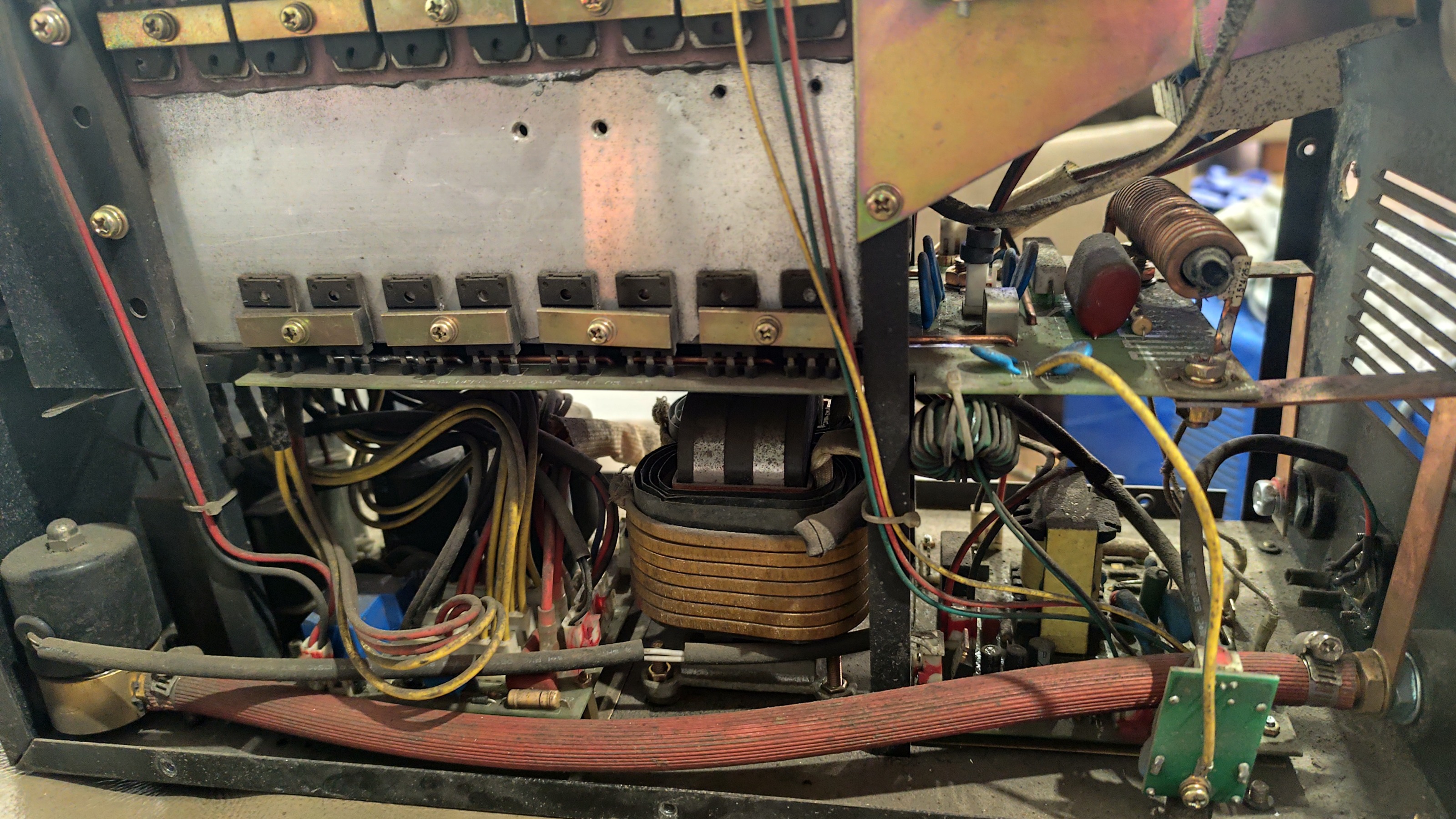

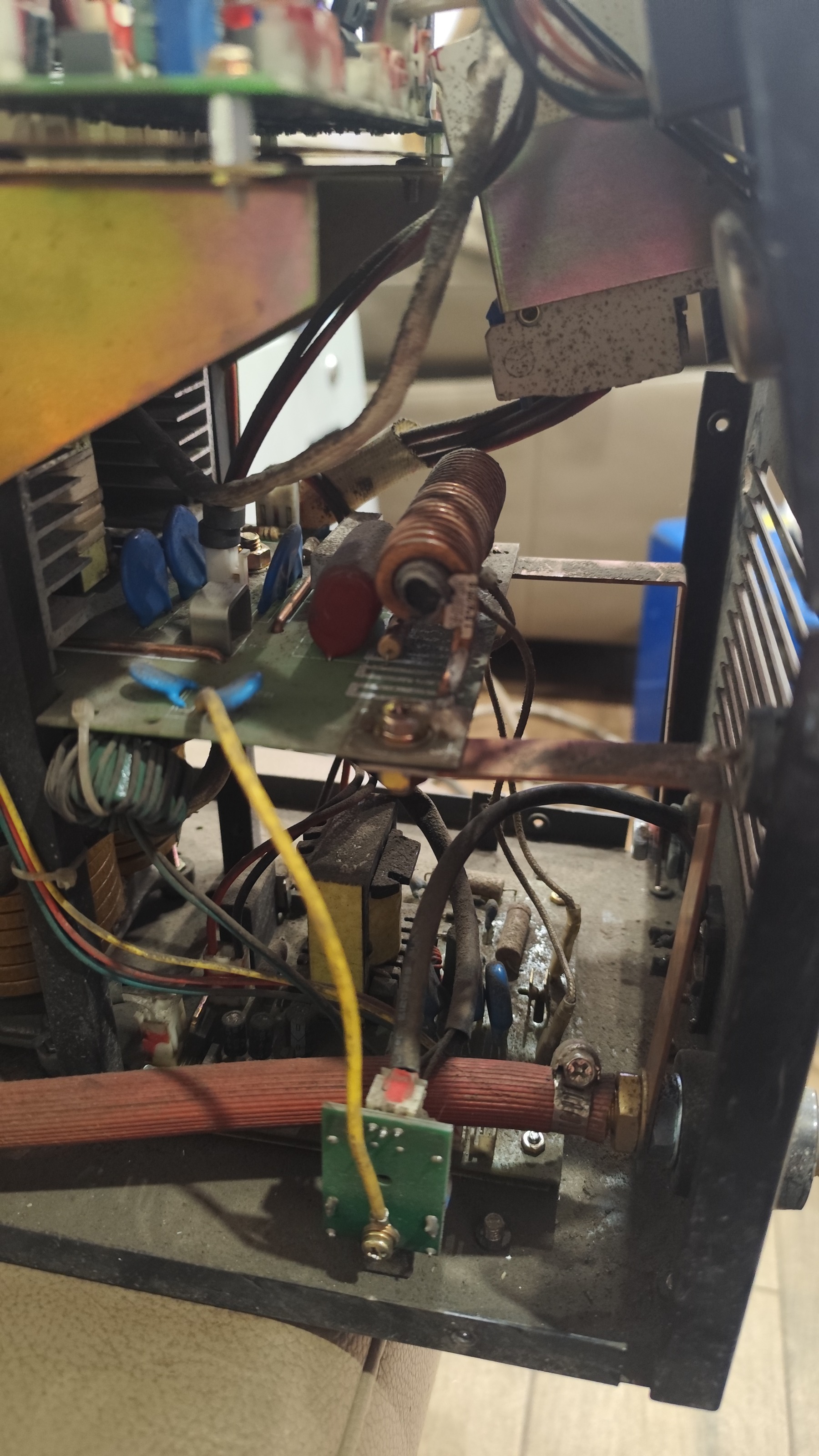

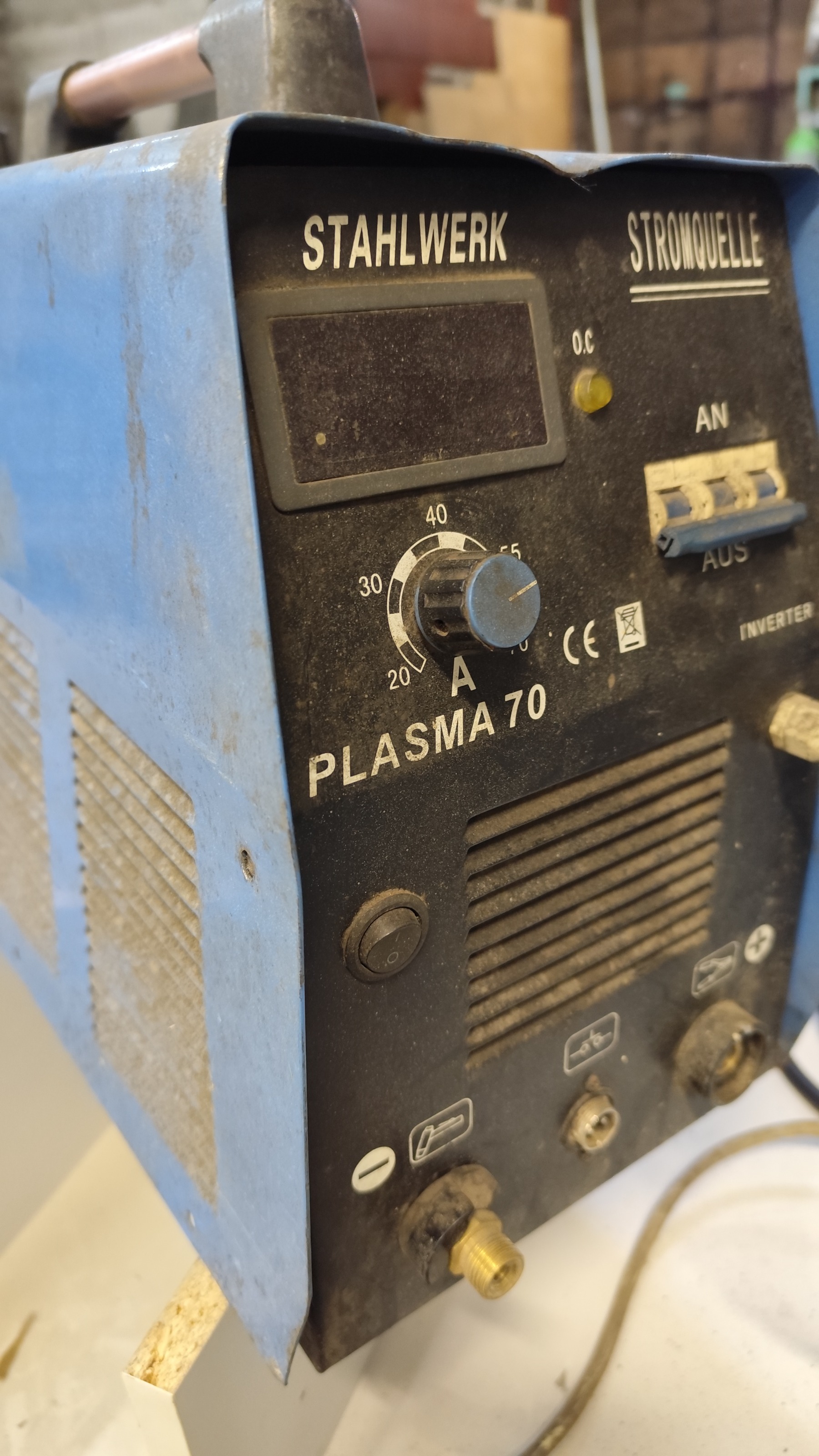

hi guys I bought a MESA 7I96+THCAD300 for my CNC plasma machine project a couple of years ago. So I don't really remember how and why I chose THCAD300, although I have plasma machines Stahlwerk CUT 70, as far as I know, with ARC pilot type ignition. And if I understand correctly I need THCAD 10? Is there any way to modify or adapt the THCAD300 I have to my needs? Should I buy a new one? If new, what kind?

02 Feb 2025 08:06 #320414
Replied by tommylight on topic CNC Plasma cutters, DIY, building info and guide
Does not look like pilot start, there is a missing connection for a usually red thinner wire.
More pictures?

02 Feb 2025 11:10 #320429
by Badutis
Replied by Badutis on topic CNC Plasma cutters, DIY, building info and guide
thanks tommylight for your quick reply. Well, I'm not sure about that in Arc Pilot, that's why I wrote likely. I relied on the information I was able to find on the Internet. However, I have no doubt that you are right and cutter is not an Arc Pilot. Does it change anything? I think I saw somewhere that you have implemented projects with HF plasma and THCAD300. Could you tell me where exactly those wires should be connected? anyway, if it is necessary to make this cutter work with CNC, I also have PROMA THC 150,

02 Feb 2025 15:00 #320450
As far as i can tell, there is no pilot arc there, at least not the conventional ones.
Do a test and fire the torch in mid air, does it spark? Meaning without touching material or clamp.
If not, it is a scratch start so requires dragging the torch on the material to start, and if this is the case, not suitable for CNC use.
There might still be an option but it would require programing a component and testing on an actual machine. The component would have to intervene after the torch went down and found the material then do a short wiggle/circle while going up to pierce height, and also the firing of the torch should be done when the material is detected, so before the usual start at pierce height.

04 Feb 2025 05:02 #320592
by Badutis
i did the test. Does not work in the air.
How do I understand the best option to buy a new plasma cutter for CNC machines with Pilot Arc?
I saw that Stahlwerk CUT 70 with Arc Pilot is not expensive on amazon.de. costs about €450. I saw there was a discussion about this plasma cutter before. is it worth buying it or are there any proven and more profitable cutters?
