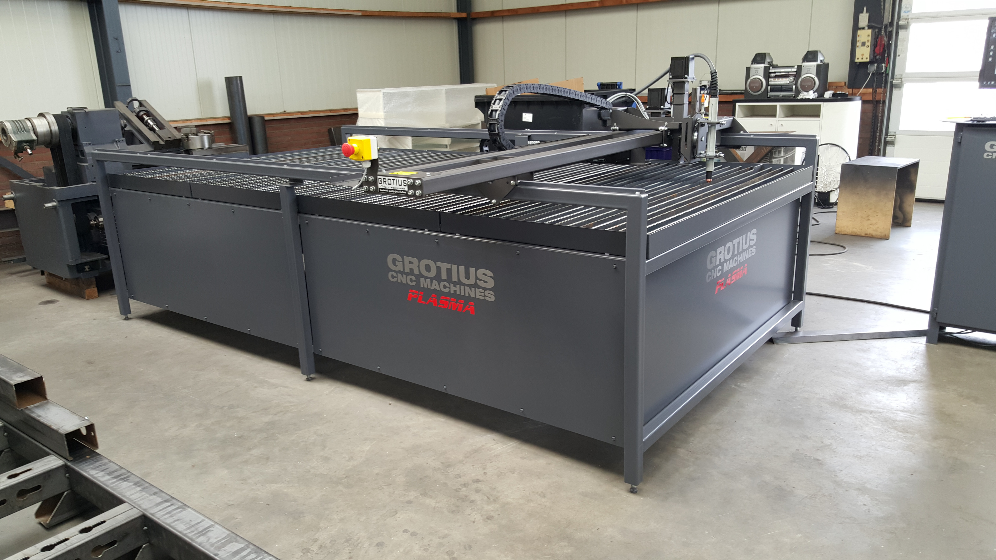

20 Mar 2019 21:14 - 20 Mar 2019 21:15 #129114
by Grotius
Replied by Grotius on topic CNC Plasma cutters, DIY, building info and guide
About the general idea....
If you think simple. And after a few years you think about the fastest protocol ever...
You can be in the position to post a random picture. This machine is running on a parport. And today
the machine is still running.
So a general idea can be quite simple. It's just how you combine things in life.
If you want to end like Elon Musk. I don't say you are crazy.... bro....
Last edit: 20 Mar 2019 21:15 by Grotius.
